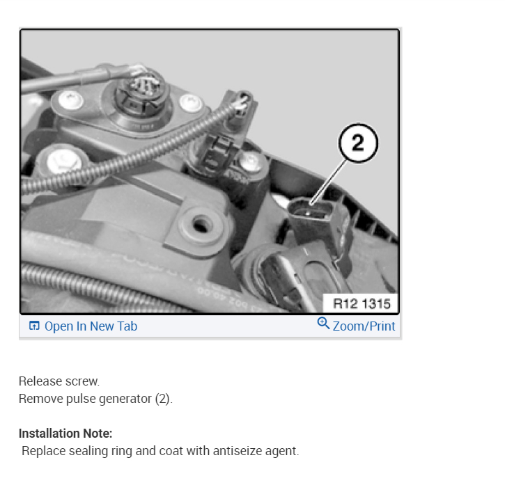

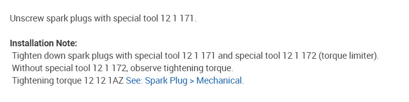

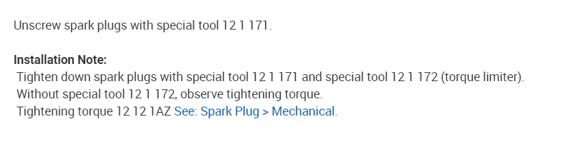

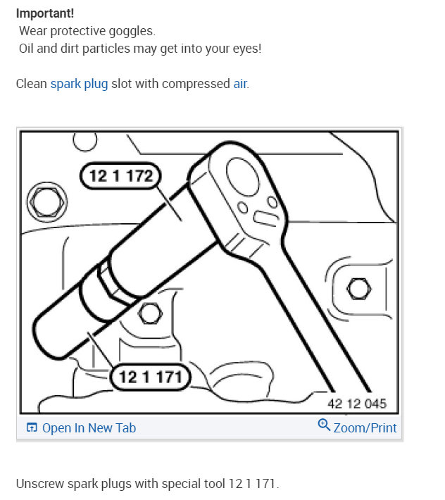

The P0367 code is an incorrect reading from camshaft sensor “B” located in engine bank 1 that is too low, which means the sensor can be out or the actuator is not working. First make sure the engine oil is clean and full, next remove the spark plugs and replace them with new ones, OEM only. The other codes are random and specific misfire codes, which should be cleared once the sensor and plugs are replaced. Sensor B is the exhaust sensor on the passenger side of the engine.
Here is a generic guide to help you with the spark plug replacement and instructions for your car in the images below.
https://www.2carpros.com/articles/how-to-change-spark-plugs
Check out the images (below). Please let us know what you find. We are interested to see what it is.

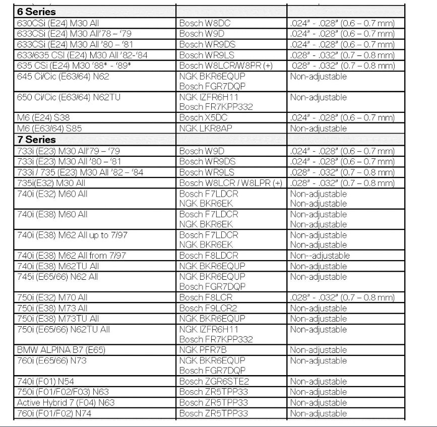

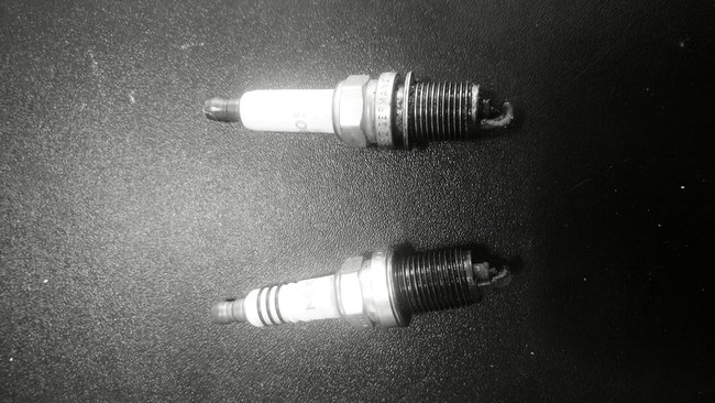

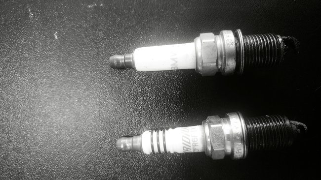

I pulled the plugs and I'm trying to find out what is the OEM plug that I need to get. 7 of the plugs were Bosch and one was NGK. It wouldn't surprise me if these were the original plugs as they were nasty as hell. (Pictures attached). I'd like your confirmation, but I think the OEM is the Bosch ones as they also say BMW on the plug as you'll see in the photos.
Can you tell me exactly what plugs I need to get?
Thank you so much.

Bosch FR7KPP332???
