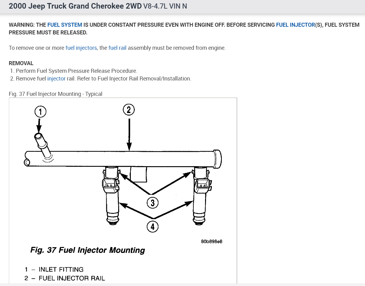

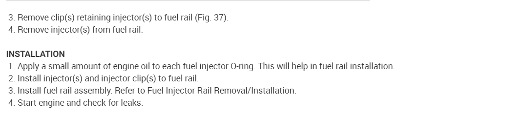

Here is how you can remove the injectors on your car in the images below.
