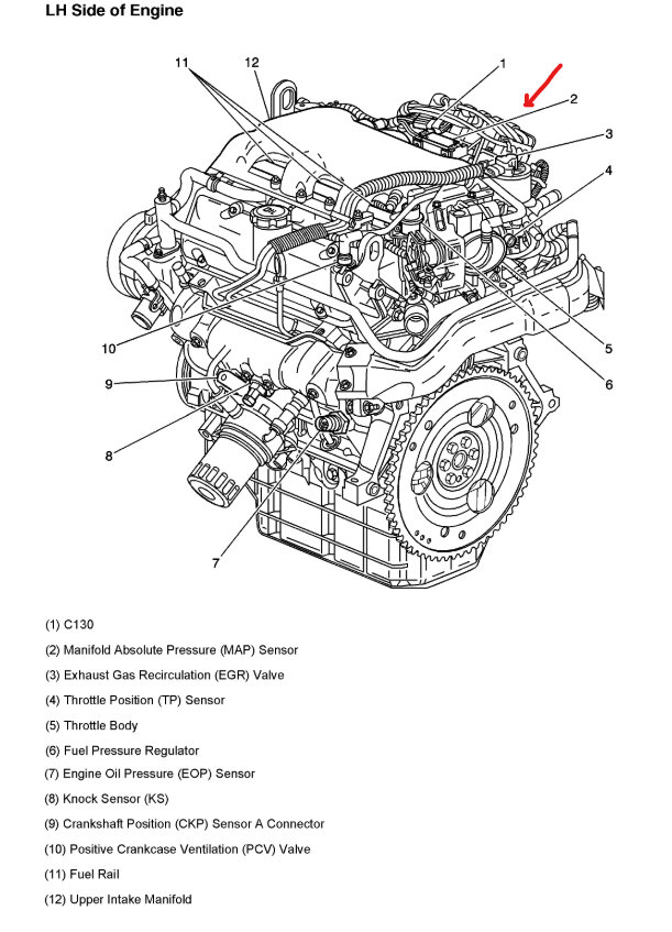

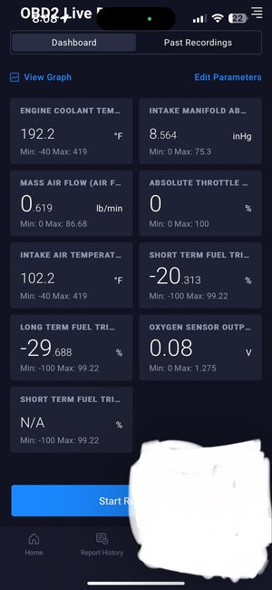

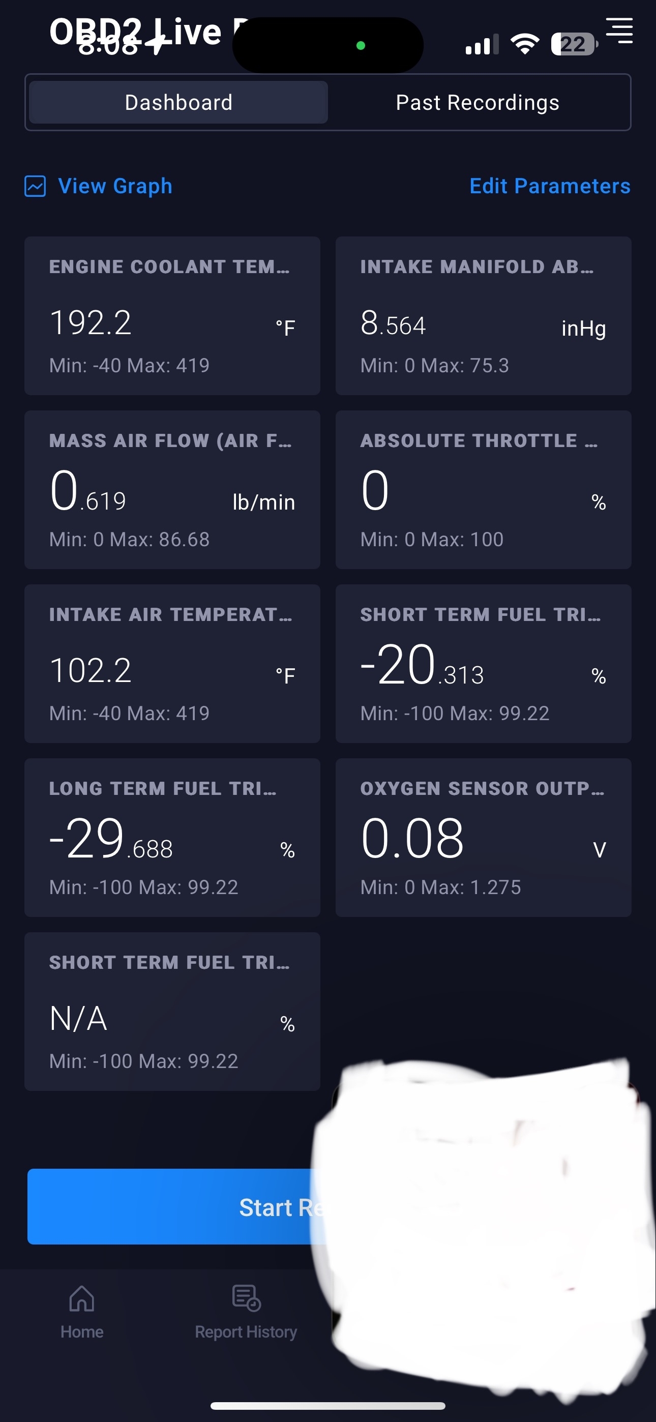

This car is running super rich on both fuel trims. I have a screenshot of how everything is reading. We have replaced fuel injectors, the regulator, fuel pump, spark plugs and just about everything you can think of and it’s still running rich and smells bad from the exhaust. I either feel like it’s a PCM fault or a faulty sensor. Is there anything y’all would suggest looking at? The MAP is reading low as well.
