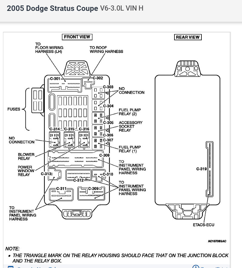

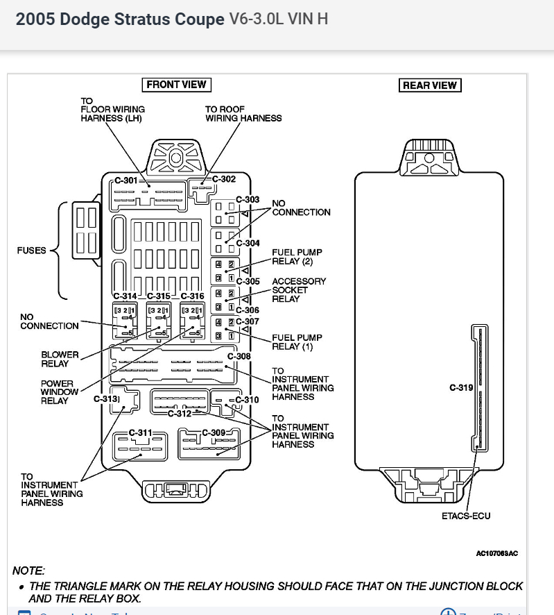

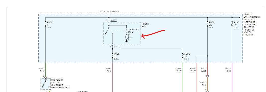

I am buying a 2005 dodge stratus sxt and the current owners said that when they turn off the car, the running lights will stay on, which kills the battery, so they have to un hook the battery once they turn their car off. They cant figure out why it is doing that, and how to fix it.
