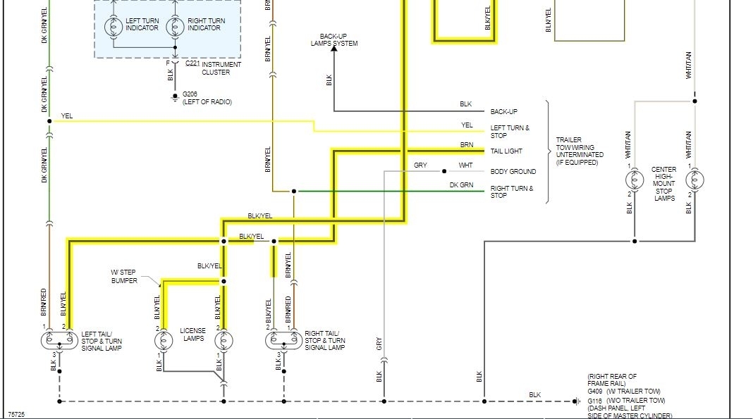

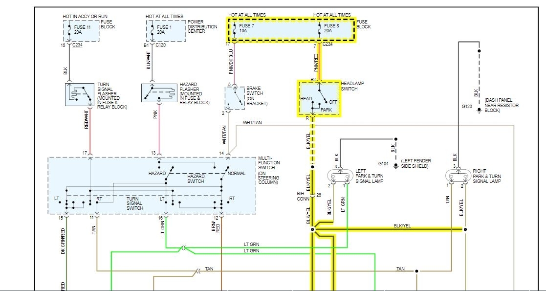

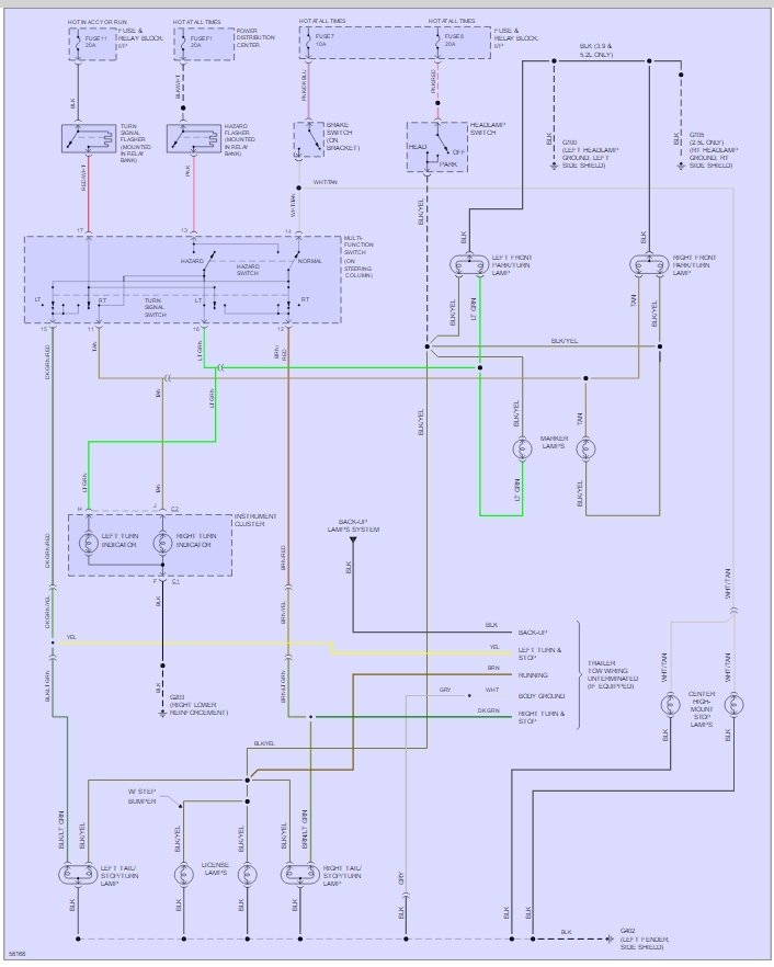

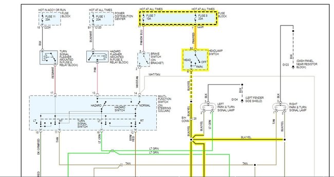

We can't figure out how to get the running lights to work on it the head lights work the blinkers and the brake lights work, but the front and back running lights don't. we have replaced the fuses and bulbs can't figure it out. please help
