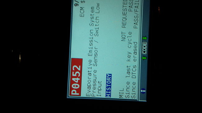

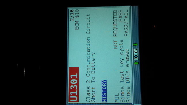

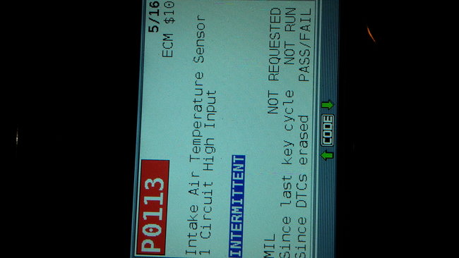

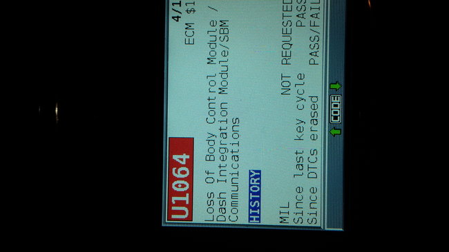

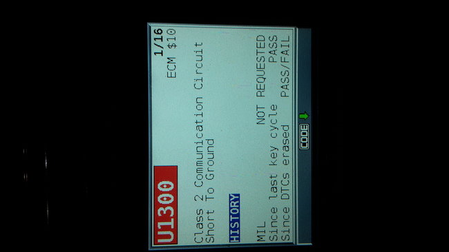

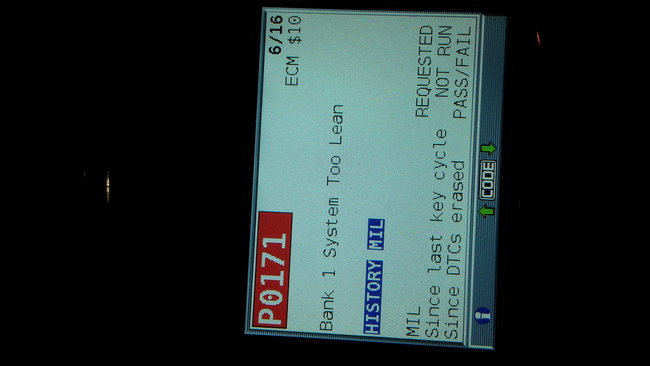

Now showing number four misfire, O2 code and a class 2 ground (will include picture) when before it was only showing low fuel on acceleration code.

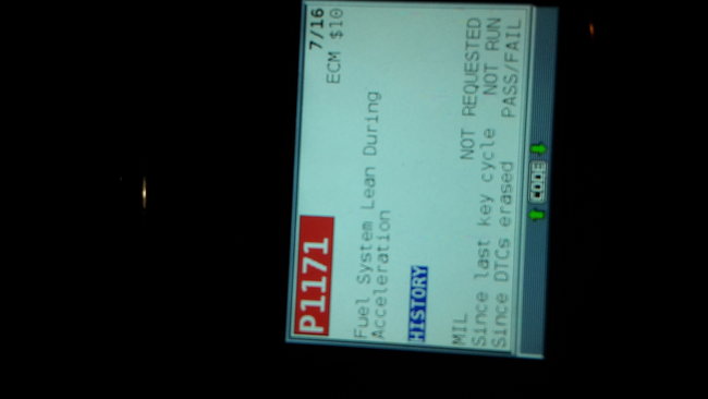

The P1171 code was showing already as well as a fuel sensor code for the fuel level which is why the gas needle does not work!

From all the issues you have listed and the information you have given, it all points toward low fuel pressure.
I would start by checking the actual fuel pressure. You can rent one at a parts store for this test. Low or very little pressure will cause this, not the filter.
