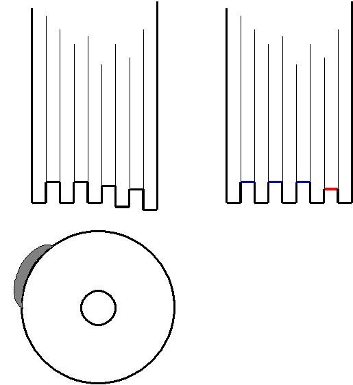

Another elusive cause of a vibration at specific speeds is a broken belt in a tire, but not in the way we normally find them. Every mechanic has run into tires with tumors growing out of the tread, or tread that squirms left and right as you spin the tire. Those are easy to spot by eye. The more elusive broken belt develops so slowly that as the high spot builds, it wears down so you don't see it. In my sad drawing below, the common broken belt is on the left. The one I'm talking about is on the right. As you spin the tire, the tread that contacts the road surface remains smooth and steady but look at the lower right where I put the little red line. The inner groove moves up and down as you spin the tire. Most mechanics who aren't alignment specialists don't know to look for that type of broken belt. This used to be extremely common on Uniroyal tires that came on GM vehicles as original equipment. If you're questioning whether what you find here is causing the vibration, switch the left front and rear tires, then drive the car to see if the sensation has changed. If it hasn't, switch the two right tires front to back and try again.
This isn't an alignment problem either. Besides the choppy wear pattern I described, which affects both tires, look for an off-center steering wheel, and whether the car goes straight when you let go of the steering wheel, or if it drifts to one side. Don't expect any car to go a half mile like that, but you should be able to let go of the steering wheel for a good five seconds before you go into the ditch or oncoming traffic.
