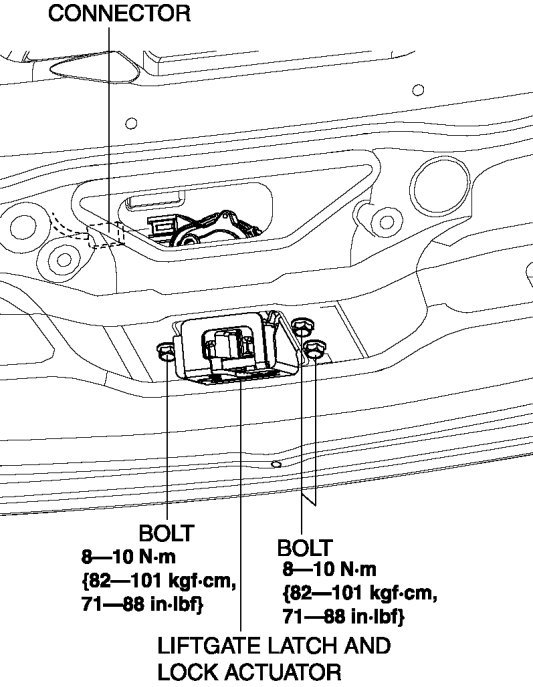

1. Disconnect the negative battery cable.
2. Remove the following parts:
a. Liftgate upper trim See: Trunk / Liftgate Moulding / Trim > Removal and Replacement > Liftgate Upper Trim Removal/Installation
b. Liftgate side trim See: Trunk / Liftgate Moulding / Trim > Removal and Replacement > Liftgate Side Trim Removal/Installation
c. Liftgate recess See: Trunk / Liftgate Moulding / Trim > Removal and Replacement > Liftgate Recess Removal/Installation
d. Liftgate lower trim See: Trunk / Liftgate Moulding / Trim > Removal and Replacement > Liftgate Lower Trim Removal/Installation
3. Remove the bolts.
pic 1
4. Disconnect the connector.
5. Remove the liftgate latch and lock actuator.
6. Install in the reverse order of removal.
