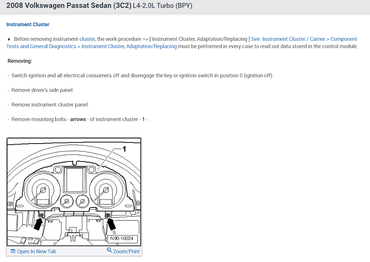

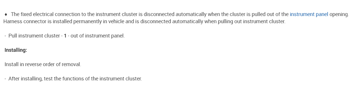

This sounds like the cluster had gone bad which will cause the issue you have described. Here is a video of the job being done on a similar vehicle and instruction in the diagrams below to show you how on your car below:
https://youtu.be/_HEC44xENxw
Please give the cluster rebuilder your VIN and mileage so they can program the new unit.
