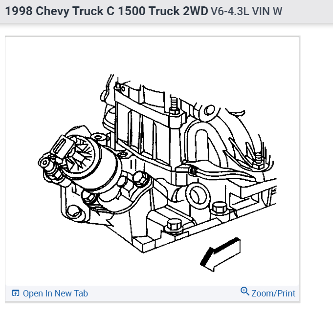

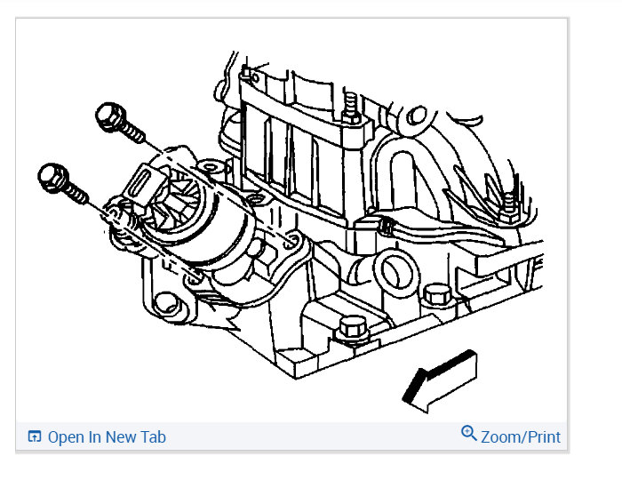

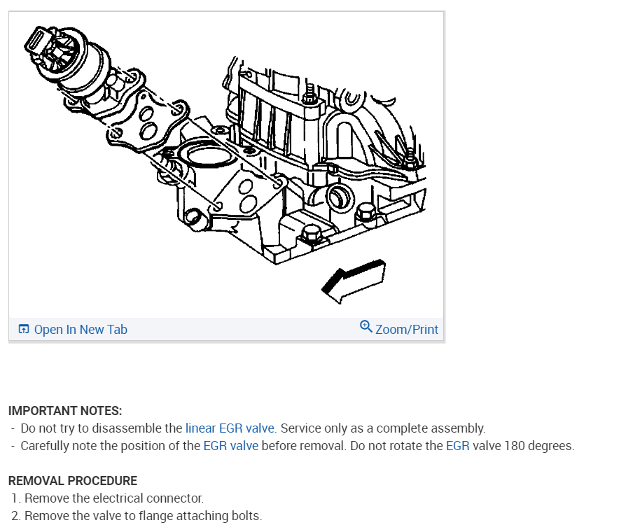

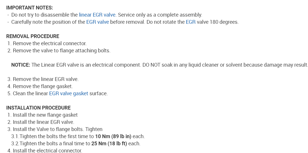

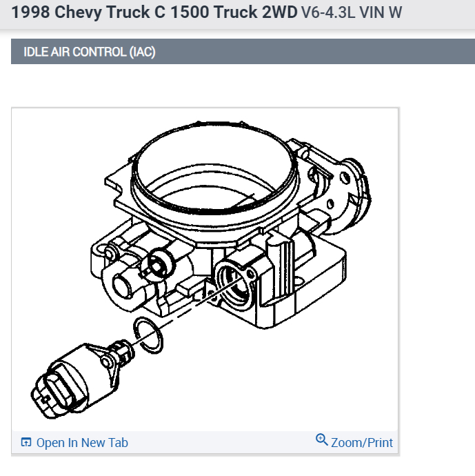

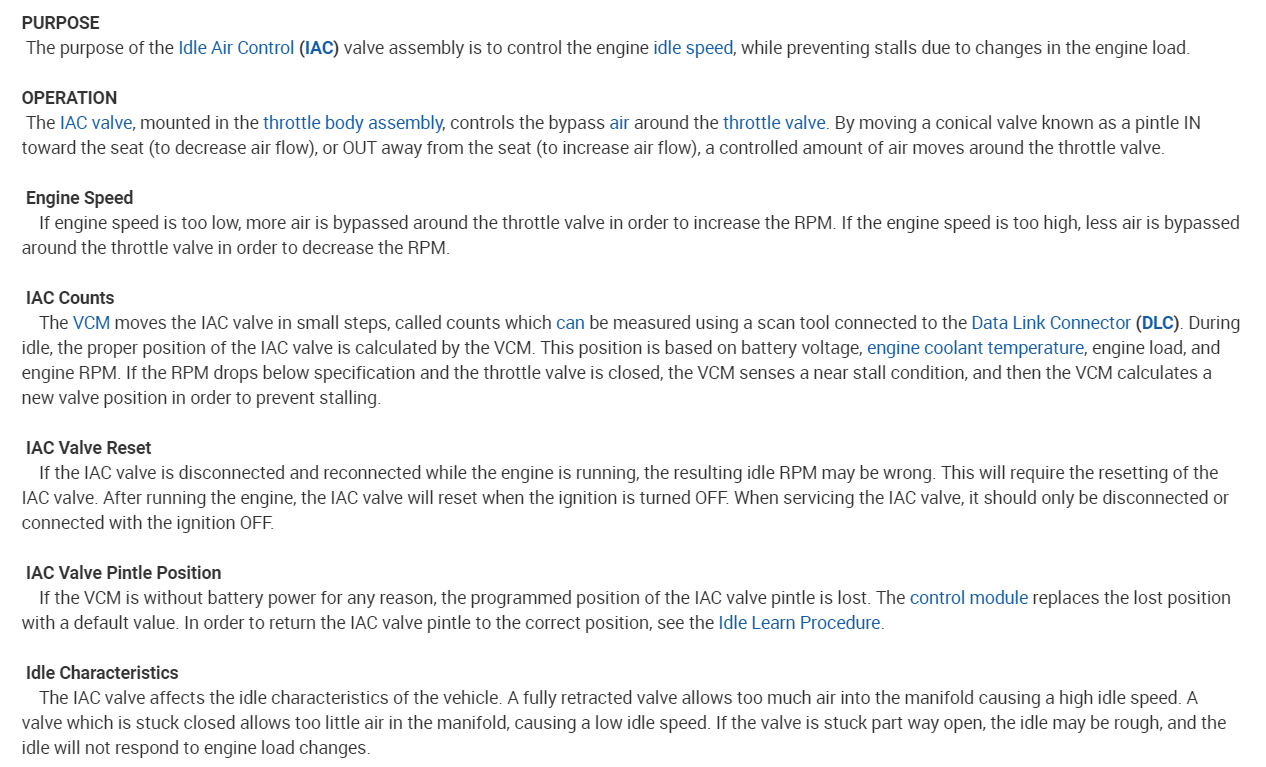

The first thing that comes to mind is the IAC valve needs to be replaced and ports serviced. Also, I have seen a sticking EGR valve do this as well. here is a guide and a video that will help with instructions in the images below for your car:
https://www.2carpros.com/articles/engine-idles-too-high
and
https://youtu.be/DqUCbbKdWf4
