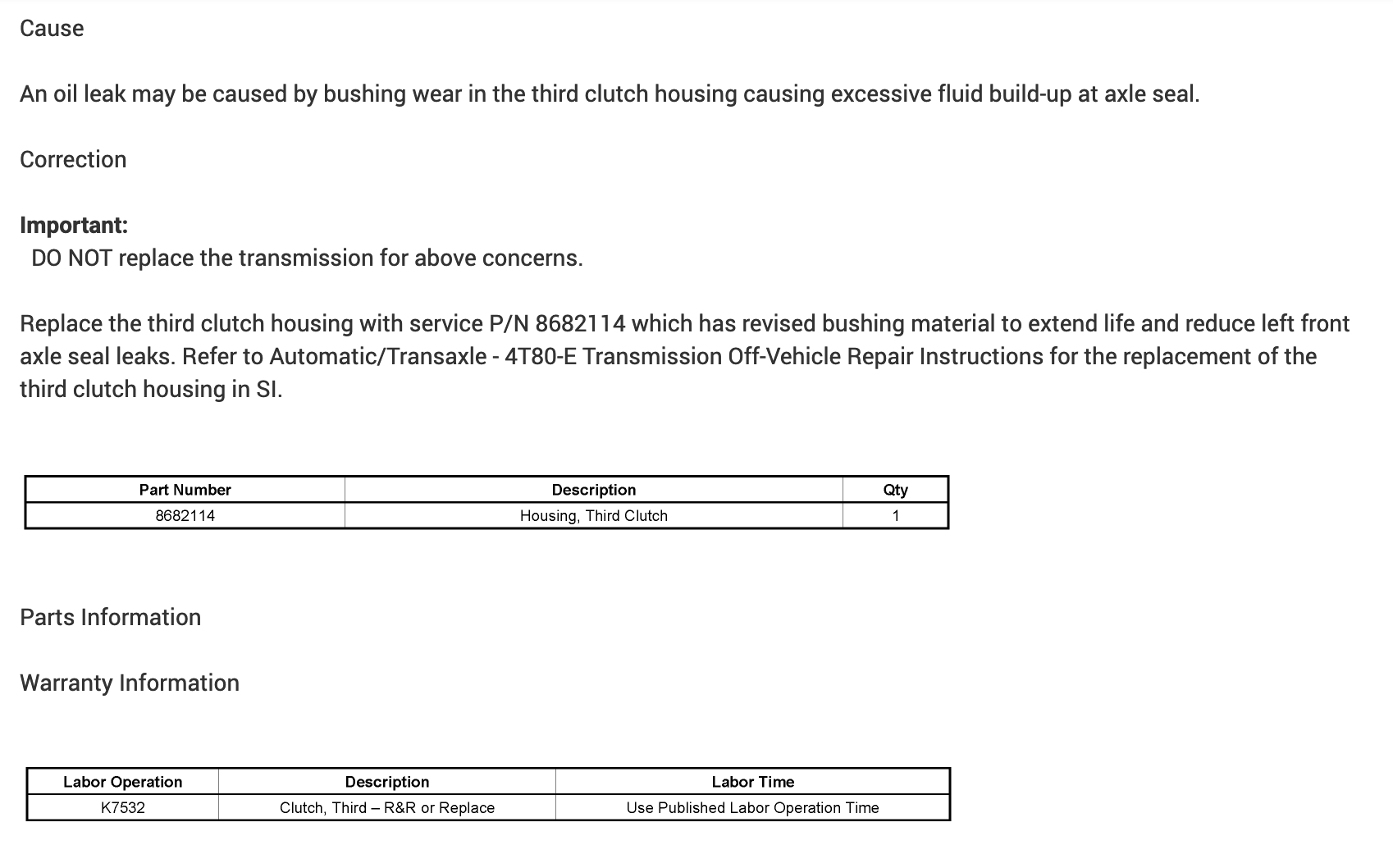

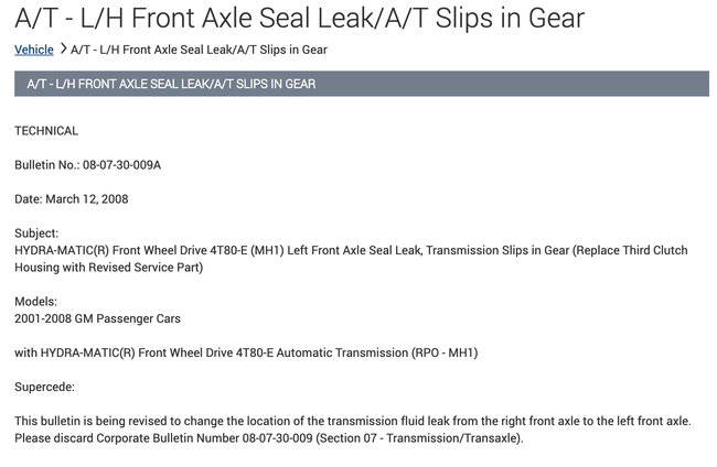

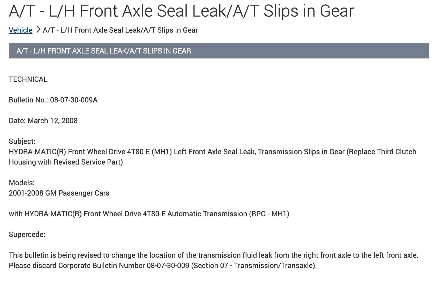

I have found a TSB (technical service bulletin) that seems to describe your issue.
If you can inspect your transmission for leaks, attach a picture if you find any.
The TSB describes an issue with the output oil seal to the left front driveshaft leaking.
TSB attached.
Hope this helps.
