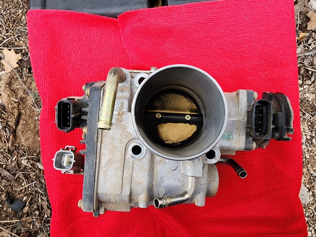

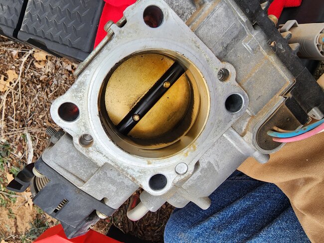

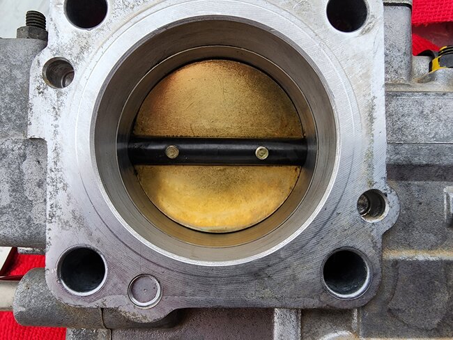

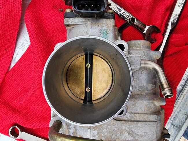

I cleaned the throttle body. It was really dirty; I think that it could have definitely been the problem. But I think I made a mistake along the way. When I turn it on it idles up above 2,000 RPMs and then shuts off. I put a code reader on it and it's throwing code P0122. I tried looking up how to fix it and it said to buy a new position sensor but is there a chance I put it on wrong or? Again, I really appreciate your help.
Jan 30, 2023 at 1:29 PM
You did a good job cleaning it. I would double check the electrical connectors to see if a pin is rolled over/pulled out if not it sounds like the throttle bore went bad. With that many miles a new throttle bore is not out of scope for the repair. Let me know what you find and thanks for the images.
