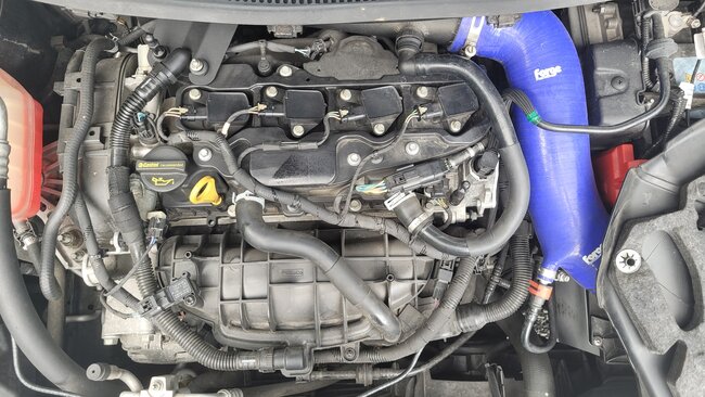

When the engine is hot after a rev in neutral the RPMs drop very slowly, they even stuck around 2,000 RPMs for some seconds (while the foot is completely off the gas pedal).

i had a check engine light: "P2187: System too lean at idle".
I don't really think the engine is down on power, but it could be, i don't really have the tools to check the turbo since it is not a really easy access...
i would love to check for vacuum leaks but I don't really have a smoke machine, i saw that it can be done with soapy water too but unfortunately i don't really know where the vacuum lines are and where should I spray the water? can you guys help me out by indicating them for me?
May 21, 2025 at 5:10 AM
Yep, it seems like you have a vacuum leak. I would use a smoke machine because it is difficult to find the leak on a turbo engine. I would inspect the turbo tubes and look for cracks or tears, the smoke machine is $70.00 on Amazon. Go back to the video and there will be a link. Let me know what happens.
