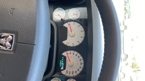

Here is a video showing the rpm on the dash at idle at a stop. You can see from the very start of the video it is around 400-500 rpm, and then quickly jumps down to 200 rpm and then slowly dips even lower than that, yet the engine is not shaky and does not stall.
When I had the scan tool hooked up and it was anywhere around the 200-400 rpm range on the dash, the ECM/scan tool was saying the engine was at an rpm of about 650, which of course is the normal rpm, and since the engine did not feel rough or shaky, I am inclined to believe that the ECM/scan tool is correct and the dash is wrong.

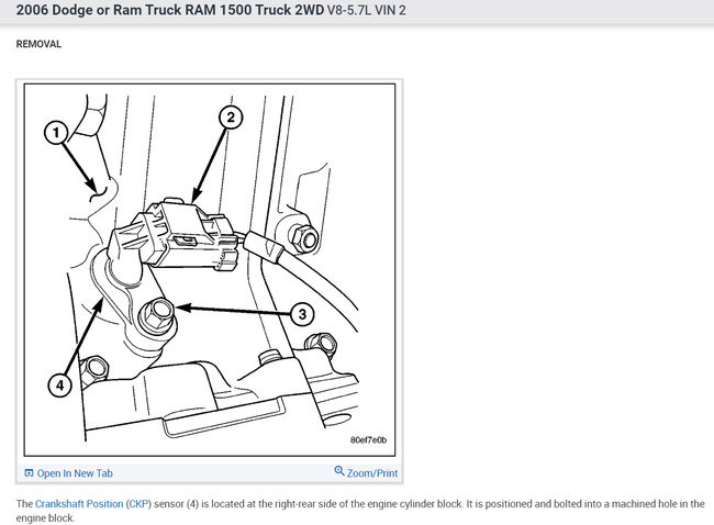

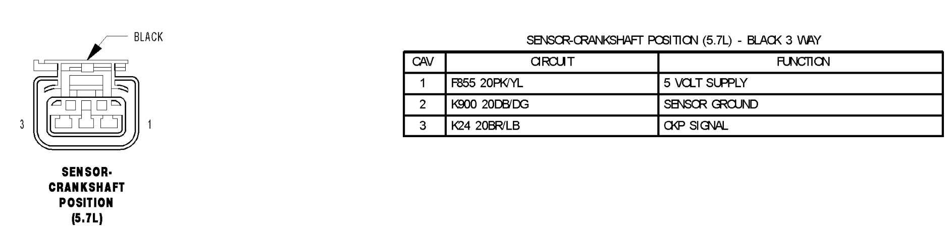

Yes. here are the connector views check for 5 volts, ground and trigger will show up on a digital volt meter and bounce up to about 1.5 volts.
Check out the diagrams (below). Please run some tests and get back to us.
