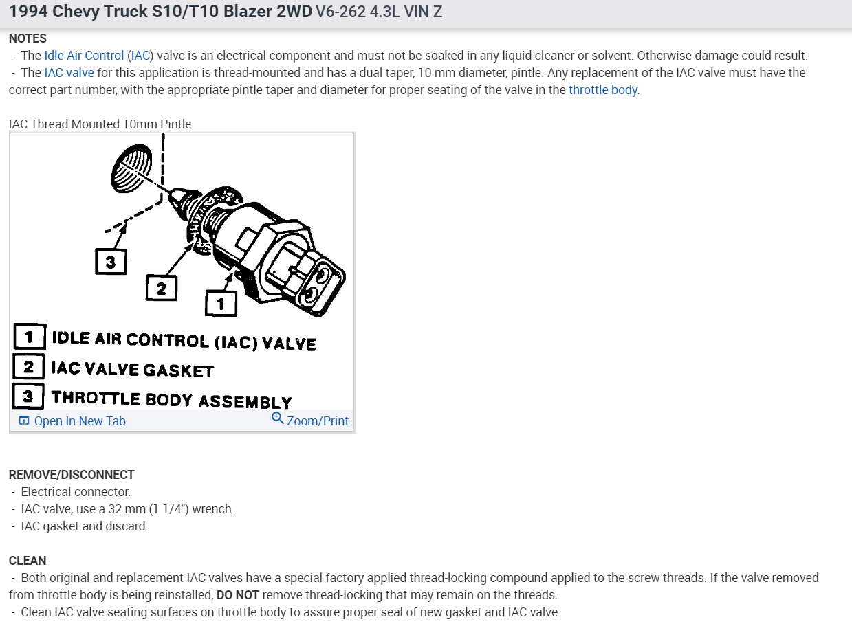

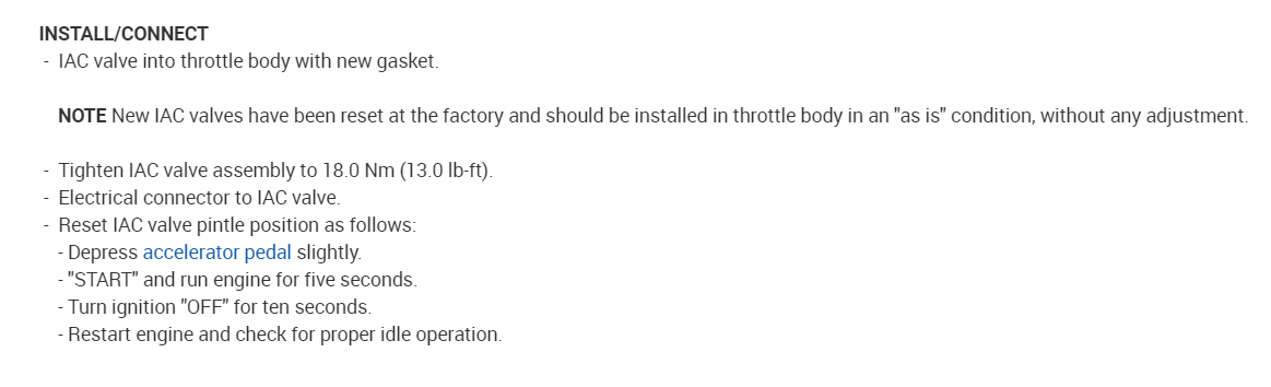

I don't think the yellow ABS warning light staying on is related. It sounds like there is a vacuum leak at the throttle body base gasket or the IAC control motor needs to be replaced and the passages cleaned with carb cleaner. Here is a guide you can use when the engine is cold only:

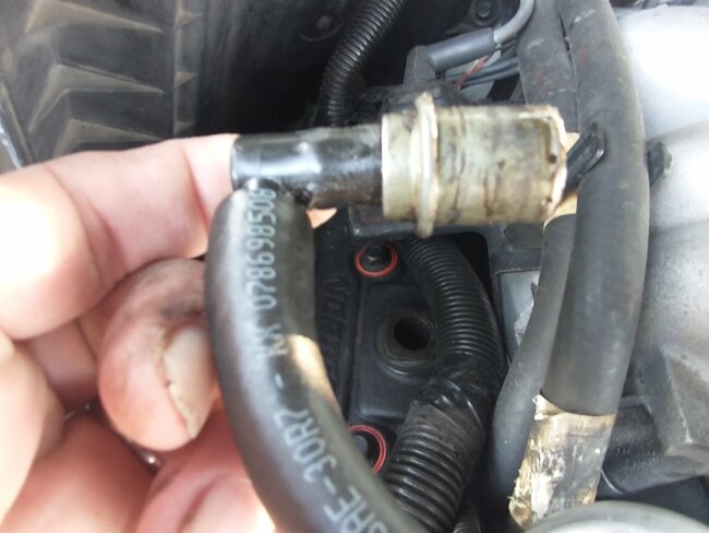

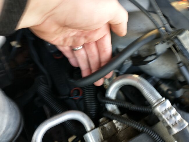

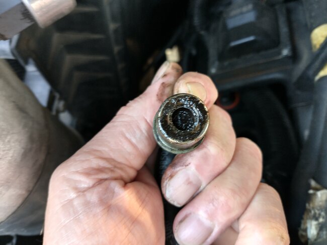

Used carb cleaner, did not detect any vacuum leaks. Did find a line going into side of motor (on left side facing) which pulled out very easily and was very dirty (see pictures). Not sure if this is PCV or if I should try and clean it. I thought PCV was on the other side. Removed IAC, it was pretty gunked up. Used alcohol pad and very gently cleaned exposed spring did not attempt to clean down inside of it. This did seem to make some difference. Ordered new IAC but will not be in till next week. Please forgive me for not knowing the proper names of engine parts, between the fact that the last time I worked on my own vehicle they still had points and condensers and a stroke messed with my memory.

No problem, which is the PCV which I would get a new one for. Here is a guide that shows how to use carb cleaner to clean the passages:
https://www.2carpros.com/articles/idle-air-control-valve-service
Please go over this guide and report back.

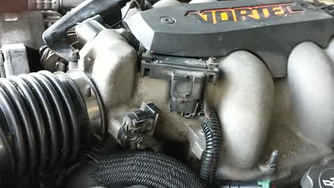

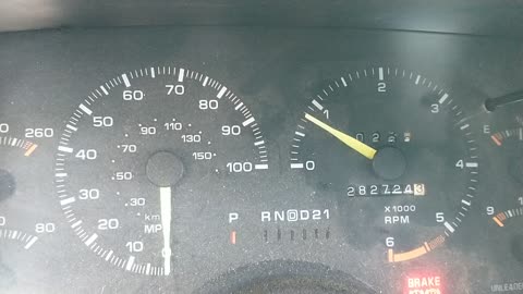

Ken, changed IAC and PVC. Cleaned ports the best I could but the air flow and air intake ( pellen?) Is all one piece. Only way to clean backside is to take whole intake off. Sprayed carb cleaner in hole that IAC goes in and what I could reach at air intake. Wiped out best I could. Oftentimes when I buy parts at parts store using vin number, what they give me doesn't match what's on truck. I'm wondering if previous owner put different motor in. Can you look at video and tell if it's a 4.3 vortec vin W. Manufacture date is 5/94. Other video shows tac so you can get a better idea of what it's doing. Engine had almost reach normal operating temperature when shot video.
Apr 13, 2023 at 5:20 AM
Thanks for the videos, they help, I would do a full tune up with new spark plugs, also I would service the throttle bore, the engine seems to be running okay, Also I would install a new MAP sensor. The engine looks stock except this is the high output engine. Make sure you install AC Delco spark plugs, wires cap and rotor. Also, I would check for vacuum leaks use this guide when the engine is cold only:
