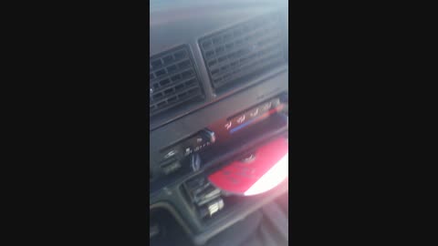

This is my attempt to video it. Might not do its full justice as I have to drive, shift and film. But did my best.
Oct 22, 2018 at 12:16 PM

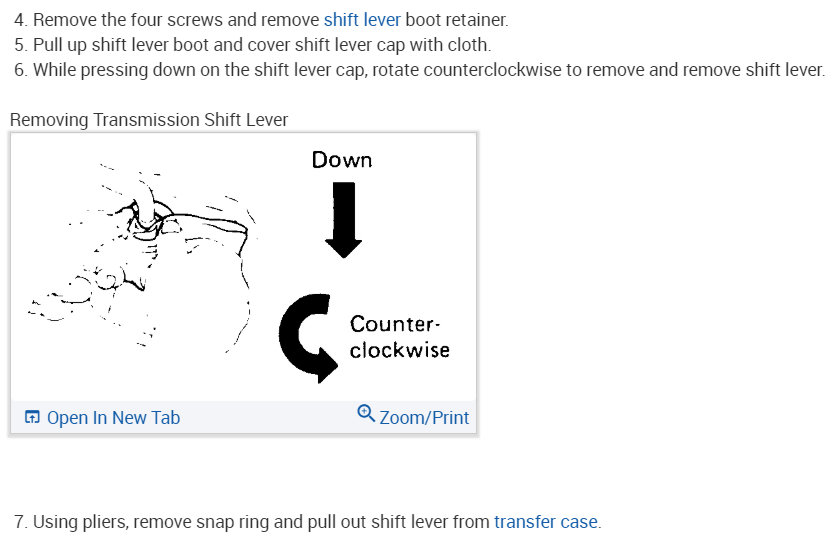

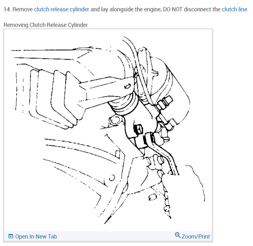

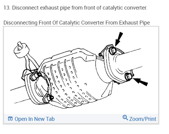

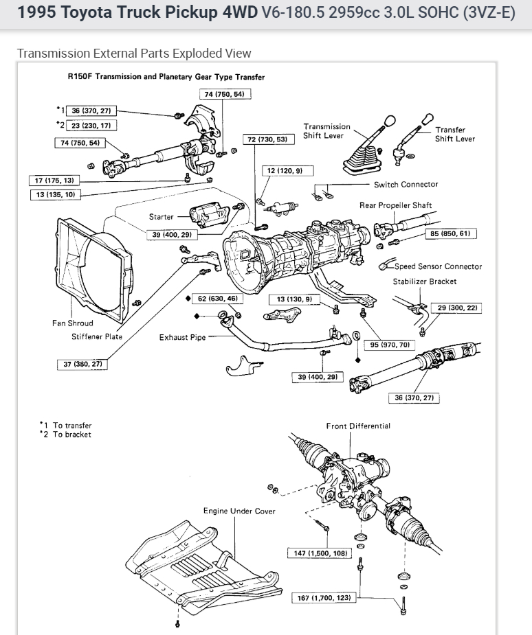

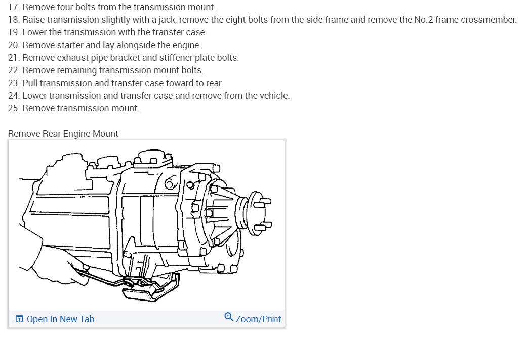

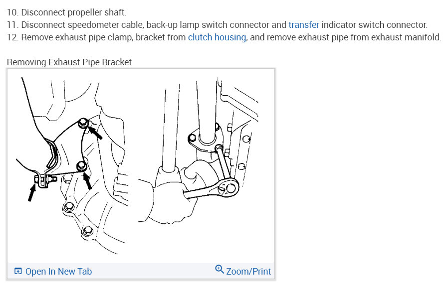

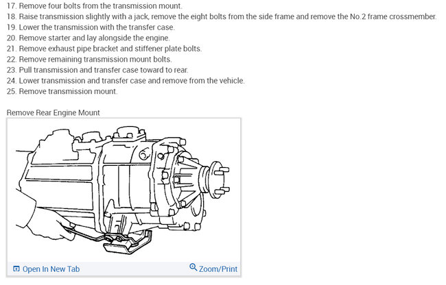

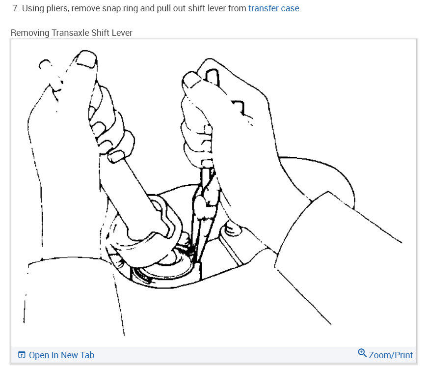

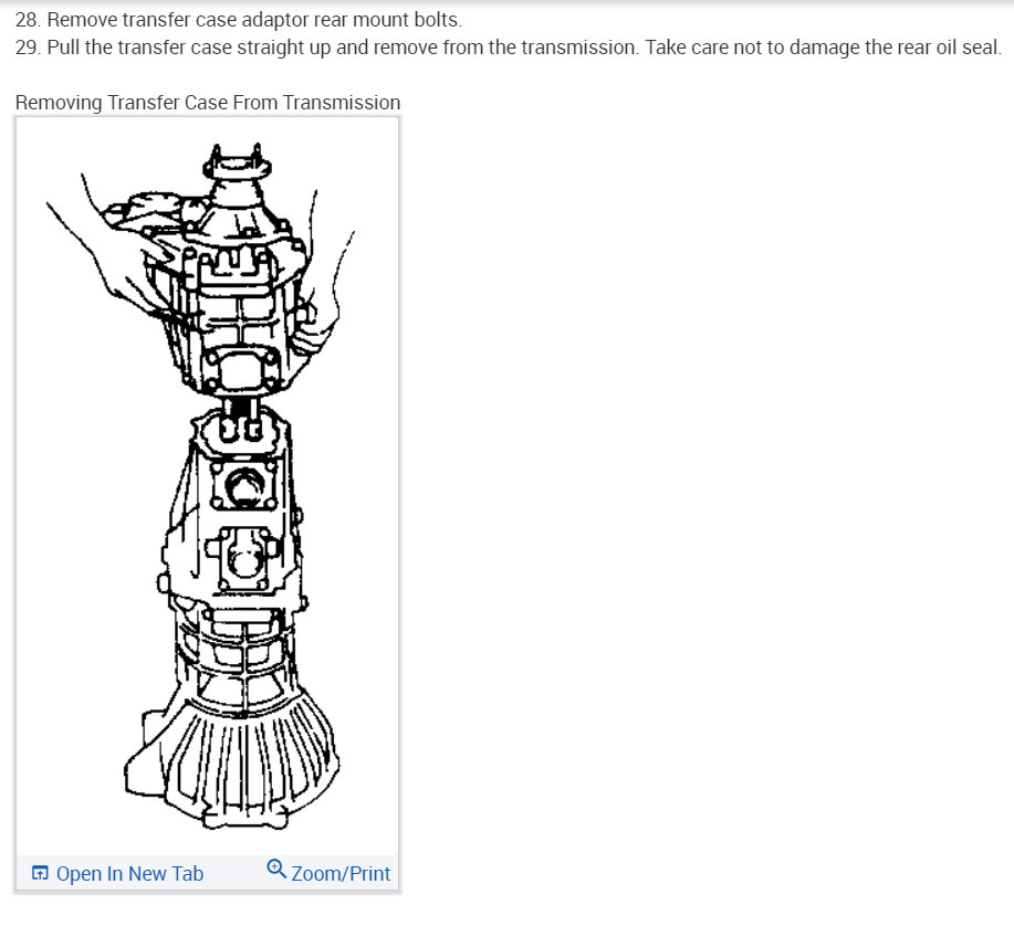

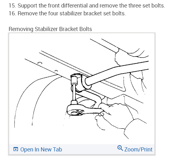

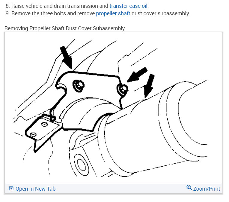

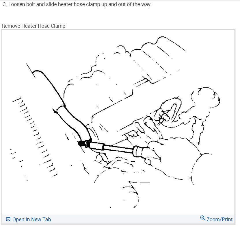

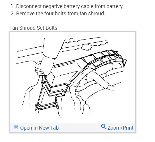

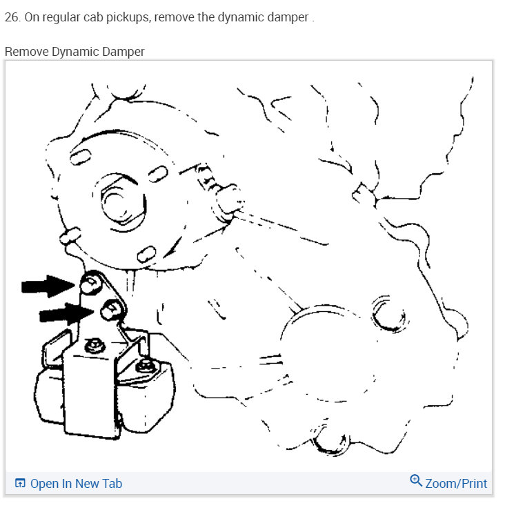

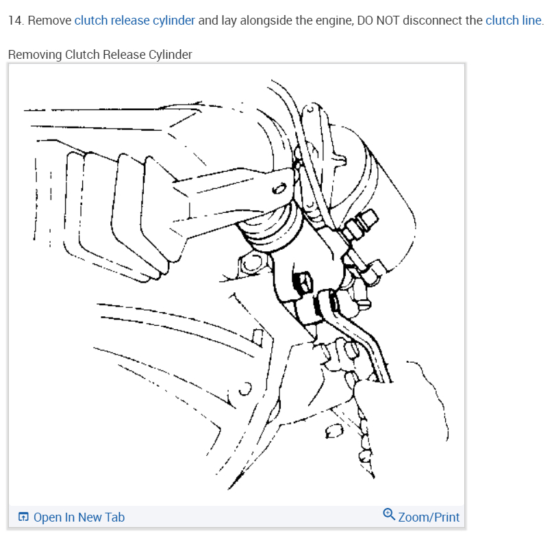

It looks like the clutch is slipping and need to be replaced. Here is a video that shows the steps. It is a different car but the process is the same. Here are diagrams to help you get the job done on your truck below.
https://youtu.be/JpzefqEeVGE
Check out the diagrams (below). Please let us know if you need anything else to get the problem fixed.
