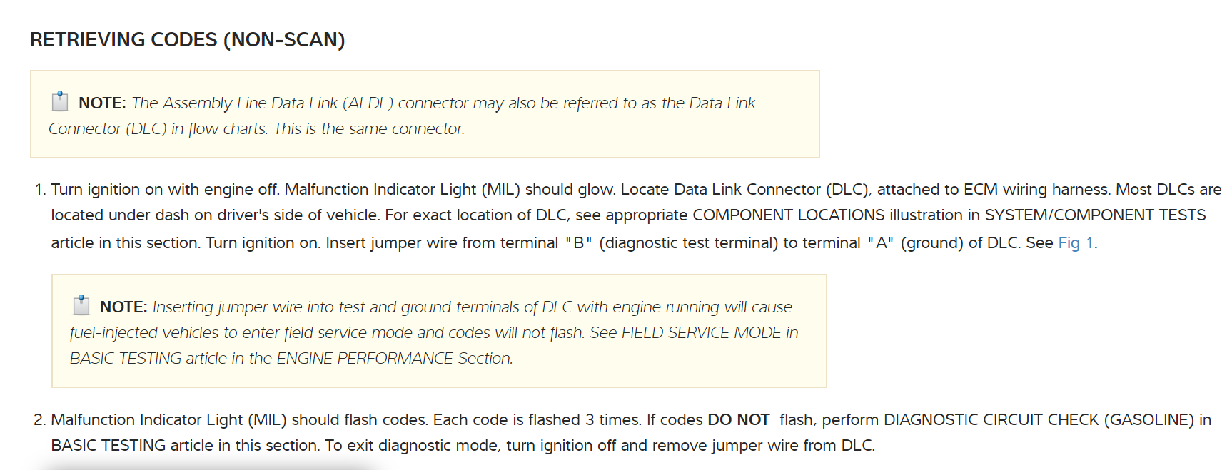

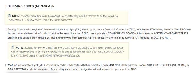

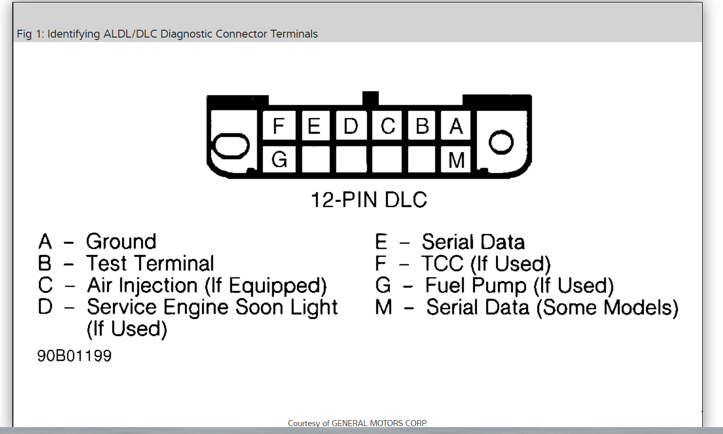

Is your Malfunction Indicator Lamp (MIL) or "check engine" lamp illuminated. If so could you pull the code(s) for us. In the diagrams down below I have included instructions on how to do this if you are unfamiliar with how to do this. Please go through this guide, if necessary, and get back back to us with what you find out.

perform the procedure but no code comes out.

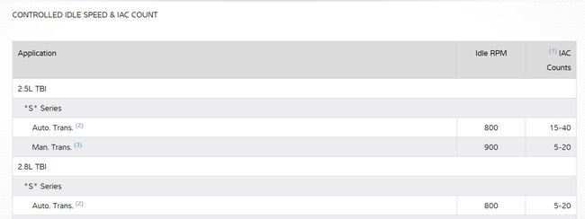

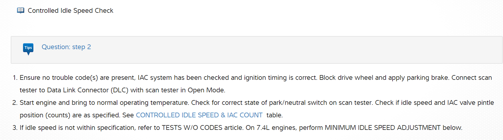

SCGRANTURISMO
  • 4,897 POSTS
Hello again,

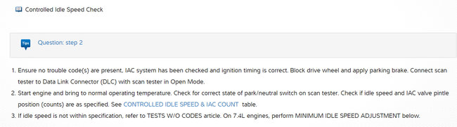

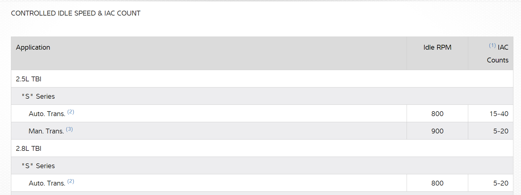

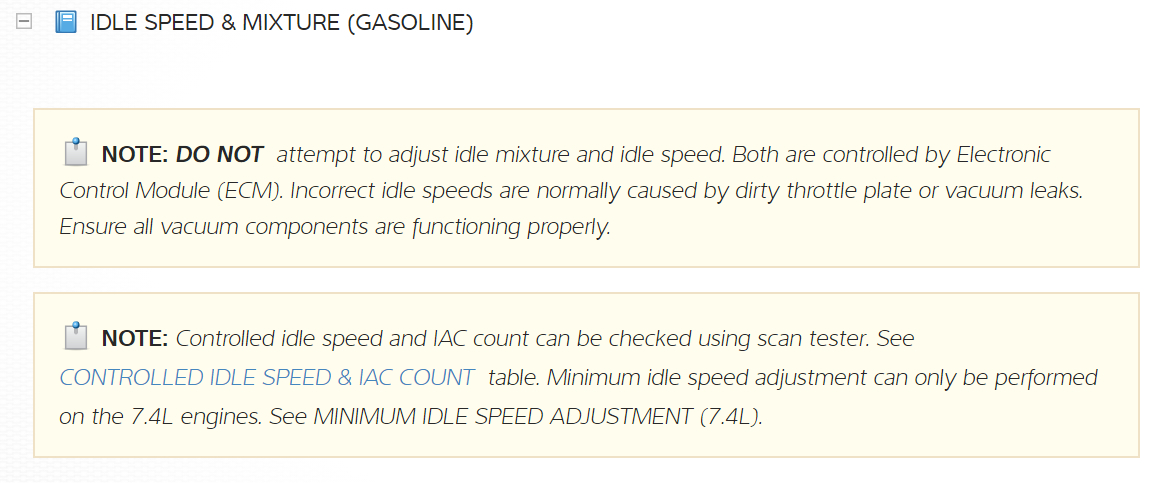

I have some information from the vehicle manufacturer in the diagrams down below. I also have a couple of links for you to go to down below:
Please go through these guides and get back to us with what you are able to find out.
Thanks,
Alex
2CarPros
