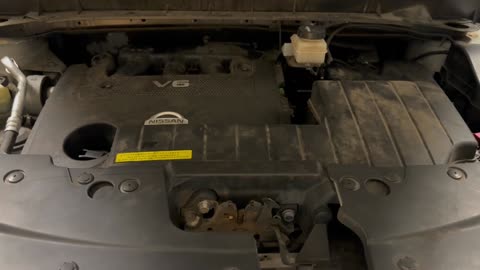

Hi Ken. Thanks for your reply! The parts are 13264-JP01A and 13264-JP01B. I heard back from the service manager today. He told me that he had to reposition two bushings that were removed for the AC compressor installation. Apparently, they didn't slide in all the way up to the shoulder. The misalignment caused metal-to-metal contact of the pieces that were bolted together. He explained that this contact caused normal engine vibrations to transmit to the rest of the car.
Since picking up my vehicle this evening, I have noticed a couple of strange things. As the AC cycles, there's a transient and unusual sound in the cabin that wasn't there before. I cannot find the words to describe it other than "mild whistling/squeaking and spinning." When I open my hood and stand there with the AC on, the compressor seems to cycle about every 20 seconds. What's odd is that every second or third cycle, the engine seems to go faster and get much louder.
Aug 6, 2025 at 9:04 PM
Man, this dealer does not sound good. To me the tech did not do the job correctly and now can have too much oil inside the AC system. Also, the fan should not cycle the way it does, if the system is charged correctly the fan would stay on all the time that the system is on.

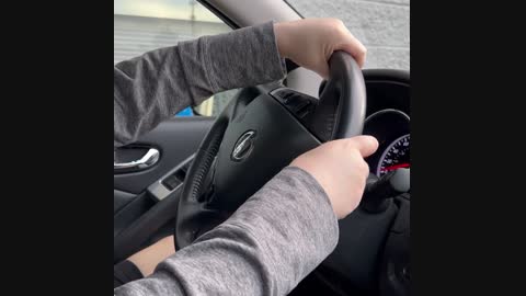

My problems keep getting worse and worse. Now my steering isn't functioning properly. Could it have something to do with the misaligned bushings from the AC compressor installation?
Aug 11, 2025 at 7:07 PM
No, the steering should have nothing to do with the AC. I see you moving the steering wheel, but what is it doing wrong, do you have a noise or ??
Aug 12, 2025 at 8:34 AM
SWAMPYSOUTH
  • 10 POSTS
The wheels aren't responding adequately to input from the steering wheel. I have to turn it more than normal for the car to change direction. It keeps wanting to go straight. The handling feels vague and imprecise and "floaty."
Aug 12, 2025 at 10:18 AM
Geeess,, the car is having issues, I would have it towed to a shop for inspection, I would not take it back to the dealer you had it before. I am sorry you are having these issues :/ Please let me know what they say.

Now I want to address the steering problems I developed immediately after the misaligned bushings were corrected. I'm going to cite AI here since it's quick and easy, "The symptoms you're describing—steering vibration, grinding noises, inability to reach full lock, and post-repair looseness—strongly suggest that the misaligned bushings during AC compressor installation may have caused collateral damage or improper reassembly of components near the steering rack, subframe, or engine mounts." The specific issues it points out are: 1) Subframe Misalignment; 2) Interference with Steering Rack or Linkage; 3) Damage During Correction; 4) Suspension and Mounting Issues. AI also suggested the most likely causes for the symptoms my car was experiencing:
- Symptom: Steering wheel can't reach full lock (Happened while in reverse)
Cause: Rack or tie rod interference, subframe shift
- Symptom: Grinding noise when turning
Cause: Metal-on-metal contact, possibly steering shaft rubbing
- Symptom: Loose steering feel
Cause: Misaligned rack, worn bushings, or damaged linkage
- Symptom: Squeaks/rattles on bumps
Cause: Disrupted suspension geometry or loose mounts
The service manager acknowledged the original misalignment of the bushings and confirmed that it was the cause of the grinding sound due to metal-on-metal contact. However, instead of explaining why this resulted in the steering problems I developed, he surreptitiously fixed them and then pretended that he had done nothing at all besides drive the car around a bit. He implied that the things my teen daughter and I experienced were just a fantasy. He was super condescending and smug. I imagine he and the dealership were fearful of litigation since they not only caused the problem, but they failed to catch it before returning the vehicle to me. My daughter and I could have been killed in an accident.
The steering is precise now and the wheel has no trouble reaching full lock in reverse. What concerns me is that the car has a lot of squeaks and rattles it never did before. It's noisy when driving on road that isn't smooth. I'm concerned that it's not just annoying, but can cause problems over time. How do I even begin to address this to the "big dogs?" As it is, the dealership had to pay for the parts and labor to fix these problems and obfuscate the fact that such work was necessary.
What questions should I raise? What tests or expert assessments should I demand? I cannot ask what was broken and what parts were replaced because, as far as they're concerned, the problems never existed and there is no written record of the work they did. I'm just some nutcase who is never happy and complains about everything... It's beyond maddening!

I asked AI about the reason why my AC is cycling rapidly and it came back with some possible causes. Based on everything you already know, which of these seem to apply to my situation?
- undercharged system
- overcharged system
- faulty pressure switches
- improper compressor oil balance
AI also says the cooling fan is blowing at high speeds to compensate for heat buildup. This makes complete sense and I have noted the heat in the engine compartment and coming out of my tailpipes. The reasons for it provided by AI are:
- The AC system is under strain and the condenser is overheating. (There's that pesky condenser that I mentioned in my post last night!)
- The engine cooling system is trying to dissipate excess heat from the AC load. (For sure!)
- The fan control module or temperature sensor is reacting to spikes in temperature caused by the compressor cycling.
Do you believe this overheating, especially since it involves the condenser, may, in fact, indicate point to contamination of the AC system and its parts? Could they have installed a compressor that isn't compatible with the 2011 Murano's AC system?
The fact that my V6 engine is struggling at moderate speeds (40-50 MPH) is really disconcerting. I have never heard or felt it under so much strain. Do you think it could be using excessive torque to operate? Do you believe that condenser may be blocked? Or could it be the radiator struggling to dissipate heat? Or both? It doesn't seem likely that a dirty throttle body is the problem because we already know about the compressor. Nonetheless, should I have the techs check the throttle body for buildup?
The other night, while sitting in a parking lot with the AC on, the fan turned off in the cabin and the light on the dash went dark. I tried to turn it back on, but the button was unresponsive. A few minutes passed and I was able to turn it back on. Do you think the faulty compressor triggered a thermal overload or protection lockout? Do you think it is reasonable for me to request that the mechanics check for evidence of this? What codes should they look for?
- Check refrigerant pressures (both high and low sides).
- Inspect the compressor clutch and fan relay wiring for loose or damaged connections.
- Test the AC control module and pressure switches to see if they’re triggering premature shutdowns.
- Verify that the system was charged correctly with the right refrigerant and oil type.
Do you have any additional suggestions for tests to pinpoint the problem(s)?
Based on all the new information I have provided, do you think the AC system is contaminated? It sounds like the condenser absolutely needs replacing. What other AC parts are most likely to need help after this nightmare?
The steering problem was secondary and caused by slopping work during the AC compressor installation and realignment of the bushings.
The main problem appears to be the AC system itself.
Thanks again for everything. I look forward to hearing from you so I am fully prepared to do battle!
Aug 17, 2025 at 8:13 AM
The thing is the car was fine before the service, so they left something off like a ground wire. But if you think the AC is causing the issue, here is a video to help you check it.
