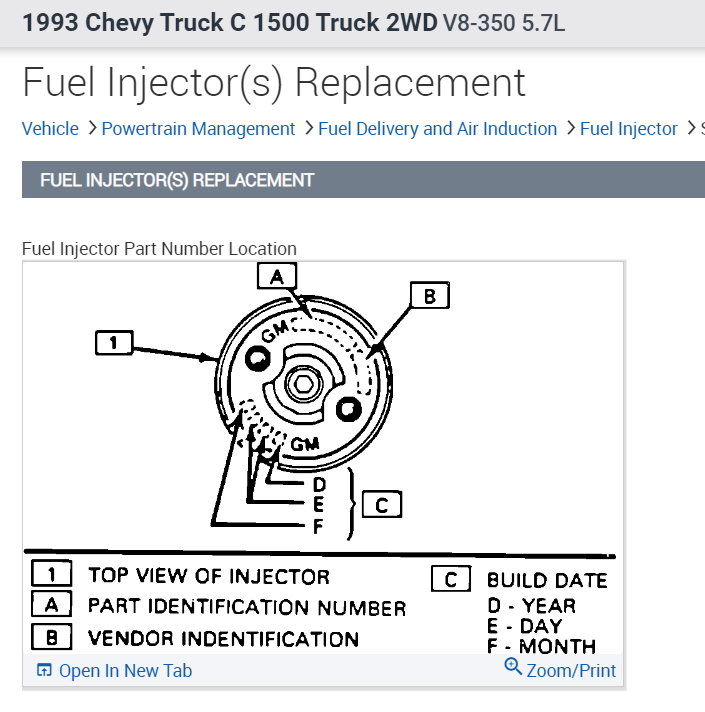

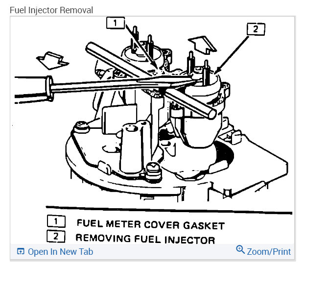

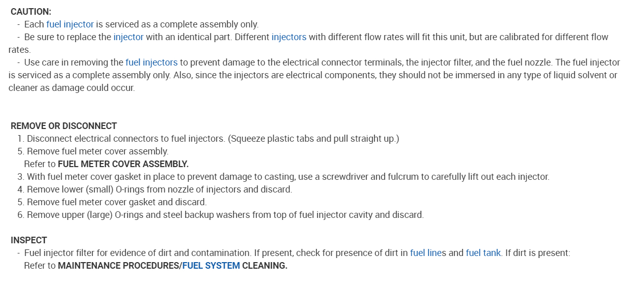

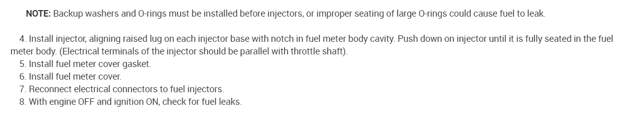

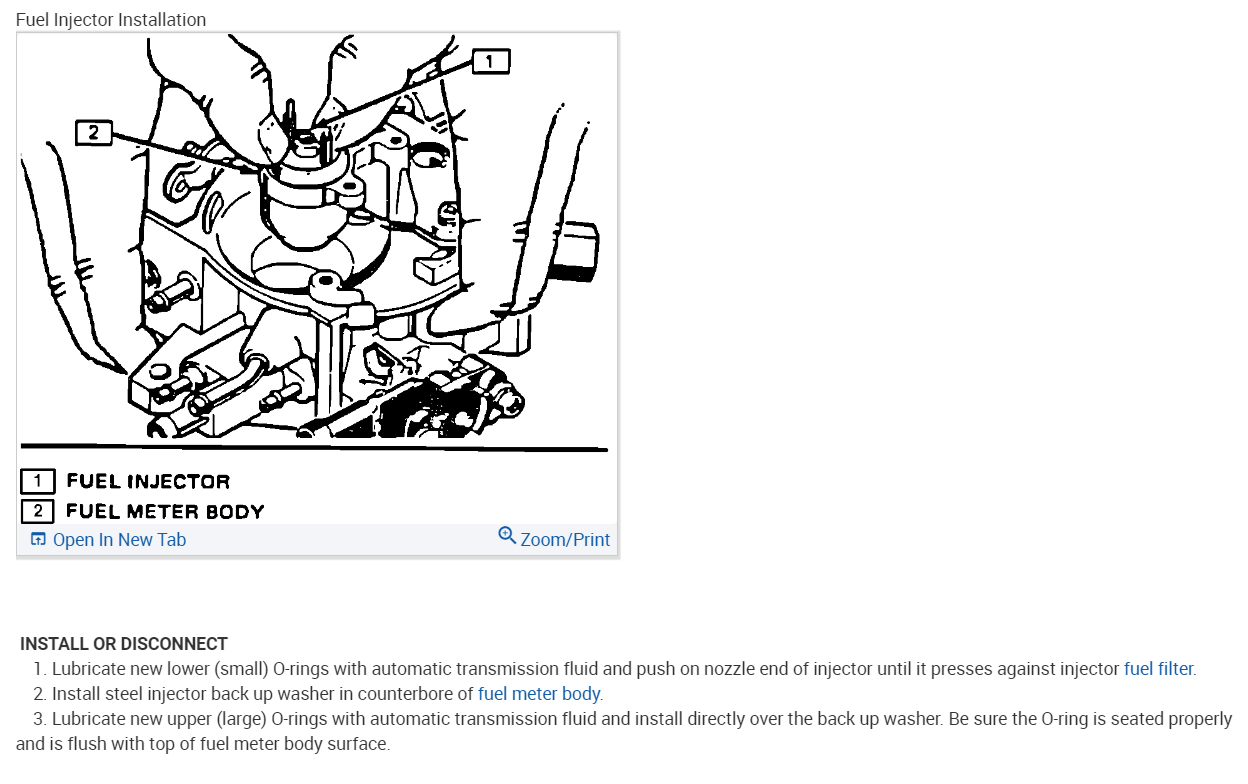

I have seen where one of the fuel injectors is leaking causing the engine to flood out. To be sure please remove the air cleaner then start the engine and shut it off. When you shut the engine off use a flashlight to look at both injectors to see if you can delete any leakage. If so, that fuel injector will need to be replaced. Here are instructions on how to do the job. I would check Rockauto for the parts. Check out the diagrams (below). Let us know what happens and please upload pictures or videos of the problem.

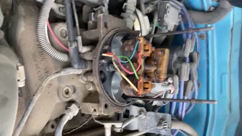

ASABASS
The video is after letting it sit all night. Would outside temperature affect the injectors? We have had a few days over one hundred degrees and it seems to no chug as much then.
