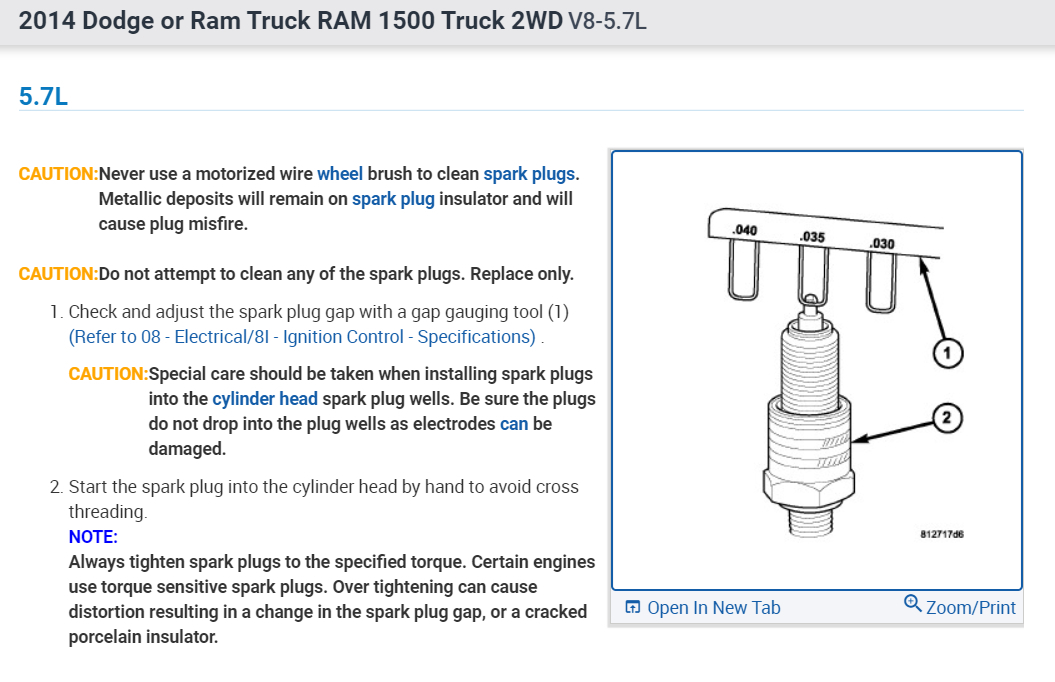

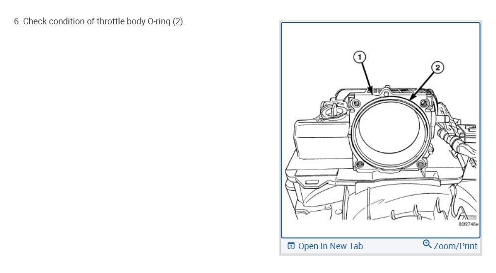

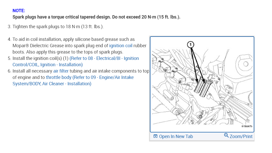

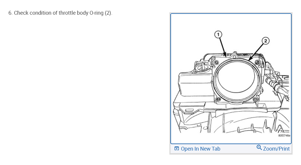

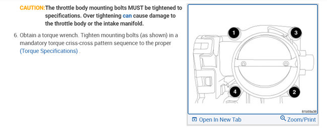

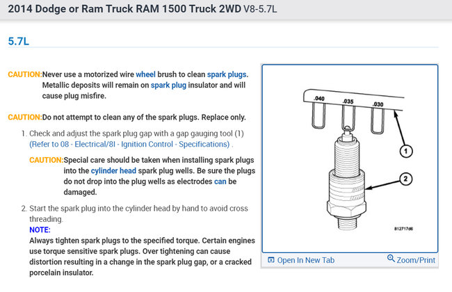

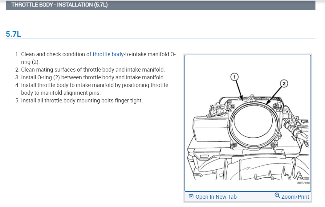

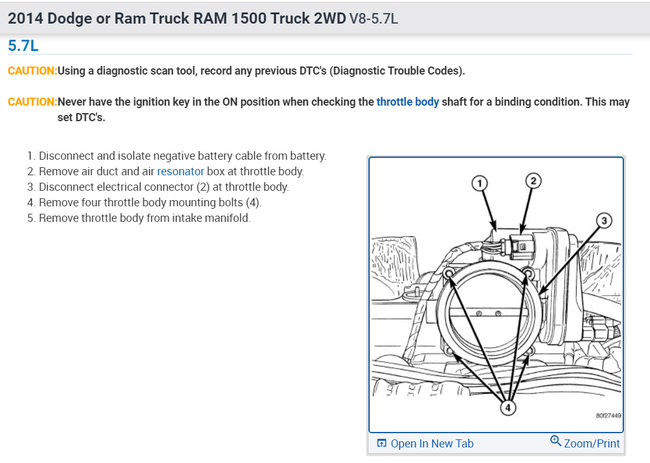

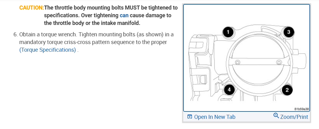

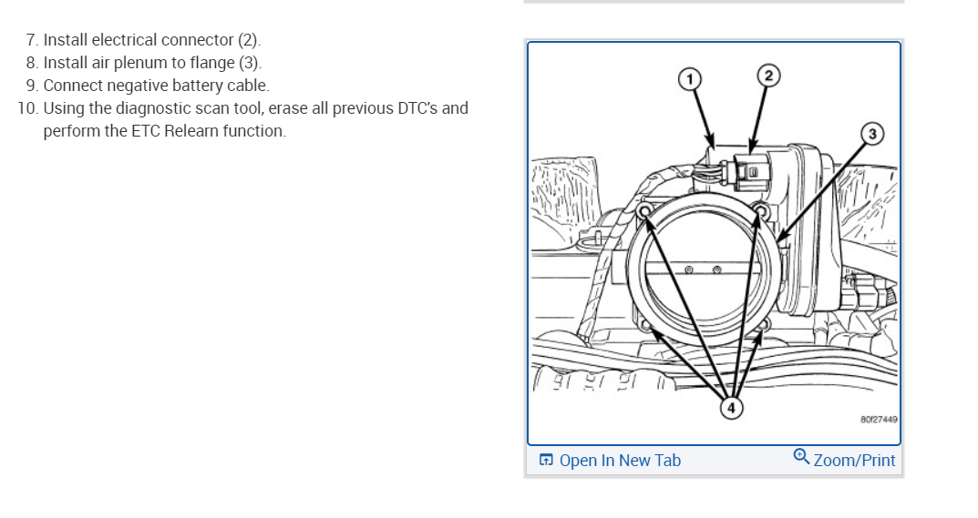

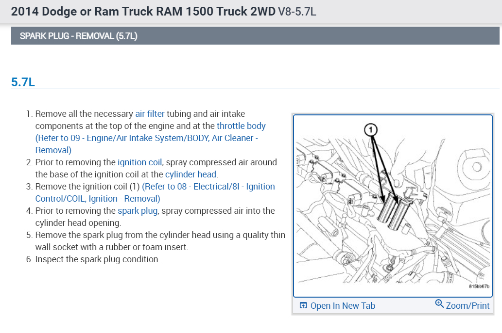

The P219A code is the clue because there is an imbalance between the cylinder banks which means there is an engine misfire which is causing the problems, I would start with a good tune up including spark plugs and throttle body service. Here are generic guides to help you see what you are in for when doing the job and instructions in the images below to show you how on your truck. Once completed clear the codes to see what happens.
and
https://youtu.be/BmuIjFQDE5I this is a video on the spark plug replacement.
https://www.2carpros.com/articles/how-to-tune-up-a-car-engine
