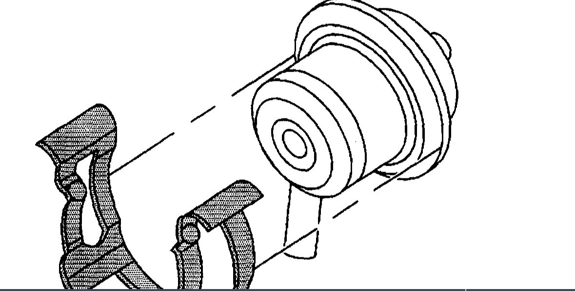

Good morning,
I would start with the fuel pressure. Check it and make sure the pressure is correct.
https://www.2carpros.com/articles/engine-misfires-or-runs-rough
You need 55-60 pounds of pressure.
The issue is the fuel pressure regulator. It is common to fail and when it does it drips fuel directly into the intake manifold and makes it run rich and also lowers the fuel pressure as well.
Are there any codes set?
If you have a scan tool, can you give me the long and short term fuel trim percentages?

I would start with the regulator as I suggested. It is part of the spider but can be replaced by itself as in the picture I gave you.
Sep 29, 2020 at 10:30 AM

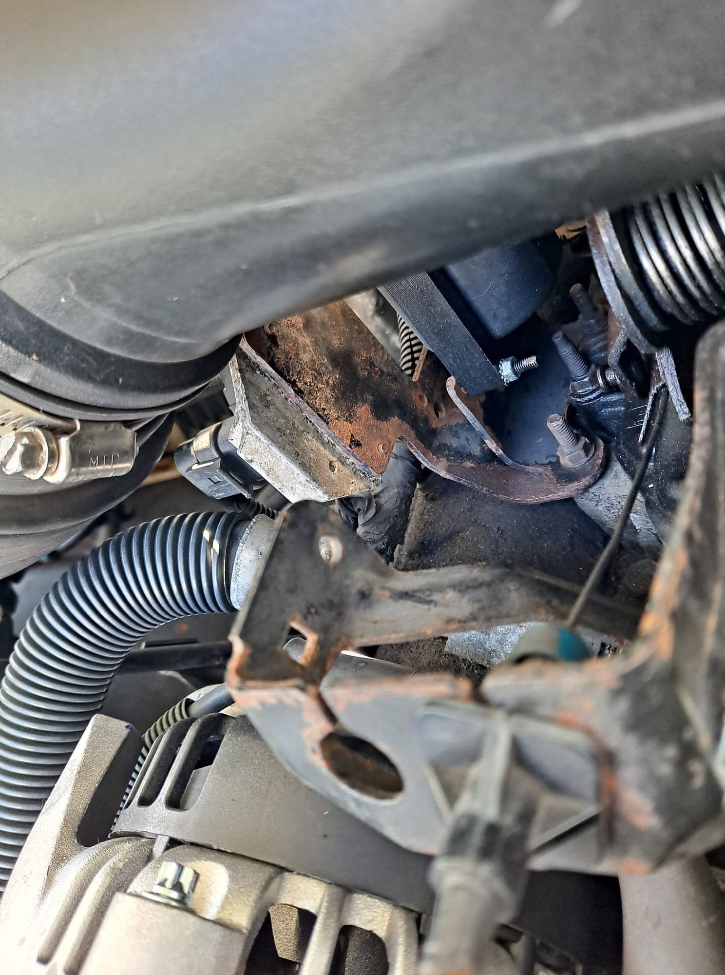

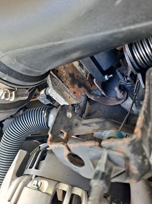

After further inspection, (although it's right in front of me and several mechanics) the "heat sink" is missing from my ICM. I'm going to try a new ICM and new heat sink before I tear the intake manifold apart.
Sep 30, 2020 at 5:50 AM
Okay, that will not effect the fuel pressure issue at all.
Sep 30, 2020 at 6:13 AM
