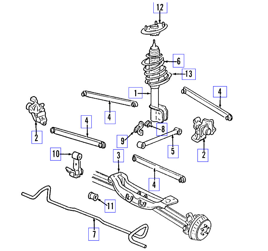

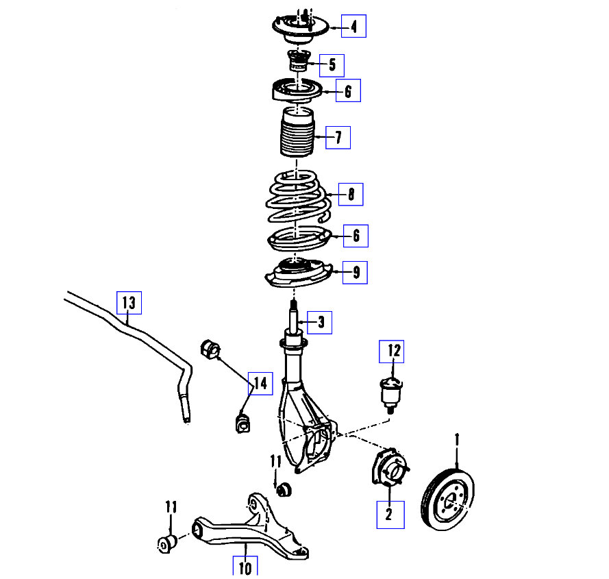

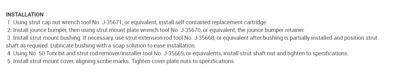

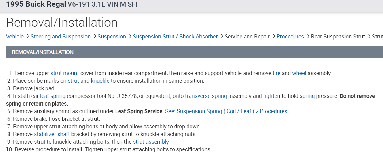

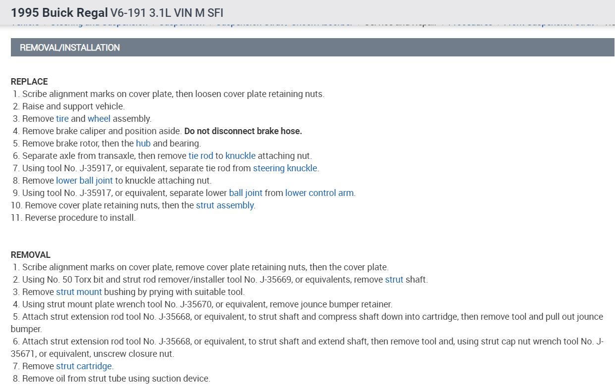

This could be due to the air pressure in the tires being over inflated or the front struts or rear shocks need to be replaced. I have left instructions in the images below on how to do the job. Check out the images (below). Please let us know what happens.
