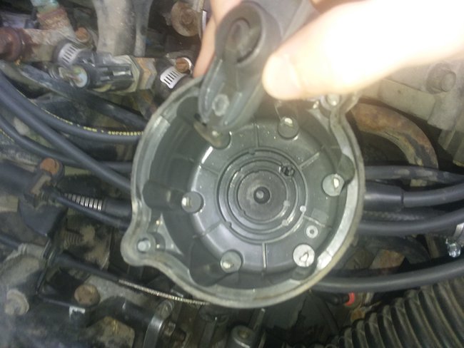

I think I felt a very slight misfire at a stoplight. Not constant and happens every once in a while in idle. The distributor rotor is dirty so that might be the problem.

If you take some emery paper, you can clean the rotor to see if it makes a difference. Have you tried to check for diagnostic trouble codes? Here is a link that shows how to retrieve them on a Ford OBD1 system. That may show a misfire.

Replacing cap, rotor and air filter in about a week since they really need to be replaced anyways. Will update you and scan if that does not improve the performance.
