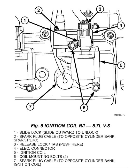

pic 1
5. Remove ignition coil connectors (Fig. 6).
