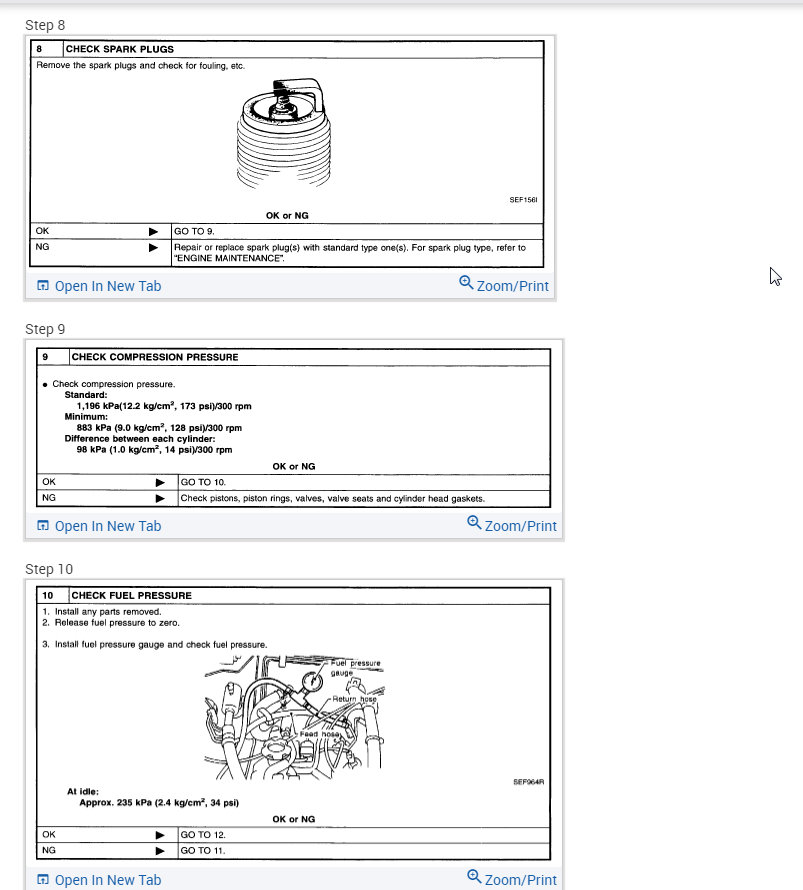

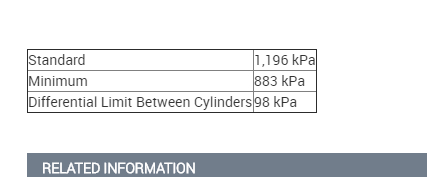

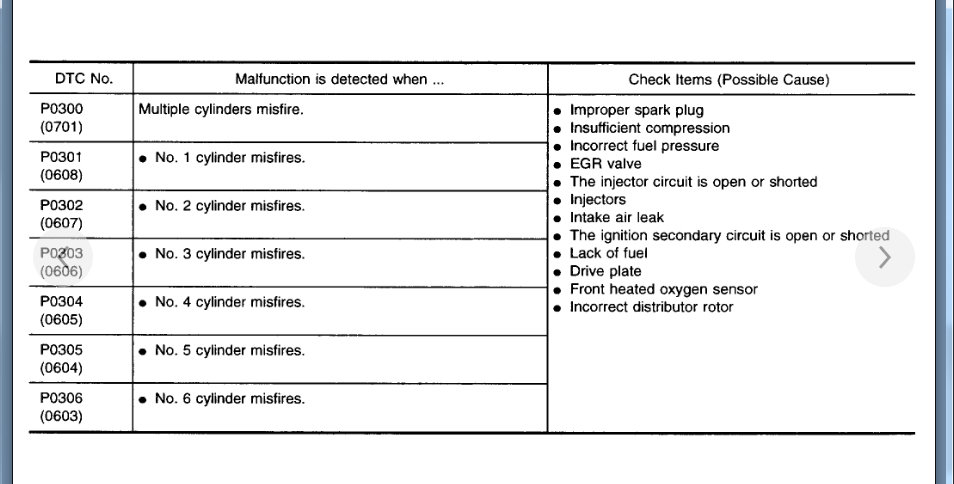

Yep. That is the issue. Clearly if you have low compression on one cylinder then that will cause a misfire. Your minimum spec on compression is 130 PSI.
Long story short, we need to find the cause of the low compression on that cylinder. The knock sensor issue can be addressed after the compression is fixed.
