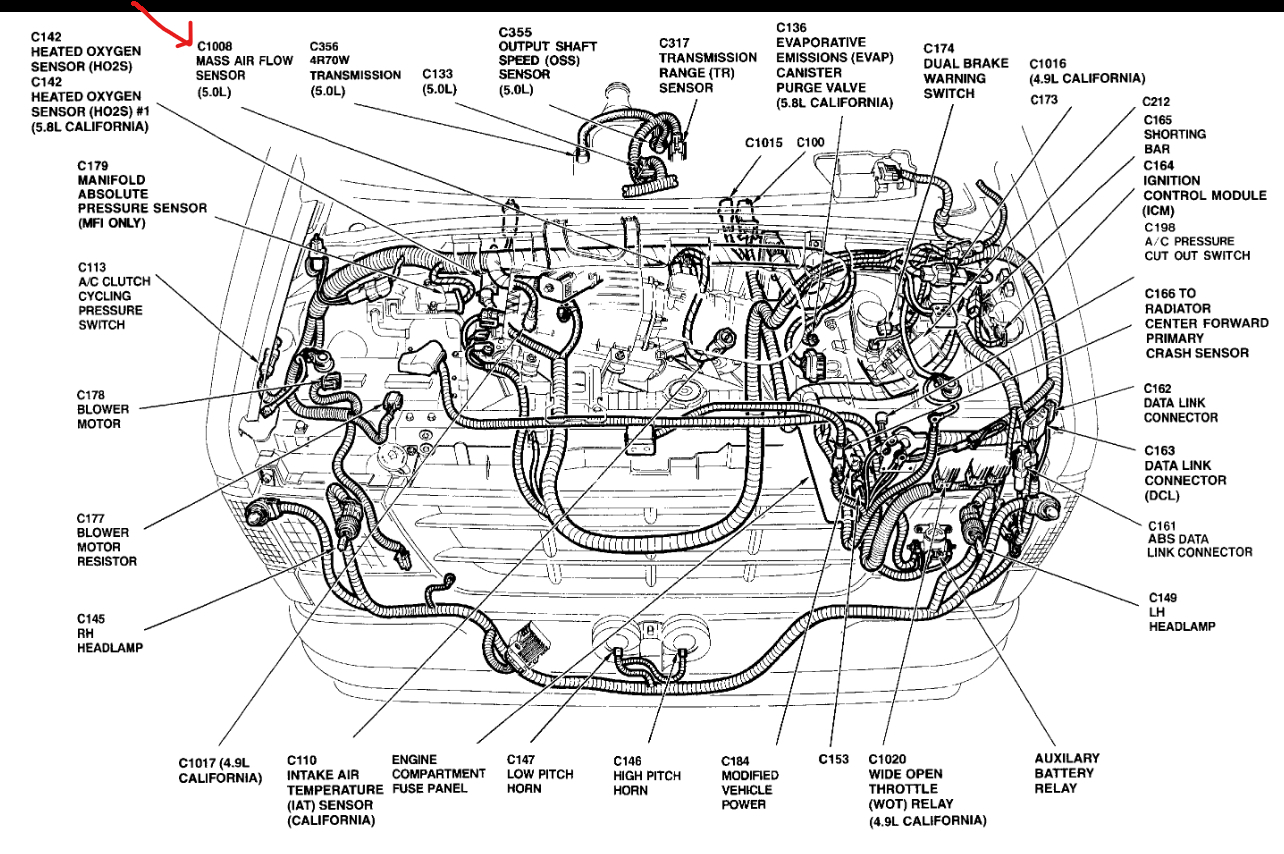

I would also service the throttle bore, make sure there are no vacuum leaks, and I would swap out the MAF sensor,
This guide can help as well:

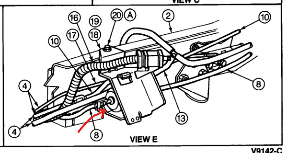

Here are the fuel filter and MAF sensor locations so you can change them out. Check out the images (below). Please upload pictures or videos in your response of any problems so we can see what to help you with.
