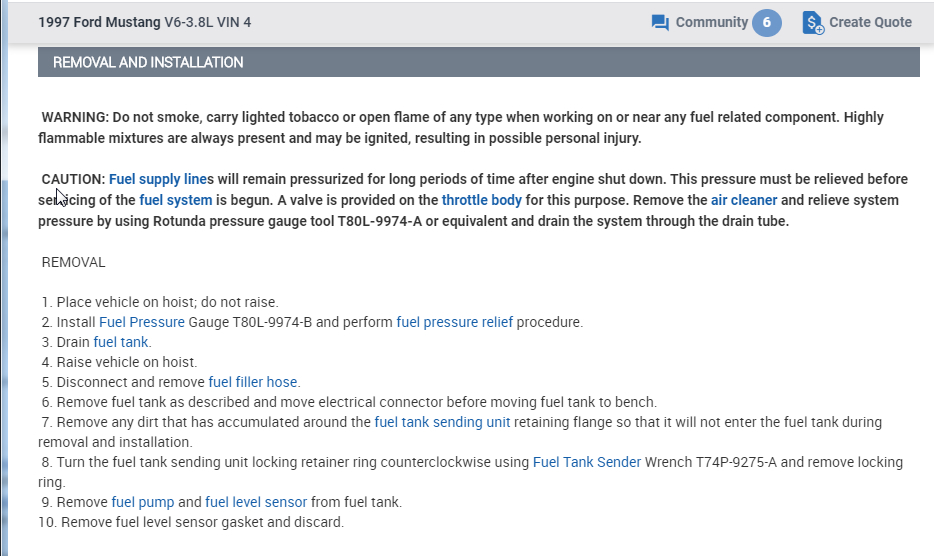

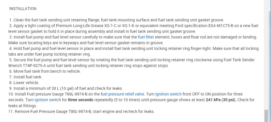

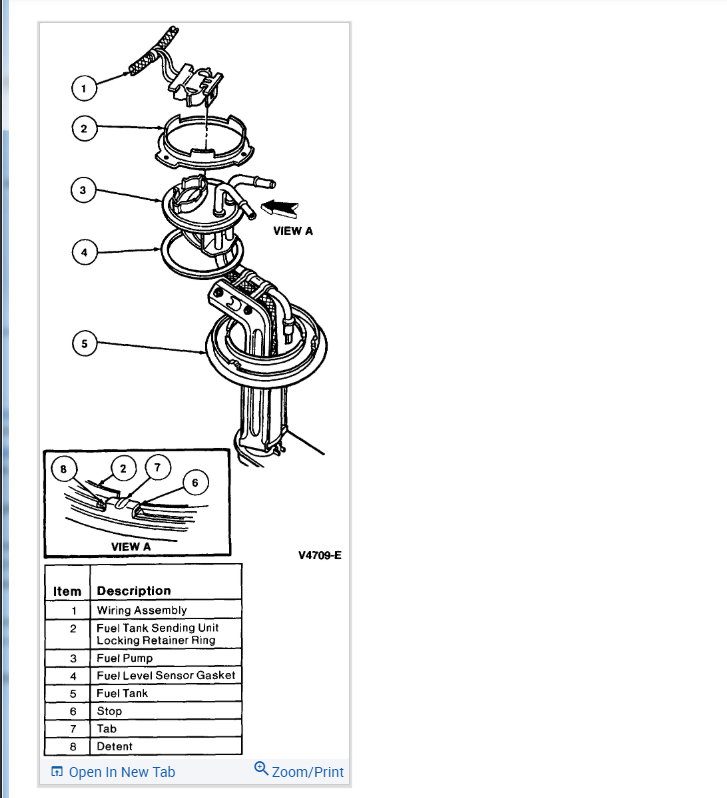

I attached the process on how to replace this if you need it. Let me know if you need more assistance.
