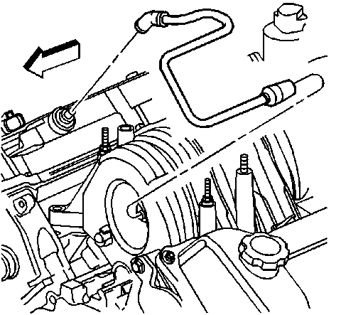

1. Disconnect the MAF sensor electrical connector.
Picture 1

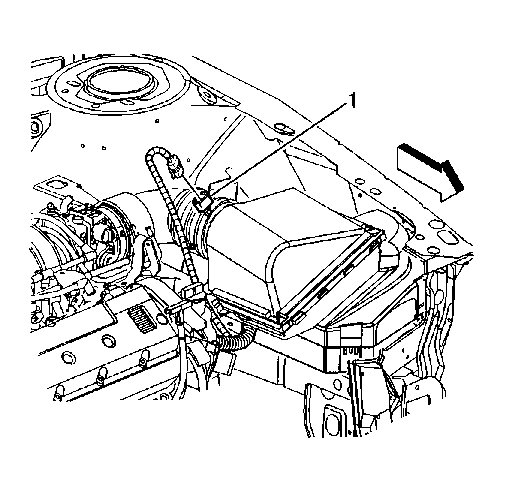

3. Remove the mass air flow (MAF) sensor and air cleaner intake duct (2) as an assembly.

NOTE: The outlet of the air cleaner assembly and the MAF sensor inlet duct must line up when completely installed. Misalignment may cause incorrect airflow readings resulting in MIL illumination or a driveability concern. An improperly installed inlet duct assembly or air cleaner assembly may cause misalignment.
Picture 3
1. Install the MAF sensor and air cleaner intake duct (2) as an assembly.

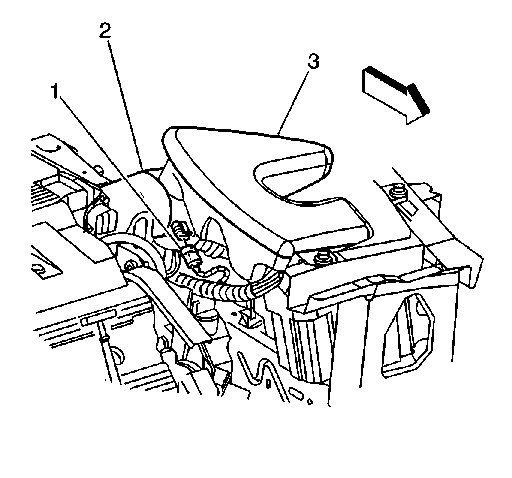

Next, you may want to consider cleaning the MAF sensor. Here is a link that shows in general how it is done.
https://www.2carpros.com/articles/mass-air-flow-service

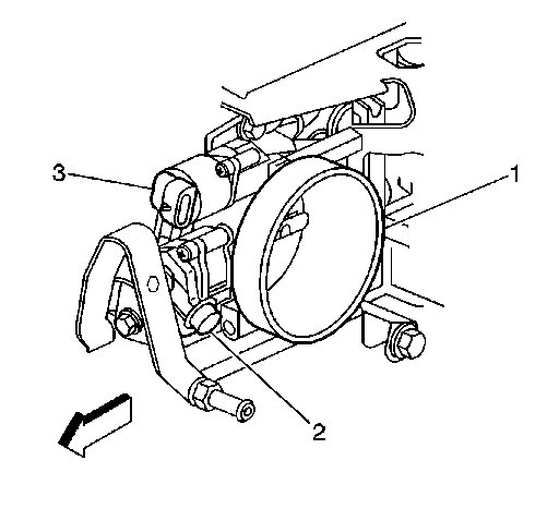

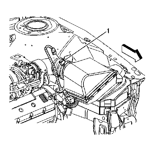

Picture 4 shows the MAF location.

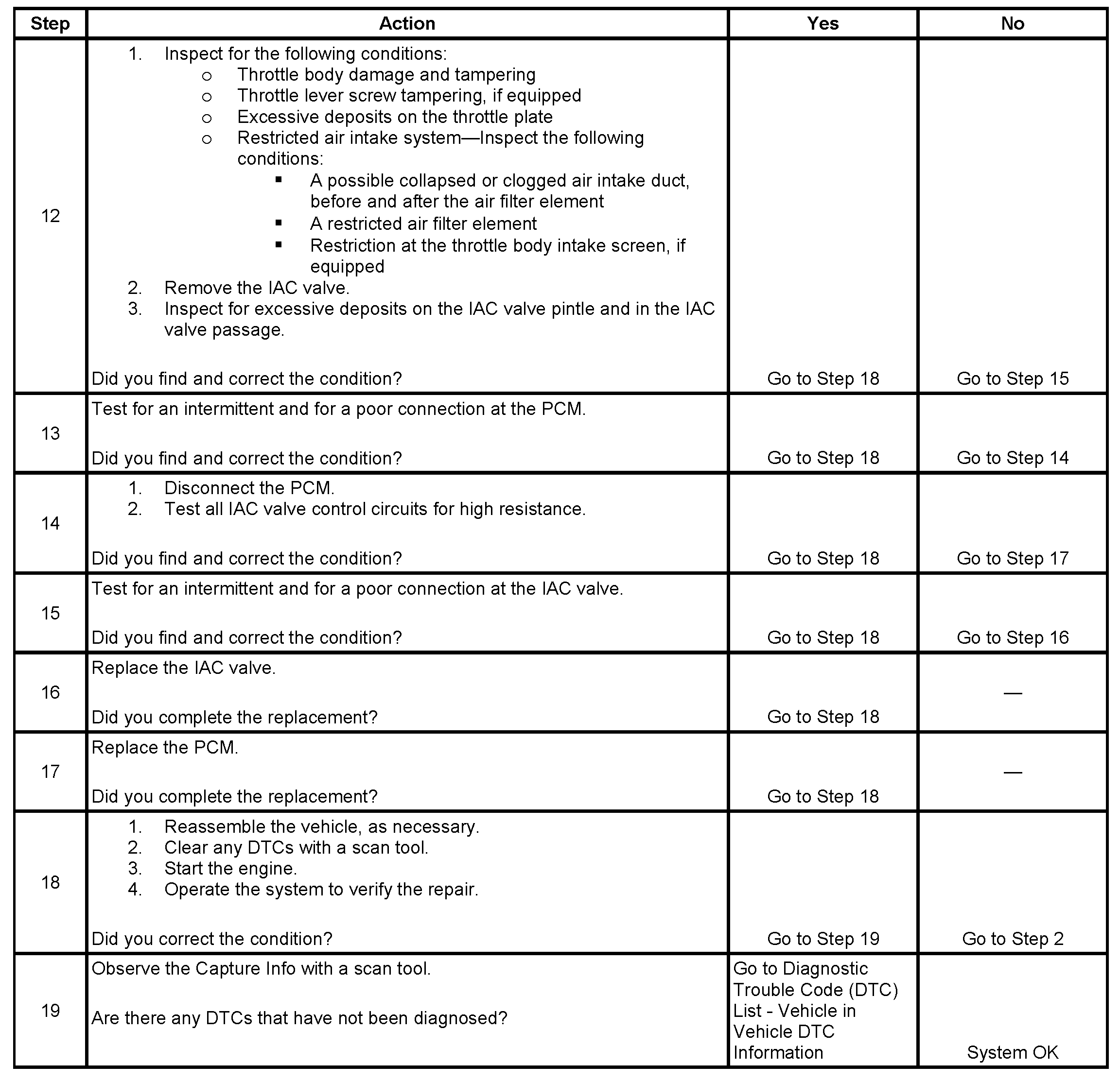

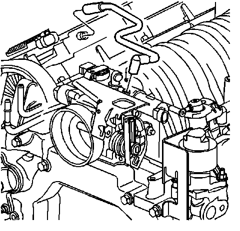

If nothing helps, then you will need to check the idle air control valve (IAC). The IAC is responsible for maintaining engine idle speed. Here are directions / flow chart for diagnosing a bad IAC. Before going to all the trouble of testing everything on the flow chart, remove the IAC and check it for carbon build up. Also, check where it goes into the throttle body to confirm nothing is blocked.
IDLE AIR CONTROL (IAC) SYSTEM DIAGNOSIS
CIRCUIT DESCRIPTION
The engine idle speed is controlled by the idle air control (IAC) valve. The IAC valve is on the throttle body. The IAC valve pintle moves in and out of an idle air passage bore to control air flow around the throttle plate. The IAC valve consists of a movable pintle, driven by a gear attached to an electric motor called a stepper motor. The stepper motor is capable of highly accurate rotation, or of movement, called steps. The stepper motor has 2 separate windings that are called coils. Each coil is supplied current by 2 circuits from the powertrain control module (PCM). When the PCM changes polarity of a coil, the stepper motor moves one step. The PCM uses a predetermined number of counts to determine the IAC pintle position. Observe IAC counts with a scan tool. The IAC counts will increment up or down as the PCM attempts to change the IAC valve pintle position. An IAC Reset will occur when the ignition key is turned OFF. First, the PCM will seat the IAC pintle in the idle air passage bore. Second, the PCM will retract the pintle a predetermined number of counts to allow for efficient engine start-up. If the engine idle speed is out of range for a calibrated period of time, an idle speed diagnostic trouble code (DTC) sets.

TEST DESCRIPTION

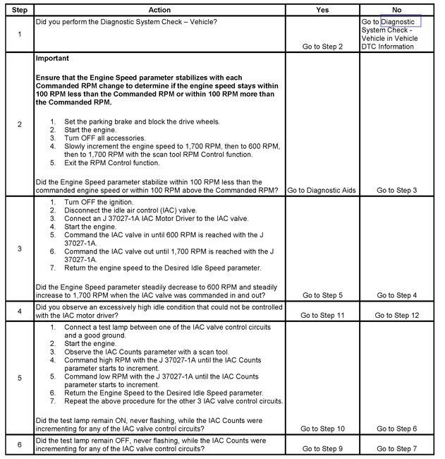

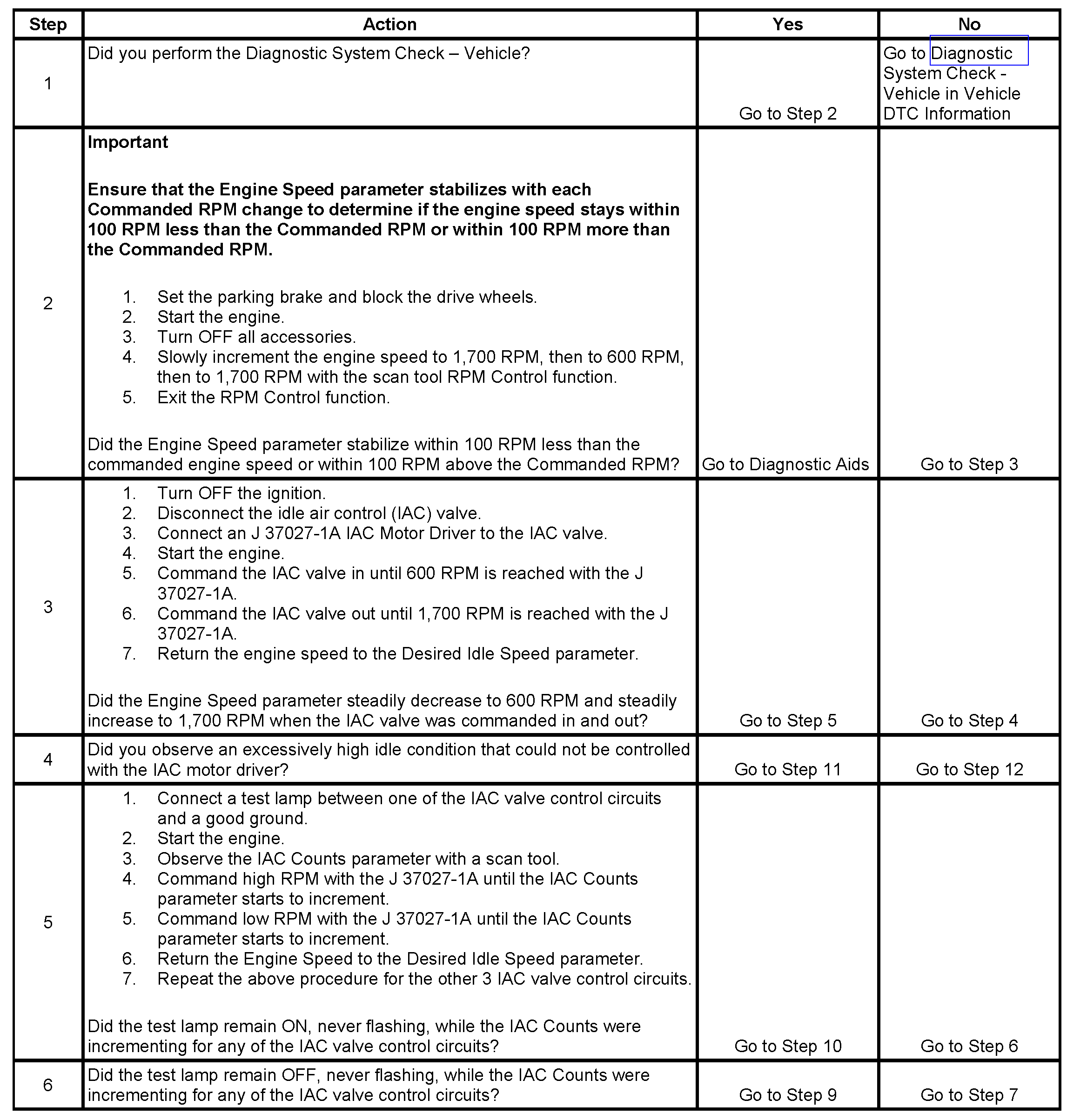

Steps 1 - 6
Picture 5

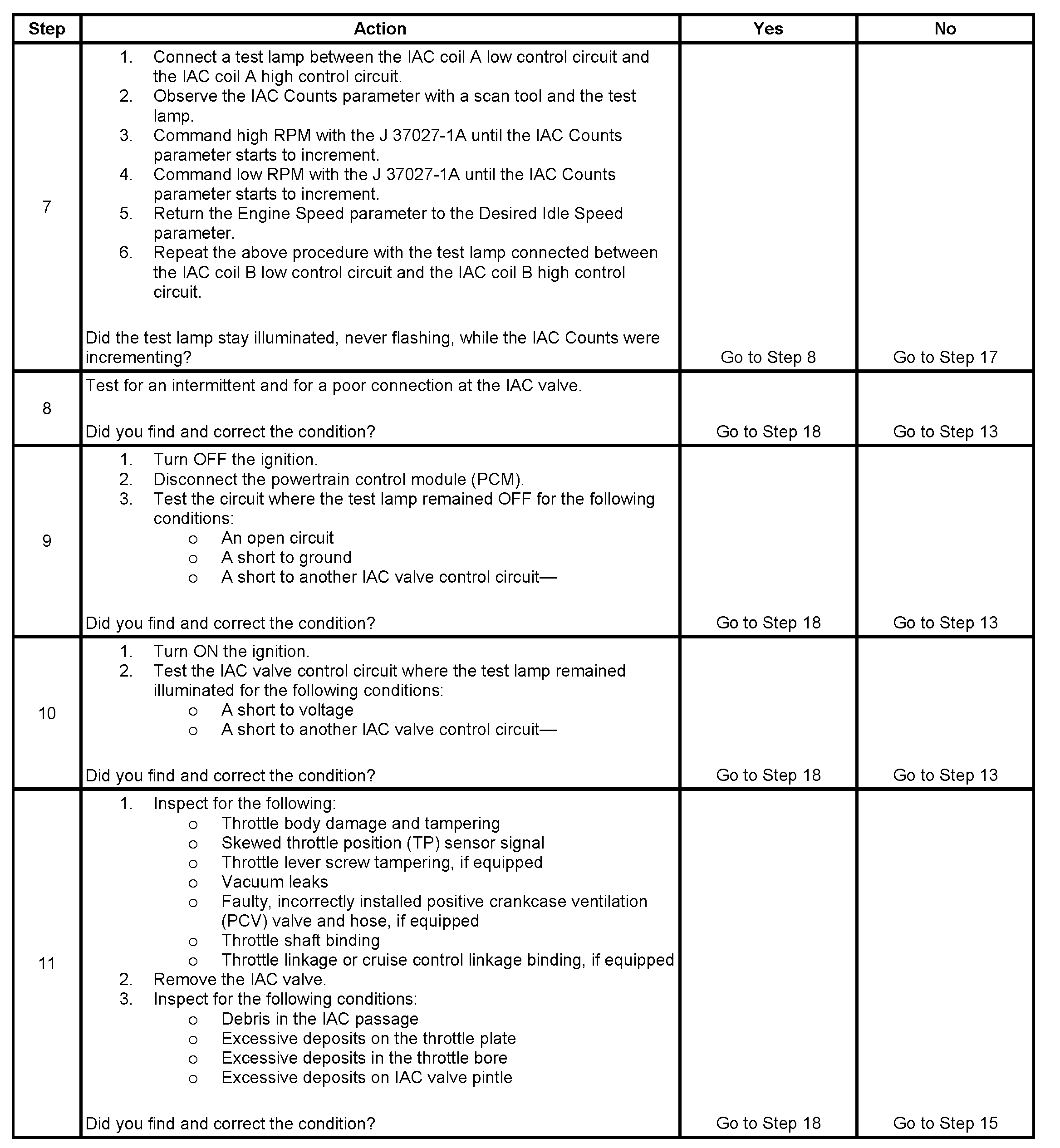

Steps 7 - 11
Picture 6
Steps 12 - 19
Pic 7
The numbers below refer to the step numbers on the diagnostic table.
5. This test will determine the ability of the PCM and IAC valve control circuits to control the IAC valve.
7. This test will determine the ability of the PCM to provide the IAC control valve circuits with a ground. On a normally operating system, the test lamp should not flash while the IAC Counts are incrementing.

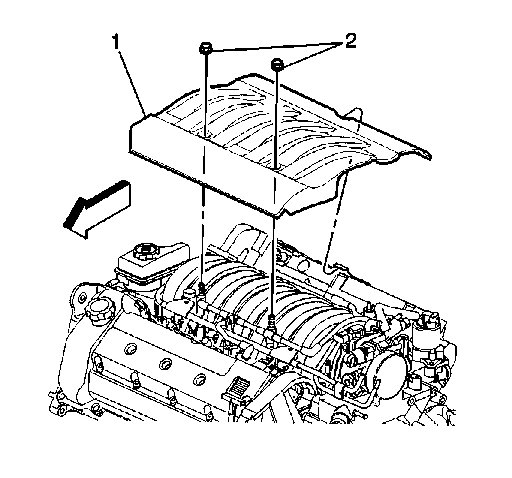

1. Remove the two nuts (2) from the fuel injector sight shield (1).
2. Lift the sight shield (1) from the front and pull forward to disengage the rear tab from the bracket.

3. Disconnect the PCV fresh air tube from the left camshaft cover.
4. Remove the PCV fresh air tube from the throttle body.

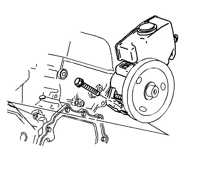

6. Remove the power steering pump retaining bolt.
7. With the hoses still attached, Carefully position aside the power steering pump.

4. Place the power steering pump in position in the engine valley. Slide the molded wedge into the retaining feature cast into the cylinder block.
Notice: Refer to Fastener Notice in Service Precautions.
5. Install the power steering pump retaining bolt.
Tighten the power steering pump retaining bolt to 50 Nm (37 lb ft).
