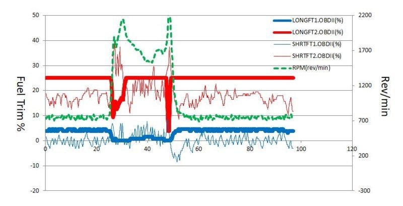

Fourth thing: bought a Bluetooth OBDII scanner (amazon, BAFX scanner) and loaded FORScan on a laptop – maybe it doesn’t take much, but I’m really impressed with what one can do with $23 and free software!
-scans show long term and short term fuel trim on Bank 1 to be +/- 5% - and stay that way as a crank RPMs up
-scans show long term and short term fuel trim on Bank 2 to be very high, LTFT2 pegged at 25%, STFT2 near 20%, and increases with higher RPMs
-data looks something like the attached image

Sixth thing: scan again. STFT2 and LTFT2 still high. Bank2 is high with what was bank 1’s injectors. So I think I can say the injectors are okay?
