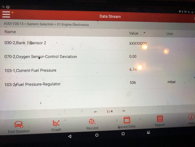

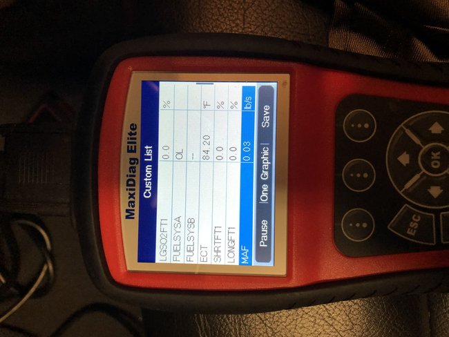

Here are few readings after i cleared the codes, smooth after she is warm. With regard to the vacuum pump in back of motor, the hose that goes to it which connects to the little nipple has some free play, if i pull it out and in while car is running there is play and the motor quiets down because when cold she goes in and out few millimeters on its own making like a pinging sound, and this maybe why the brake pedal was once or twice hard as she connects to the booster i believe, the hose going to the booster also has a small crack so taped it for now to see.

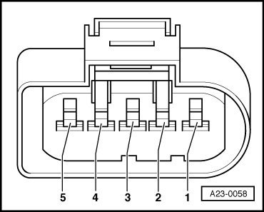

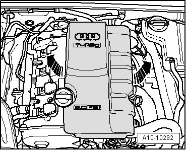

- Remove engine cover - arrows -.
pic 1

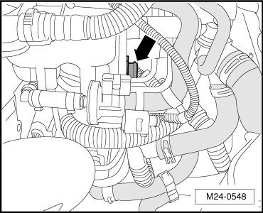

- Disconnect the Intake Flap Motor (V157)/Intake Manifold Runner Position Sensor (G336) electrical harness connector - arrow -.
pic 2
- Switch the ignition on.

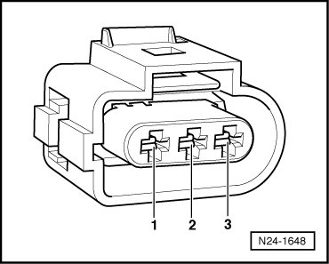

- Using a multimeter, check the Intake Flap Motor (V157)/Intake Manifold Runner Position Sensor (G336) electrical harness connector terminals 1 to 3 for voltage.
pic 3
Specified value: about 5 V

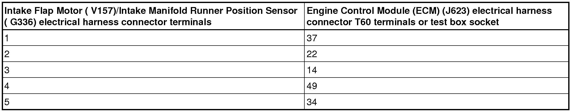

- Remove the Engine Control Module (ECM) (J623). Refer to => [ Engine Control Module, Replacing ] See: Engine Control Module > Removal and Replacement > Engine Control Module, Replacing.

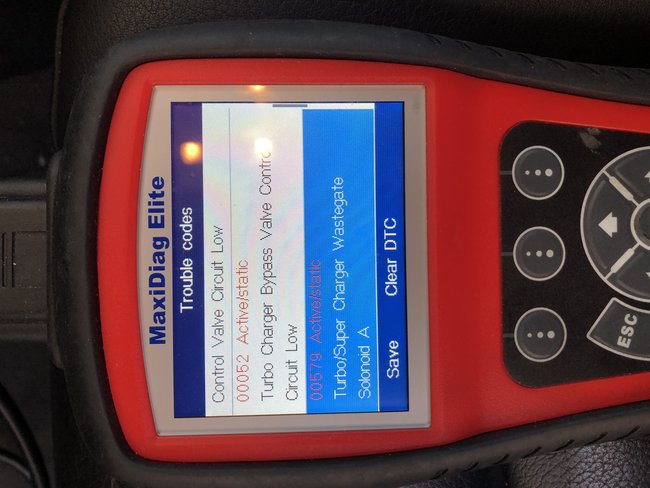

- Using a Multimeter, check the Intake Flap Motor ( V157)/Intake Manifold Runner Position Sensor ( G336) electrical harness connector terminals to the Engine Control Module (ECM) (J623) electrical harness connector T60 terminals for resistance.
pic 4
Specified value: 1.5 ohms Max.

Checked the intake flap motor harness and it shows 4.95 volts, so is it possible the motor it self is bad? I moved the arm of the motor by hand and it moves, plus i don't see any codes for the intake flap runner, are you pretty certain this points to the motor?

I'm starting to run out of thoughts. Have you checked fuel trims when it is first started and you experience the issue?
Oct 16, 2019 at 6:23 PM
NASER NASER
  • 836 POSTS

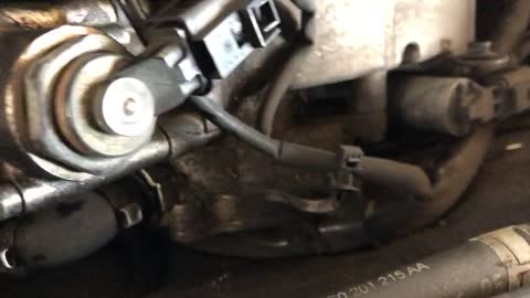

i can send you the fuel trims tomorrow? because that is something i do not understand. car just had another high pressure fuel pump installed from another car.. also found one of the PCV hoses split so i taped it for one not to allow any vacuum. not sure if this is how it was or broke while replacing the pump.
Oct 16, 2019 at 6:25 PM
The broken hose can be your issue. As far as fuel trims, they need to be as close to 0 as possible. If the trim is in the positive range, the fuel mixture is lean and the comp is adding fuel to compensate. If the trims are in the negative range, the mixture is rich and the comp is trying to remove fuel from the engine. As you already know, a lean or rich fuel mixture can be only caused by so many different things. So, based on the readings, those are the things needing checked.
That is just a general idea of how it works. It can become much more involved, but I'm just trying to help you understand. Hope it helps.
Let me know what they are when the problem is happening. It has to be then because the engine is running in a closed loop before it reaches a specific temperature. It may be very helpful.

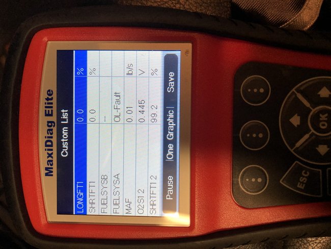

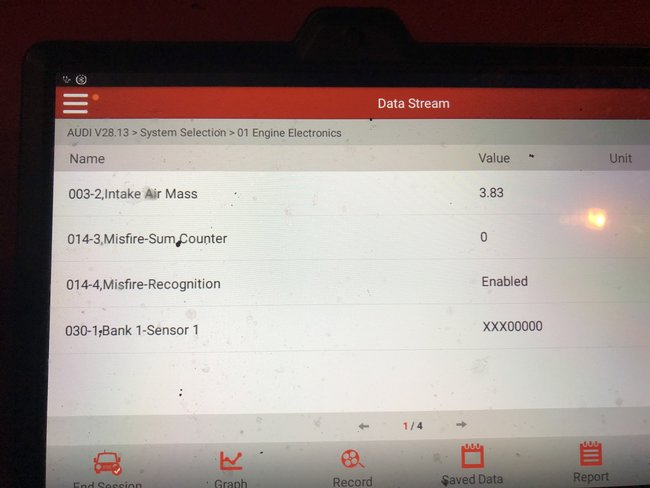

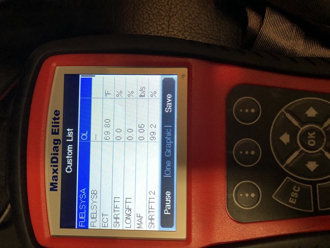

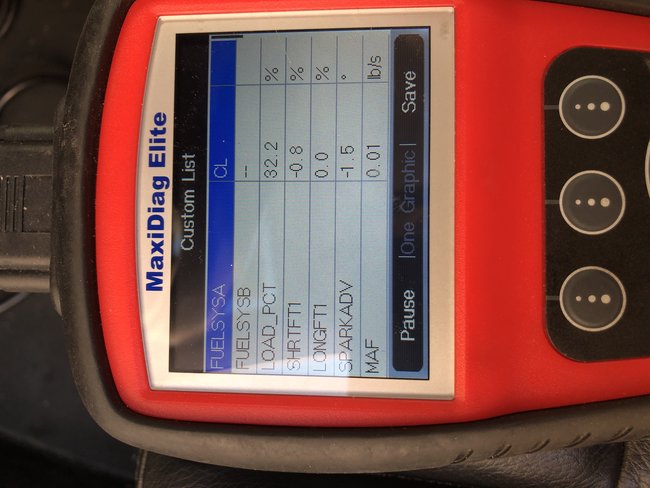

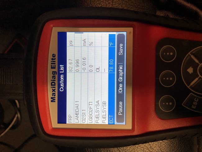

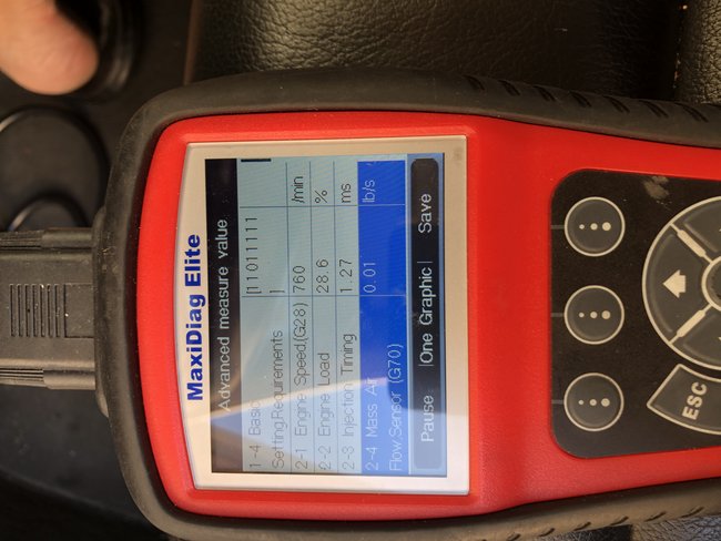

Take a while to start. but here is what i have first when i first started and foot on the gas so she wont stall.
Oct 17, 2019 at 6:24 AM
NASER NASER
  • 836 POSTS

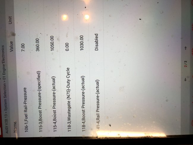

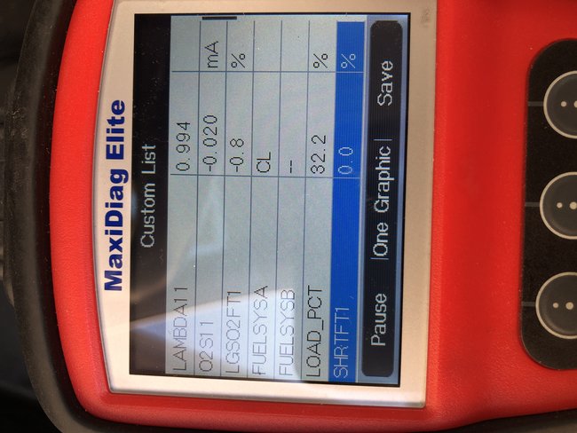

This is after a minute or so after the rom stabilized and engine can run without me stepping on the gas.
Oct 17, 2019 at 6:25 AM
Welcome back:
The STFT are not present on the scanner. Does it change when it warms up?
Oct 17, 2019 at 7:00 PM

I cannot seem to find any of the fuel trims on the scanner, it is no where to be found.

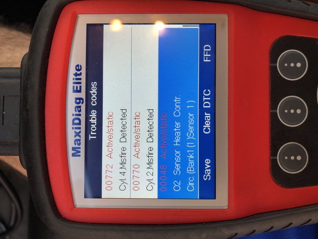

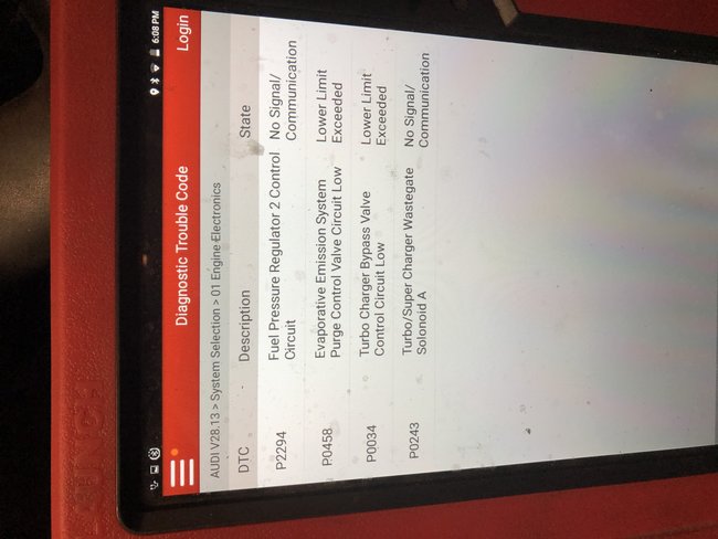

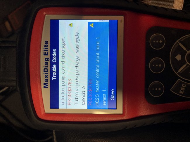

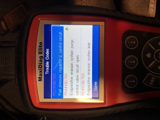

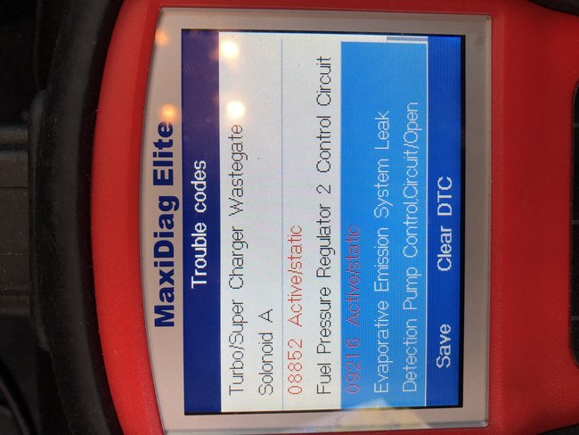

Replaced that broken PCV hose, delete all the codes but 4 stay and never go away and the EPC light never goes off, hard to start about 3 times of turning over before it fires up. but did start today with no stalling. codes are in the picture. removed the sensor in the turno yesterday and it looks good and clean and clicks when i press the little nipple. There was oil though in the hose that is on the bottom of the turbo from bottom, about half quart or so not sure if normal. And starting to lean towards the turbo or carbon build up. what do you think?
Oct 19, 2019 at 4:12 PM
Looking at the codes, there are several things that can be causing the issue. The hard start really leads me to believe there is a fuel pressure issue and one of the codes indicates an issue with the regulator. Additionally, the EVAP code can be causing a rough idle.
At this point, I would pick one thing at a time and focus on it, specifically the fuel pressure concerns.
Let me know if I can help.
Oct 19, 2019 at 5:17 PM

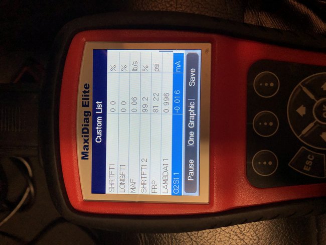

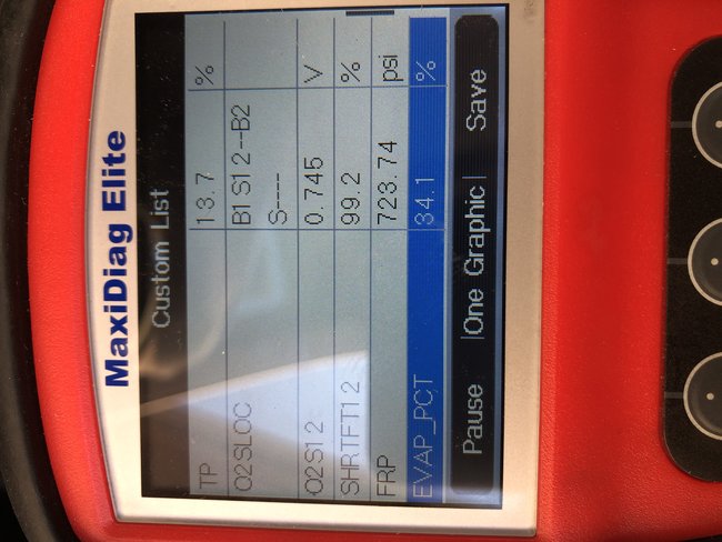

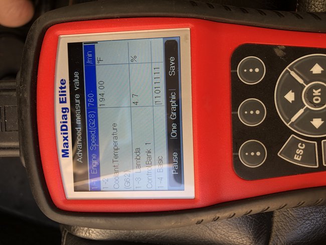

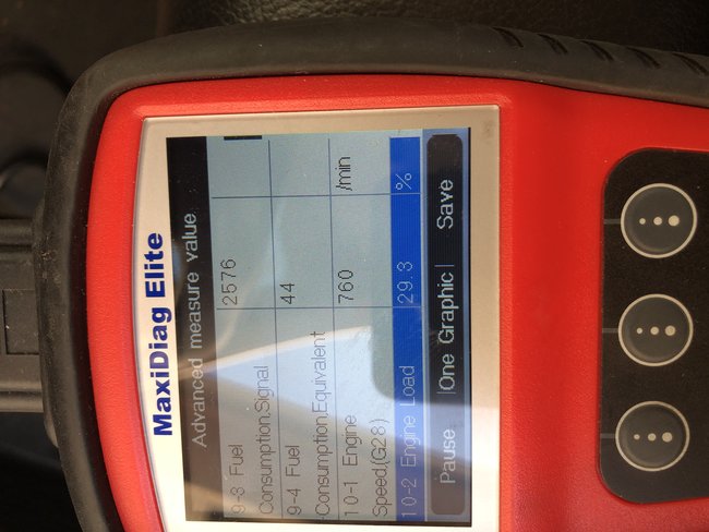

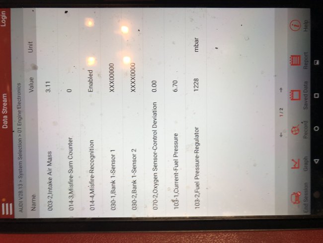

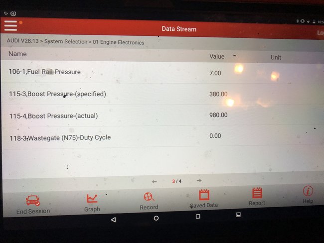

These are some data from when the car is cold. When the gas pedal is pressed the intake flap arm moves. Again it is a long crank and for few seconds it is idling rough then stabilizes. Can you see if you can spot anything from these data when cold and I will send another set when warm. also in this picture here is before and after i press the gas to boost the turbo.
Oct 29, 2019 at 9:03 AM
NASER NASER
  • 836 POSTS

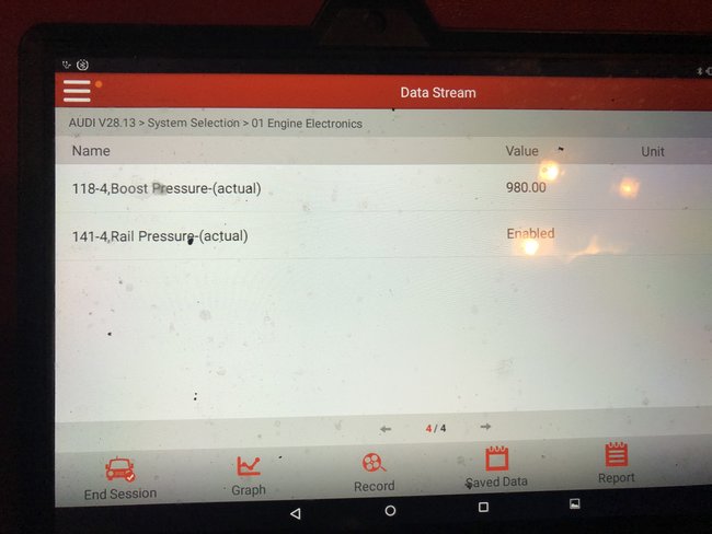

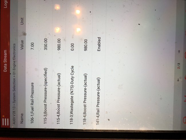

These after she is warm. I checked the connections at the turbo, the evap, and hpfp and all are good.

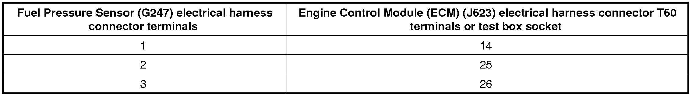

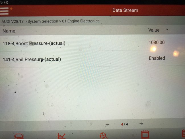

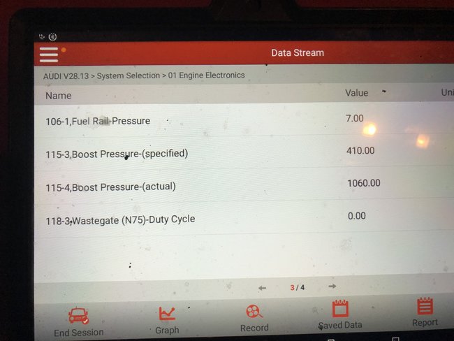

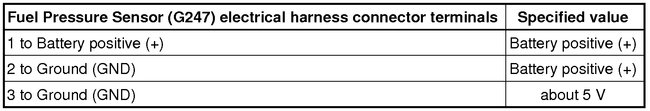

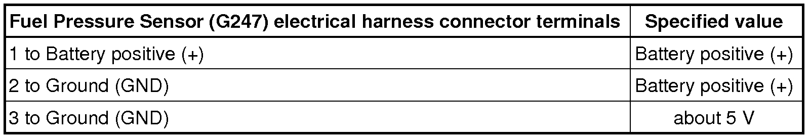

can you please tell me how much voltage i should be getting from the number 2 fuel sensor which is in the HPFP?
Oct 29, 2019 at 5:26 PM
Welcome back:
I believe I got what you are looking for. I attached 4 pictures below. Let me know if that is what was needed.
Oct 30, 2019 at 5:34 PM
