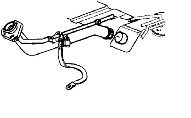

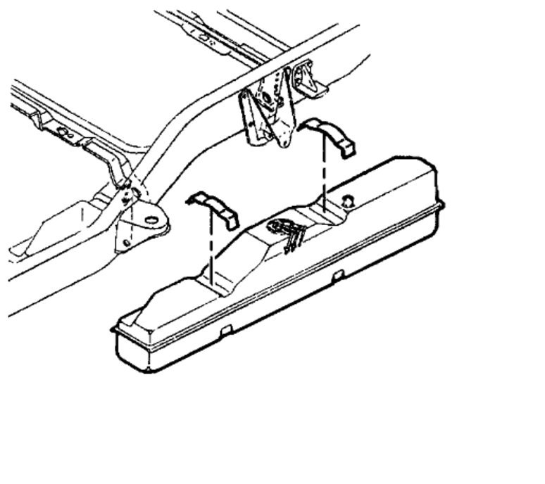

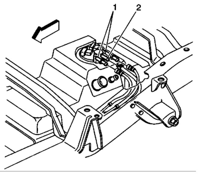

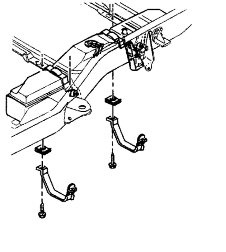

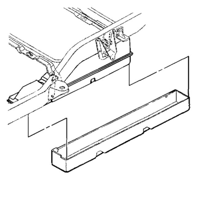

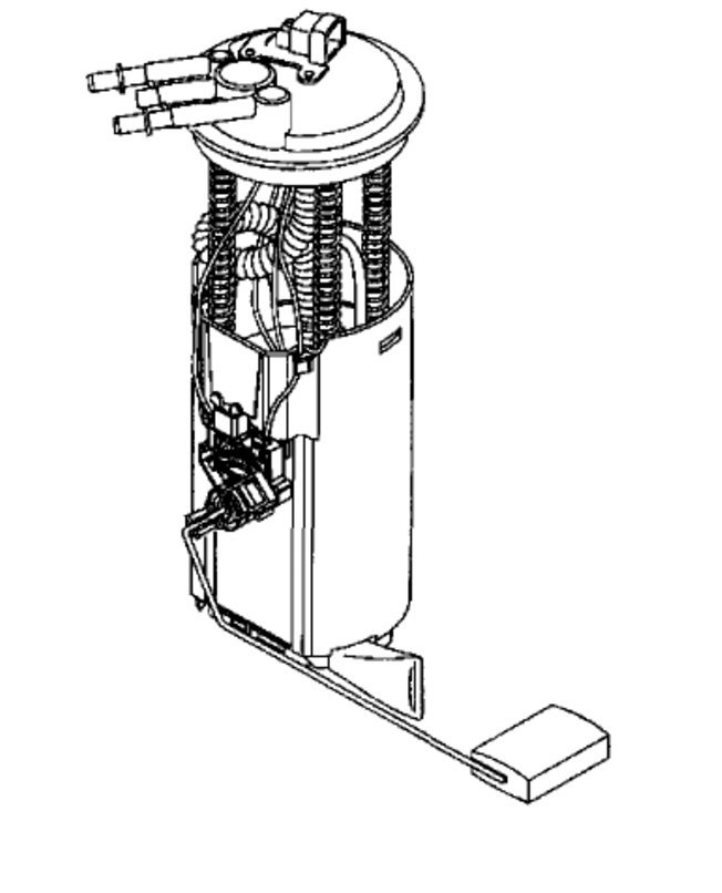

Here are some guides and some diagrams (below) to help you get the job done:
and
and
