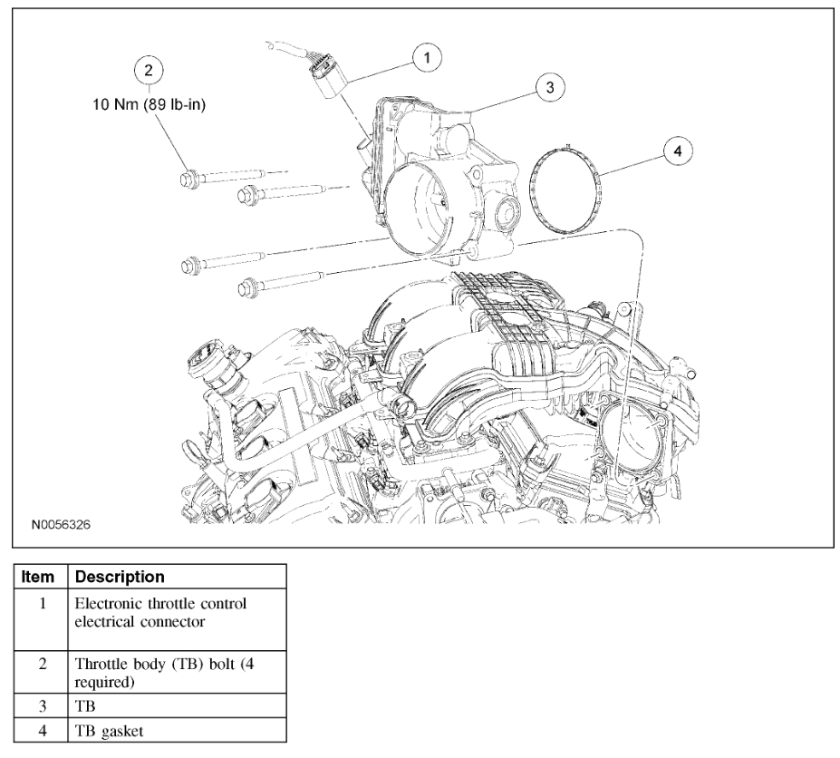

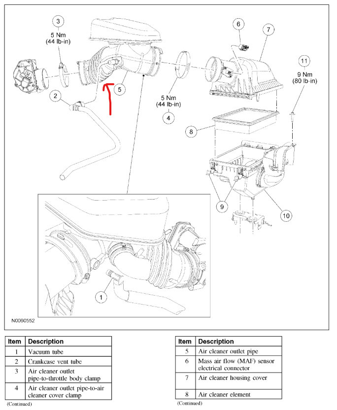

It sounds like you have a leak between the throttle body and the MAF sensor. Here is an image of what I would check for tears or holes, also make sure it is securely on the air filter housing which is where the MAF sensor is. Also, do you have a check engine light on? If so, we should run the codes.
Also, I would service the throttle body if that has not been down recently.
