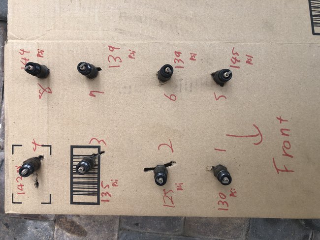

The first place to start would be the spark plugs as they tell a lot about the engine. If they are black then first thing I would check would be the fuel pressure regulator, it is on the fuel rail and has a red plastic vacuum line going to it (assuming it hasn't been replaced), if you hook your vacuum pump up to the regulator it should hold vacuum but before you do that check and make sure there isn't gas coming out of the port on the regulator.
