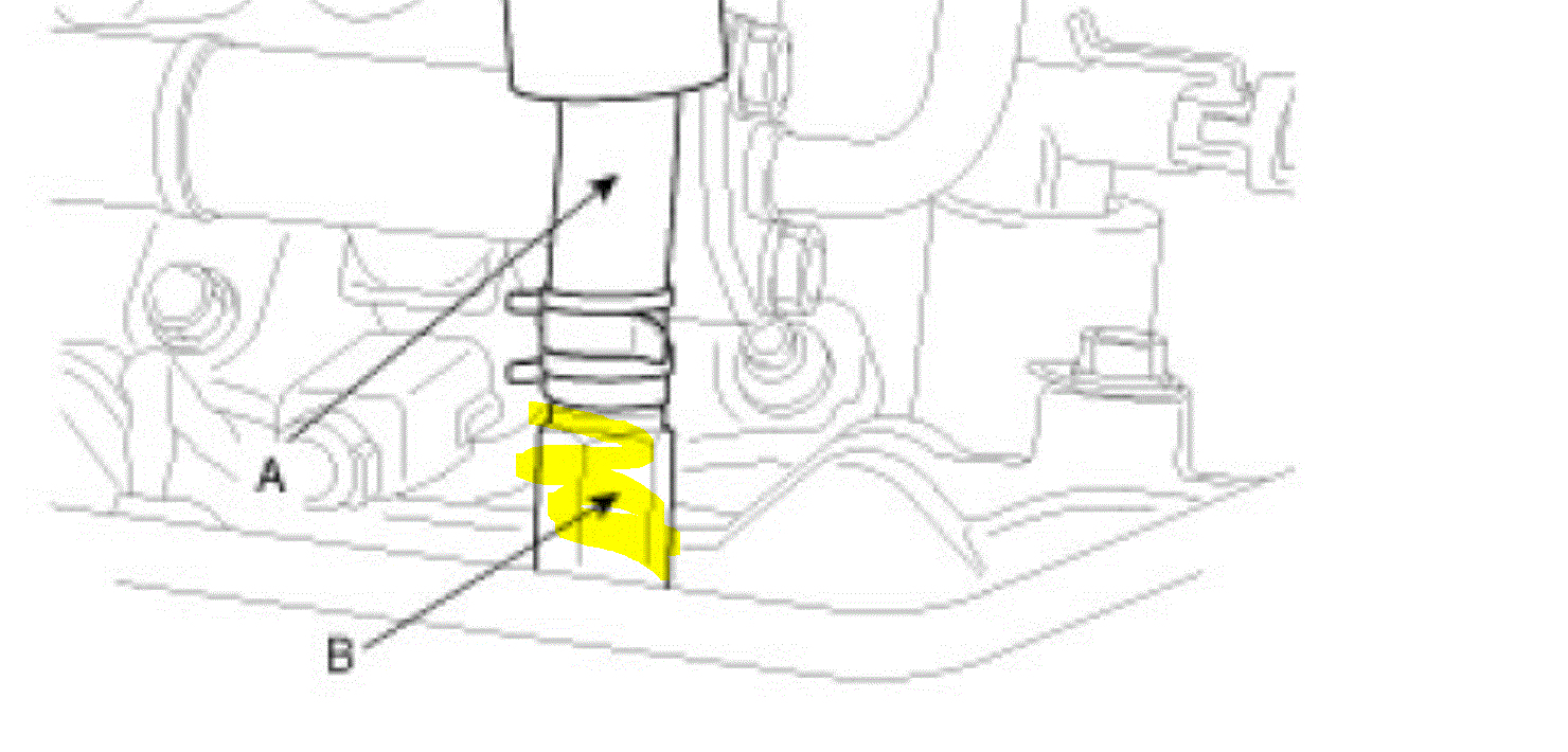

It sounds like there is an issue with a vacuum leak. The P2189 deals with the PCV. That could create a big enough leak to cause the problem.

I attached a pic of the PCV and highlighted it.

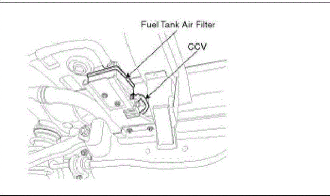

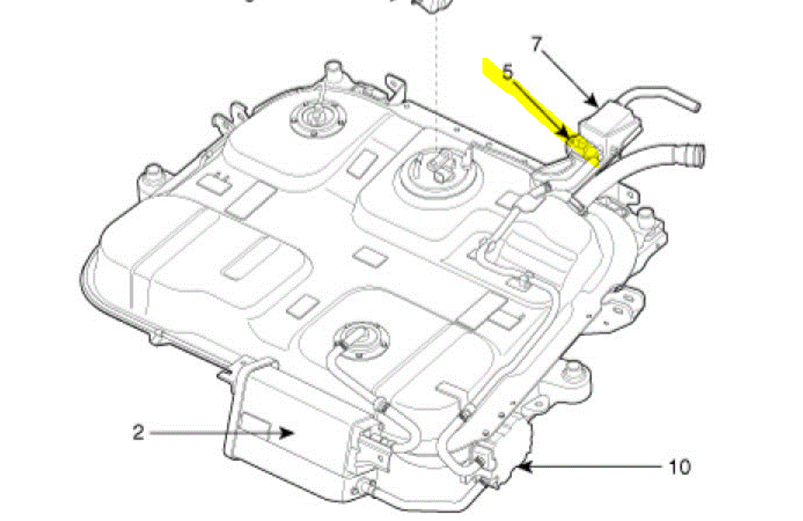

The code deals with the canister close valve (CCV). It is near the fuel tank. I attached two pics below to help you find it. First, locate the valve and then follow these directions for diagnostics.

Let me know what you find.
