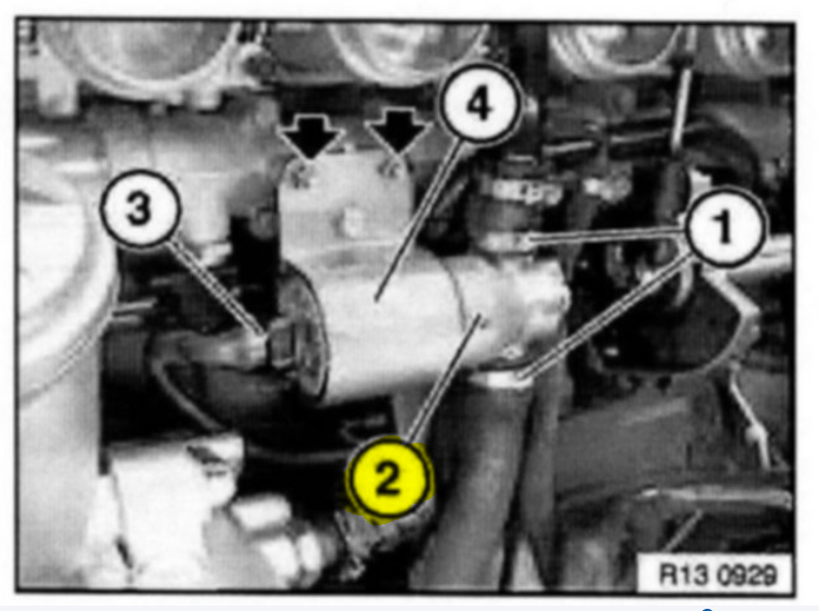

Also, there is an idle speed control valve under the intake that may be causing issues. I attached a pic of it below. However, this will usually set a code.
Let me know as much as you can.
See pic below.
