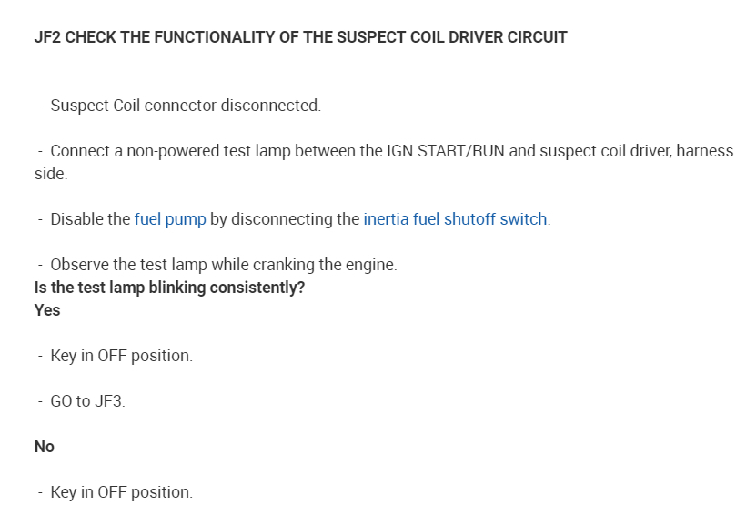

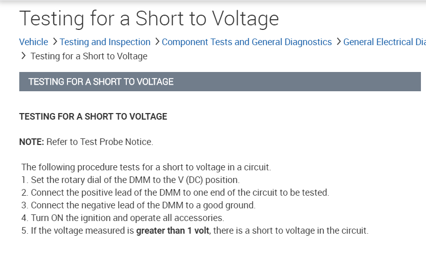

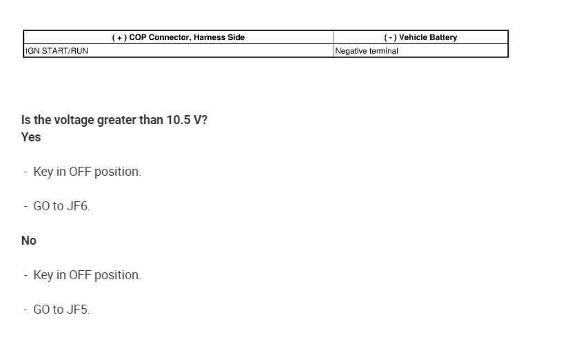

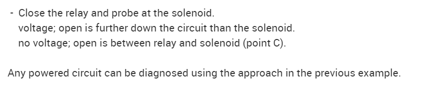

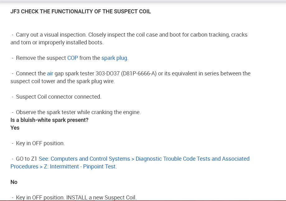

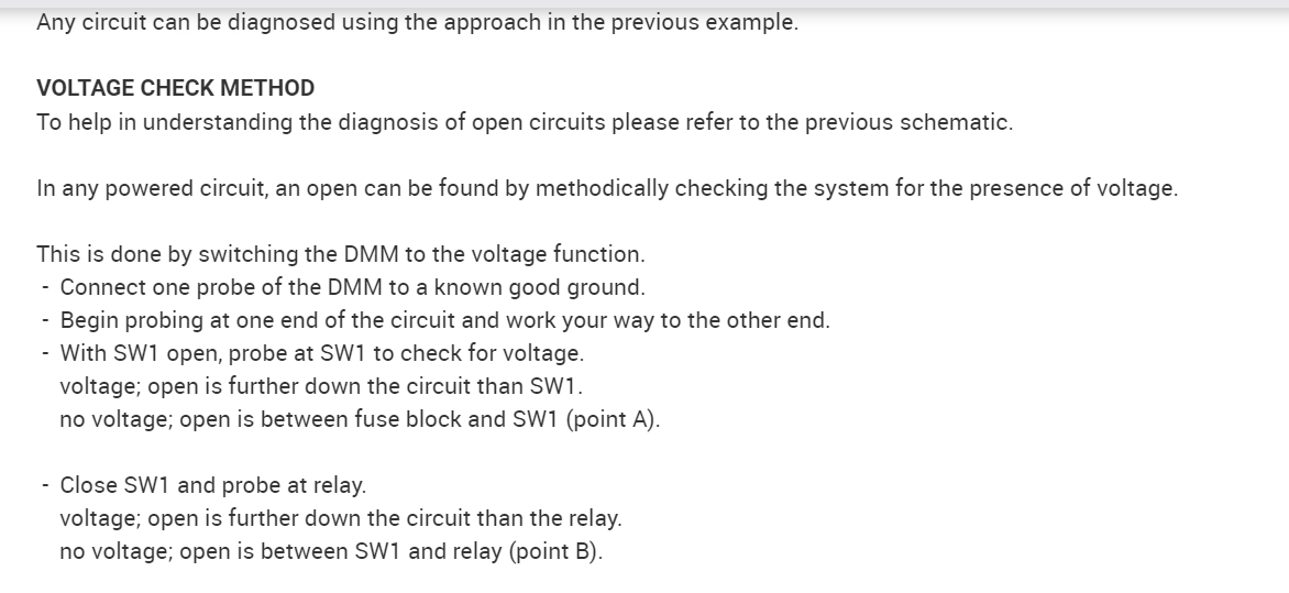

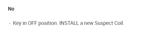

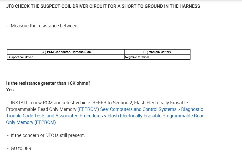

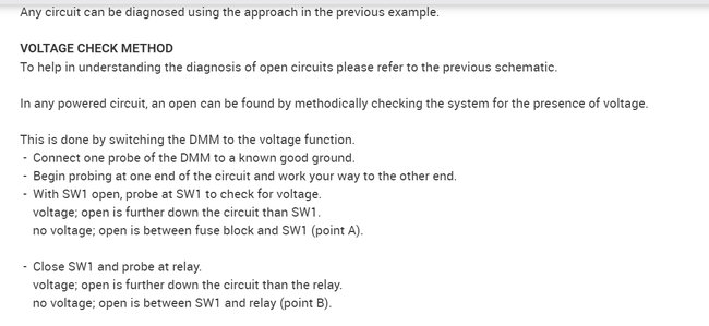

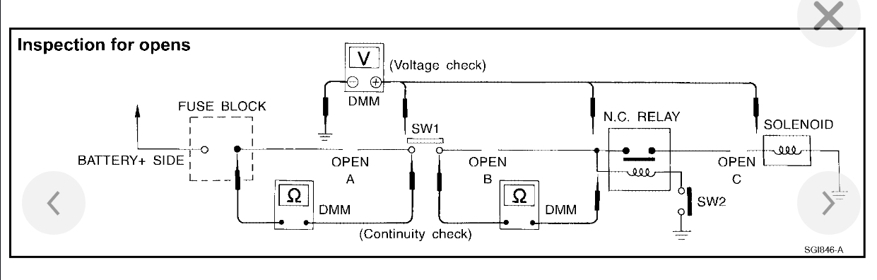

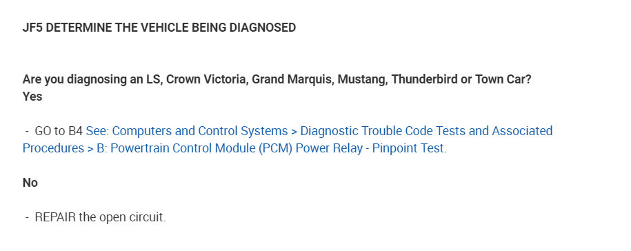

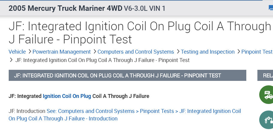

A scan tool shows a code of p0353. A visual inspection found numerous vacuum leaks. So far have gone through and replaced on all six cylinders plugs, coil pack, upper and lower intake gaskets, EGR gasket,cleaned injectors and replaced o-rings. Also has popping sound. More frequent under load than idle.
