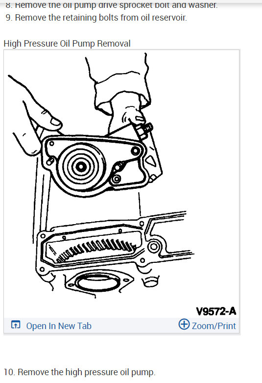

I just recently replaced the IPR valve and ICP sensor and I am getting 2 DTCs P1284 and P1211. It will start up right away and run fine for about 5 seconds then the check engine light pops on and starts to run really rough. And when you touch the gas pedal it will go from about 500 RPMs to over 1,500 instantly even if you slightly touch it. Could there be air in the system still?

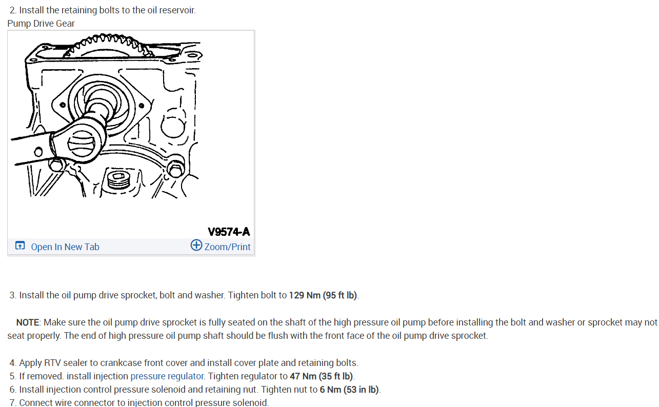

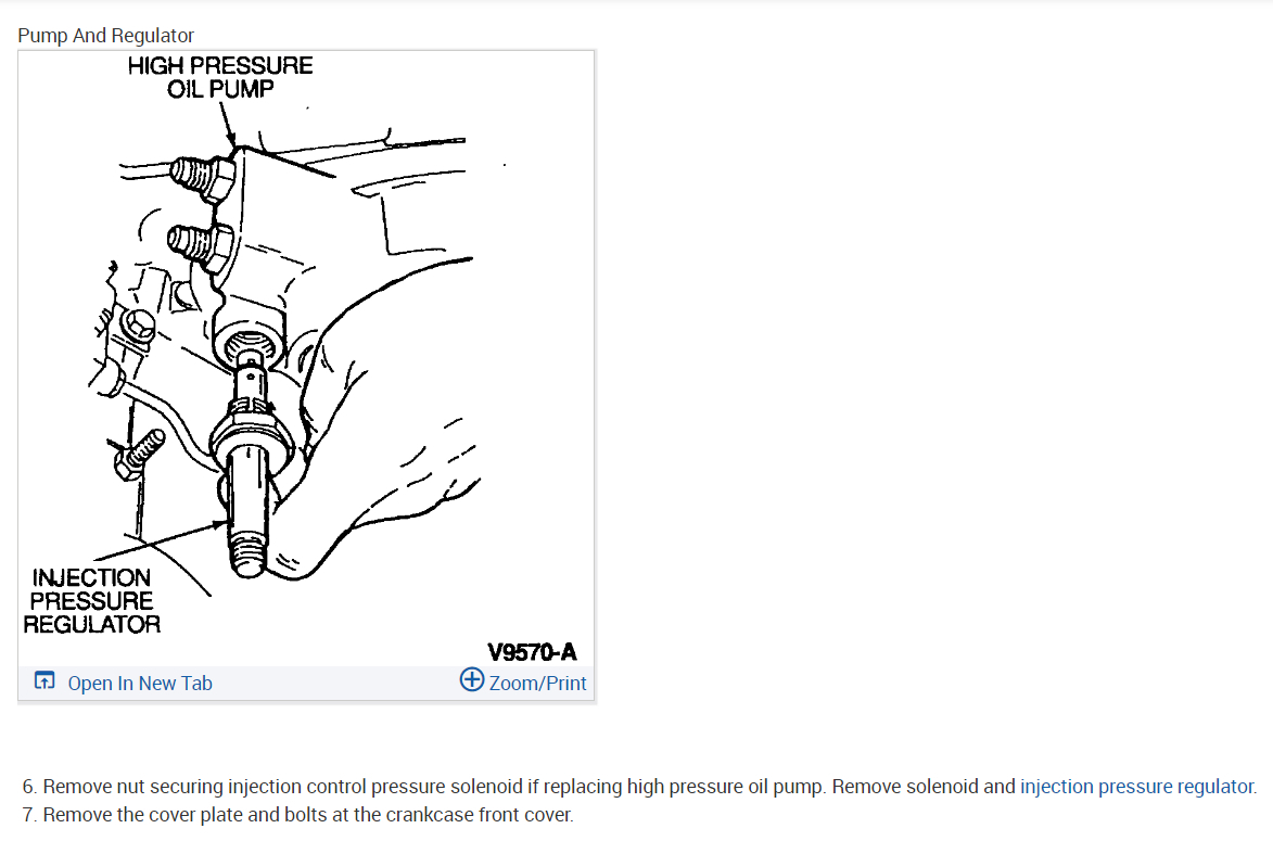

Changes ae the high-pressure oil pump has gone out, does the engine have the correct amount of oil in it? If so, then suspect the HPOP. Low oil level or insufficient oil pressure.
High-pressure oil pump issues.
P1284 - ICP (Injection Control Pressure) Circuit Low
P1211 - ICP (Injection Control Pressure) Not Controllable / Pressure Above or Below Desired

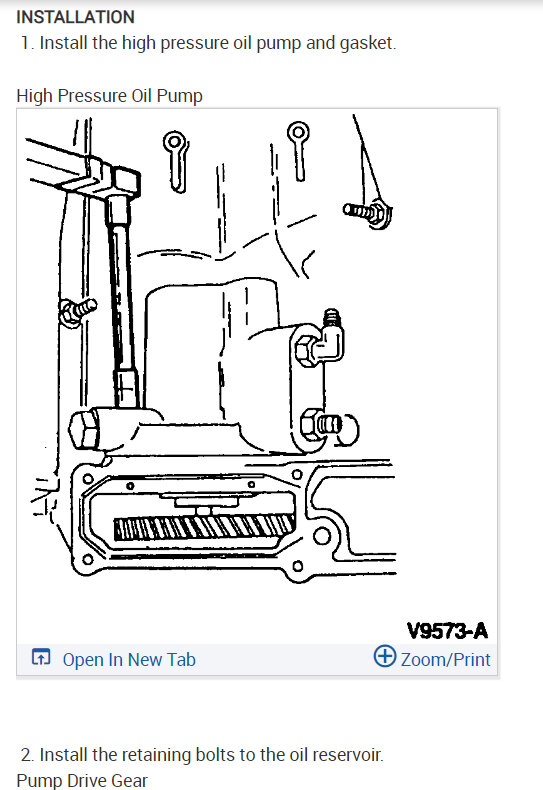

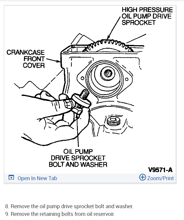

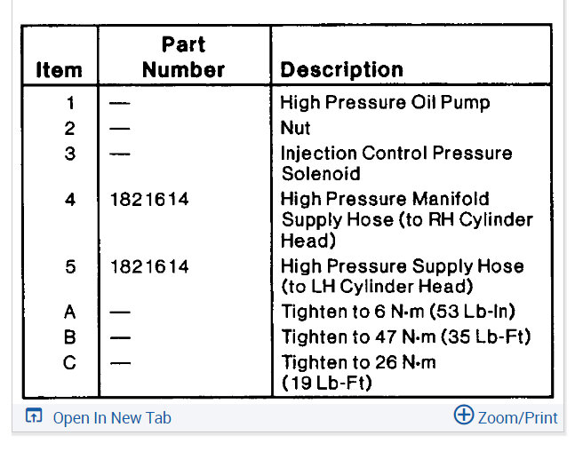

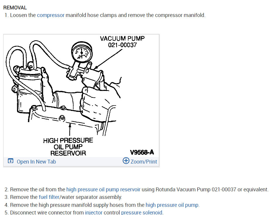

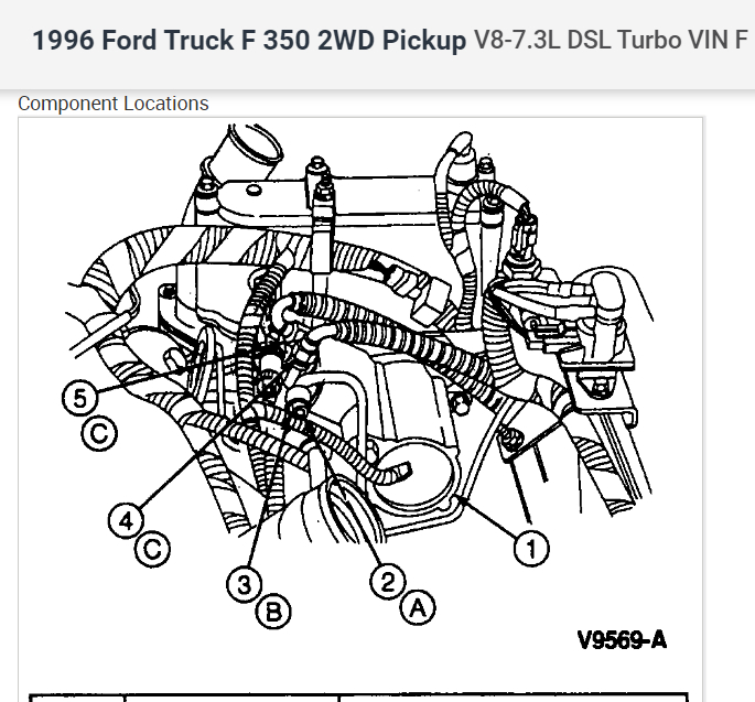

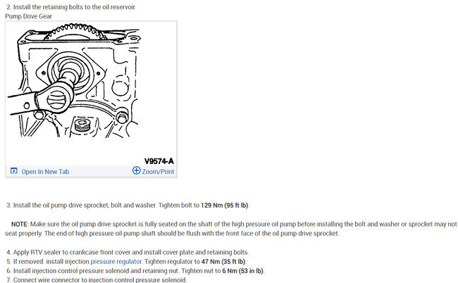

Here is how to change the HPOP out which should fix the problem. Check out the images (below). Please let us know what happens.
