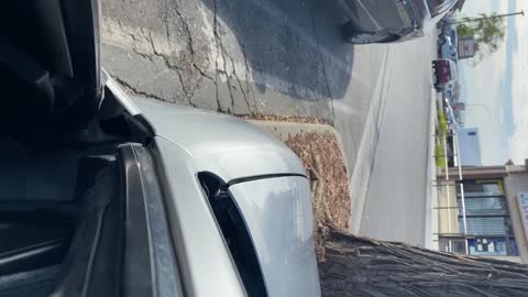

I recently changed the sparkplugs like 2 months ago so theyre fairly new.In the video you can hear me revving it a bit and then it sounds like it wants to turn off but comes back up.

Thanks for the video. It does sounds like thing is wrong with the timing belt/tensioner but if you could get a video of the front of the engine under the hood I can tell for sure. Also how many miles are on the engine? you said 99k but I wanted to be sure it makes a difference.
