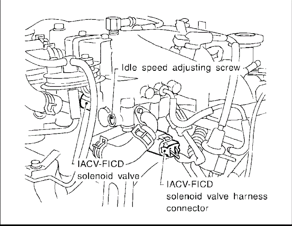

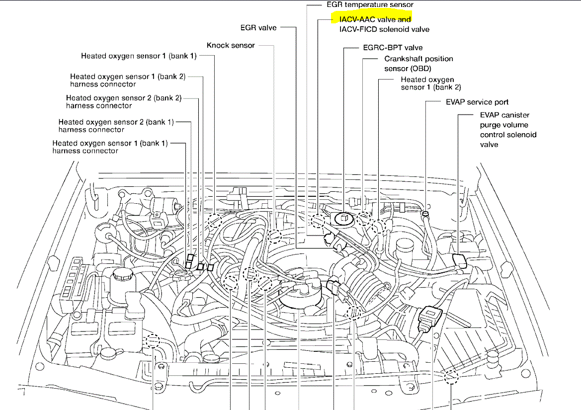

Now, I attached two pics below to help you locate the component. Locate it and inspect wiring to it first. Next, remove it and inspect it for dirt or damage. Here are a couple general links you may find helpful:

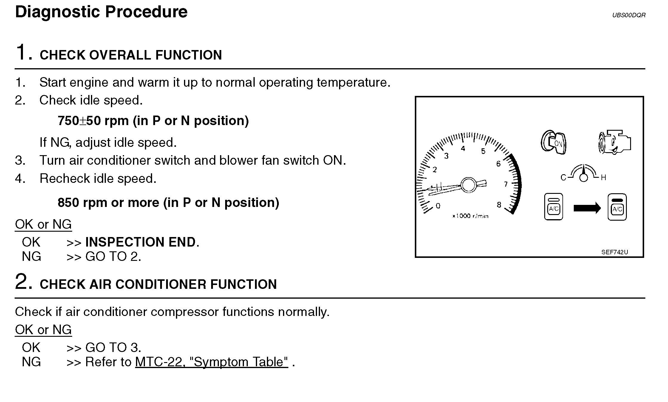

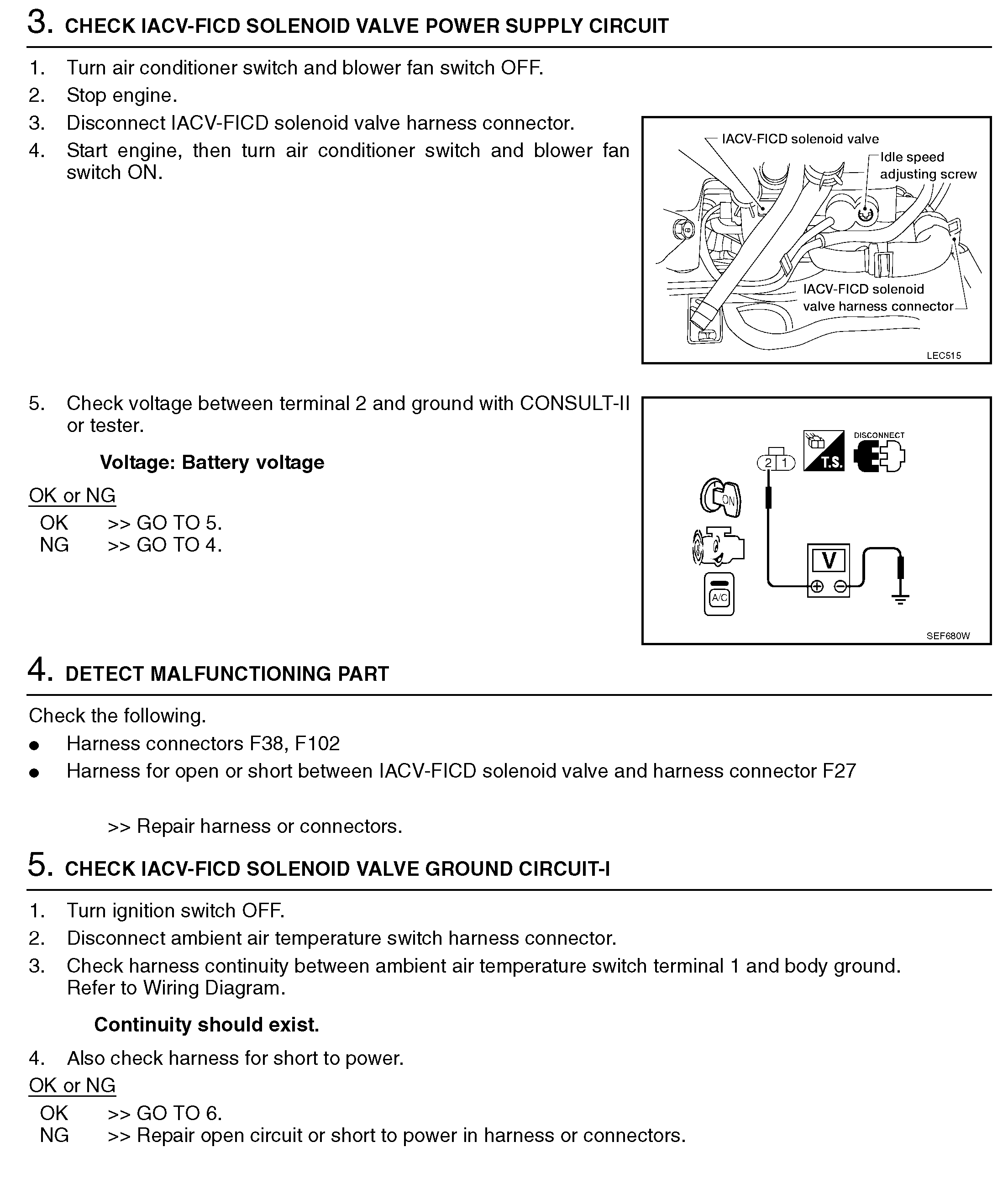

I don't know how handy you are, but here are the directions for checking the part in question. The remaining pics include the directions.
Here are a few links you may find helpful when testing:
Let me know if this helps. Also, feel free to let me know if you need help or have other questions.
