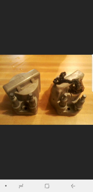

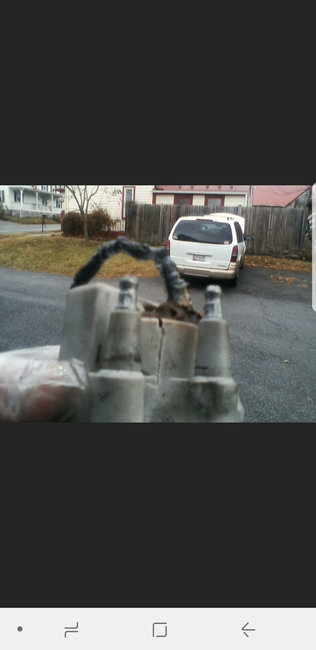

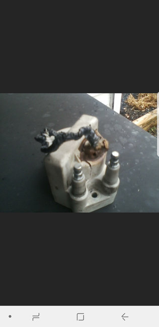

So far-we checked the wires to the starter and nothing. So we tore the dash apart checking the wires on the inside and outside. We did find in the 2 air filters in the glove compartment for the central air that a mouse has been trying to build a nest LOL so we have to replace those. We then popped the hood again and started looking. I found (see attached pictures) that one of the coil paks had oozed out this black plastic stuff and had been cracked. The horrific smell actually came from the spark plug wires. (WIRES) The one end of the spark plug wire snapped to the coil pak terminal; it was what smelt horrific. I changed all 3 coil paks and 2 spark plug wires. It seems to still run the same when I reeve the engine up. What would cause the coil pak to do that?

Mice are always a pain. The most common reason a coil does that is a bad driver circuit that keeps the coil ON instead of pulsing it. Next would be a bad plug wire or plug that doesn't spark. The energy in the coil tries to find another path to ground and cooks it. In your case the second one is more likely to be what killed the coil. I would pull all the plugs and check the gaps, then test the wires to be sure they are all good.
Also check the wiring to the ICM and be sure it is grounded very well. Then can cause this issue if they fail.
