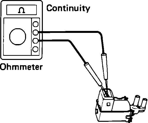

1. Disconnect and remove the VSV from the engine.

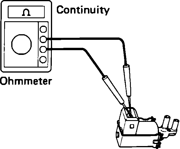

2. Using an Ohmmeter, check the resistance between the terminals.
Testing VSV For Open Circuit
pic 1
RESISTANCE (COLD): 33 - 39 ohms

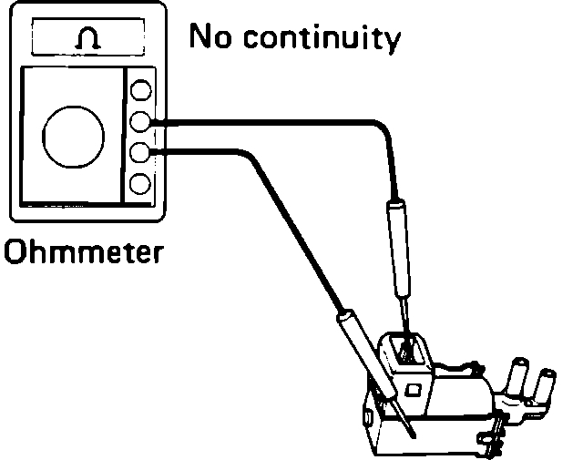

3. Check for continuity between the case and either terminal.
Testing VSV For Short Circuit
Pic 2
4. If windings are grounded to case or terminal resistance is not as specified, replace the VSV.

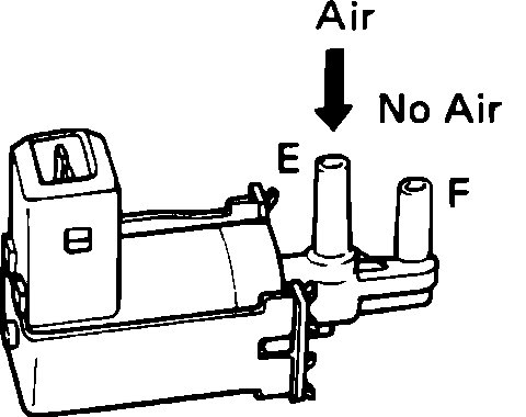

5. Blow through pipe E and check that NO air flows from pipe F.
Testing VSV Operation - Current Removed
pic 3

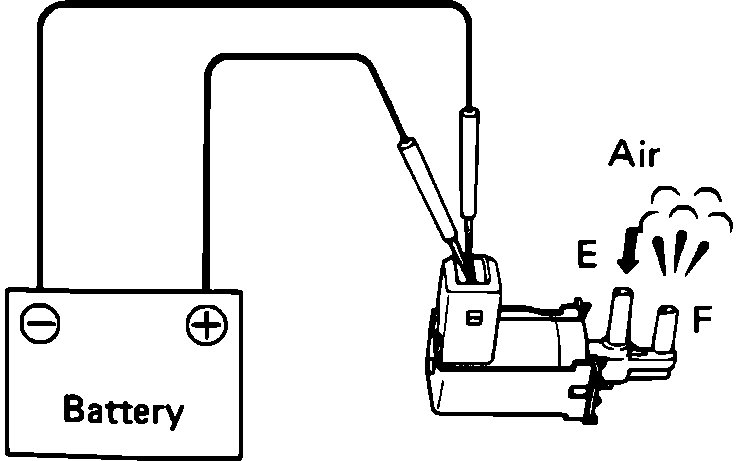

6. Apply battery current to the VSV and check that air flows through pipe E and F.
Testing VSV Operation - Current Applied
pic 4

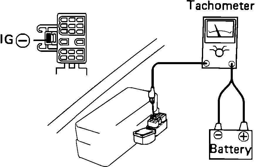

Tachometer Hookup
pic 5

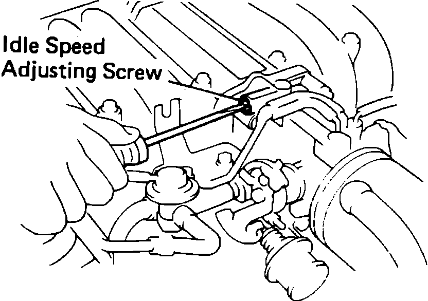

Fig. 213 Idle Speed Adjusting Screw
pic 6

2. Connect a tachometer to the engine, Fig. 211
NOTE: Never allow the tachometer terminal to contact a ground as this could cause damage to the ignition system. Some tachometers are not compatible with this ignition system, so please confirm the compatibility of your tachometer before connecting it to vehicle.

4. Set the idle speed by turning the idle speed adjustment screw, Fig. 213.
IDLE SPEED: 800 rpm
