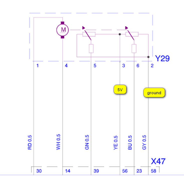

See image 1 below for the pin out from TPS to the ECM connector X47.

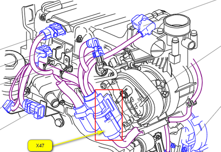

See image 3 for X47 location.

Testing
Ignition off
Disconnect the connector at the TPS, see image 2
Connect voltmeter probe to pin 2 and other to battery ground terminal
Check that the resistance is less than 10ohm
Remove probes, Ignition on
Connect voltmeter probe to pin 3 and battery ground terminal
Check that you have 4.8-5.2V
Next connect the scan tool.
Connect pin 3 to pin 6 using a jumper wire.
Check that you have supply voltage as live data for the TPS sensor 1
Next disconnect pin 6 and connect jumper to pin 5
Check in live data that you have supply voltage as live data for the TPS sensor 2
If the live data is okay, then this proves that the ECM is receiving a plausible signal and it points towards a possible faulty TPS.
