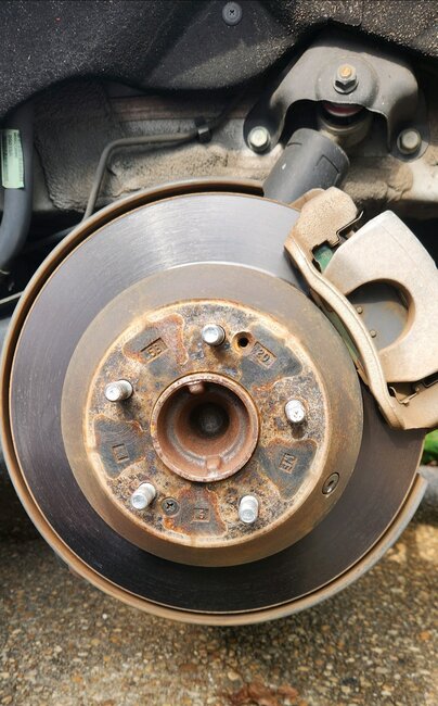

Was told by the dealership I need to do a whole rotor and brake maintenance (including brake fluid flush). I'm pretty sure I can do this maintenance. I measured the left rear rotor 10.8mm. Tried looking for the minimum stamp on the rotor but couldn't find it. What are the minimum spec for my vehicle?

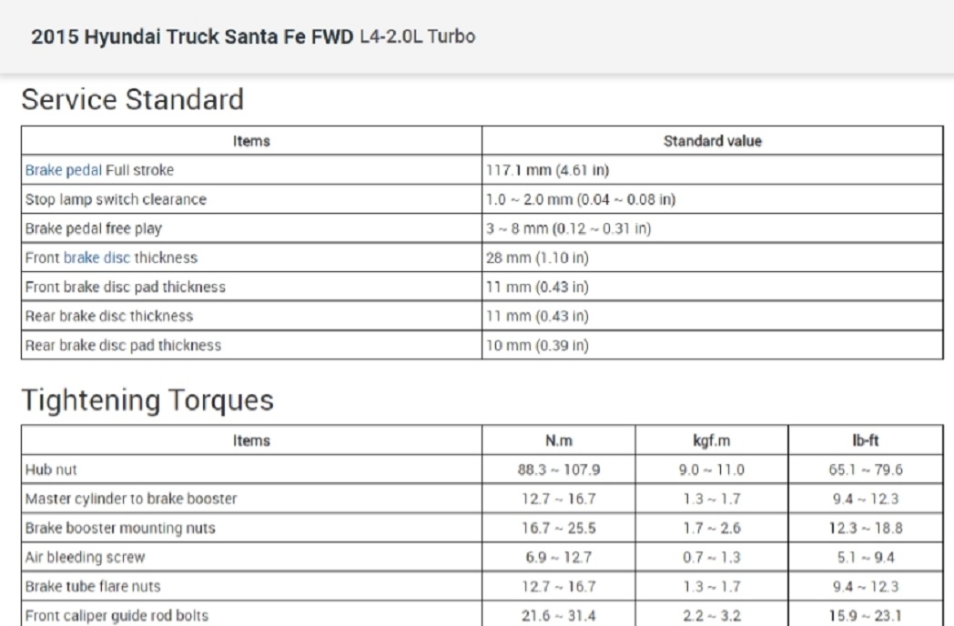

I was disappointed to see Hyundai doesn't list the machining specs for their brake rotors. They only list the original sizes. I posted their chart below. Normally there are two additional specs we look at. One is called the "machine to" spec. As long as the rotor is still thicker than that spec, the rotor can be machined to true it up during the next standard brake service. If I recall correctly, that used to be .030" thinner than the original thickness. That was for older vehicles. Today rotors are so thin to save weight that they're often worn below that value from normal use, and they must be replaced. That machine to spec is a published legal limit the rotor can be machined to. No mechanic will risk his reputation or a lawsuit by machining a rotor thinner than that limit.
The second spec is called the "discard" spec. That was .015" thinner than the machine to spec. A rotor can not be machined to this thinner spec, but after machining, it can be allowed to wear to that thickness.
