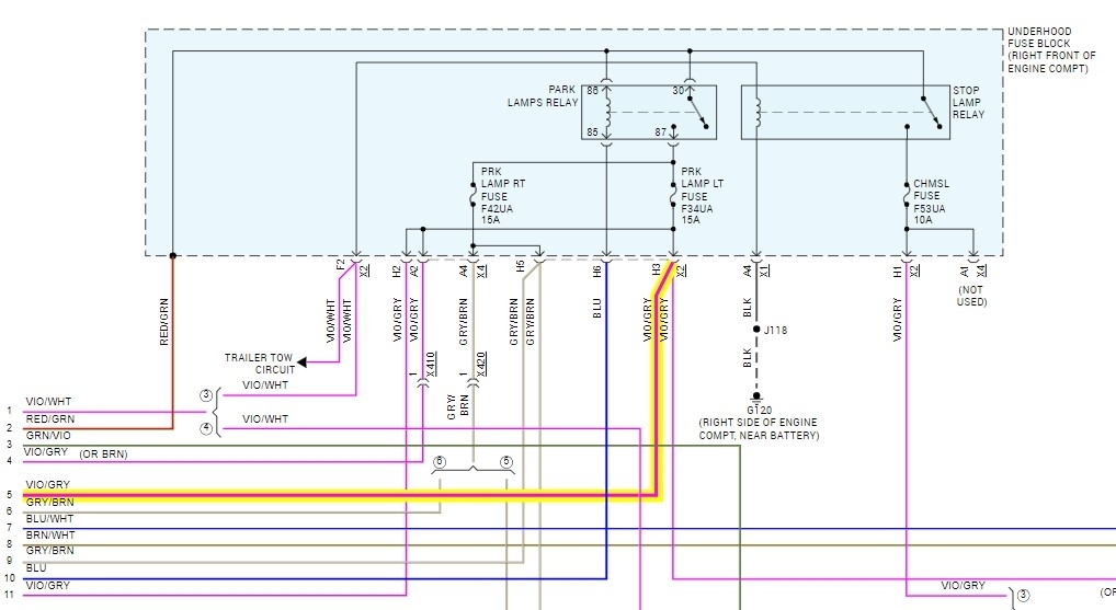

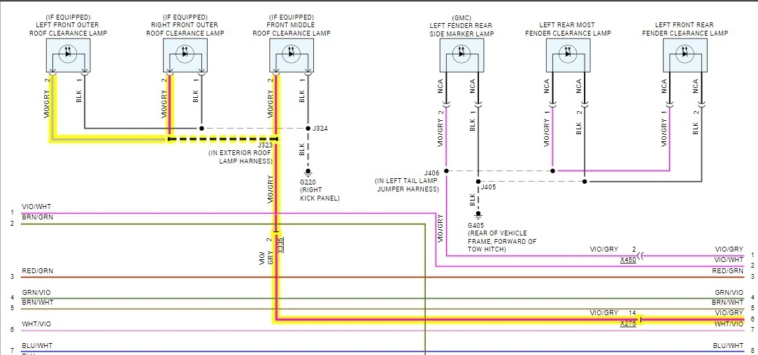

Those are all fed from the same circuits as the taillights, plate lamps, and parking lights. The BCM turns on the park lamp relay and all of them come on. The only way I could see to turn off the roof lights would probably be to find the roof harness and add a switch to the violet wire with a gray stripe.

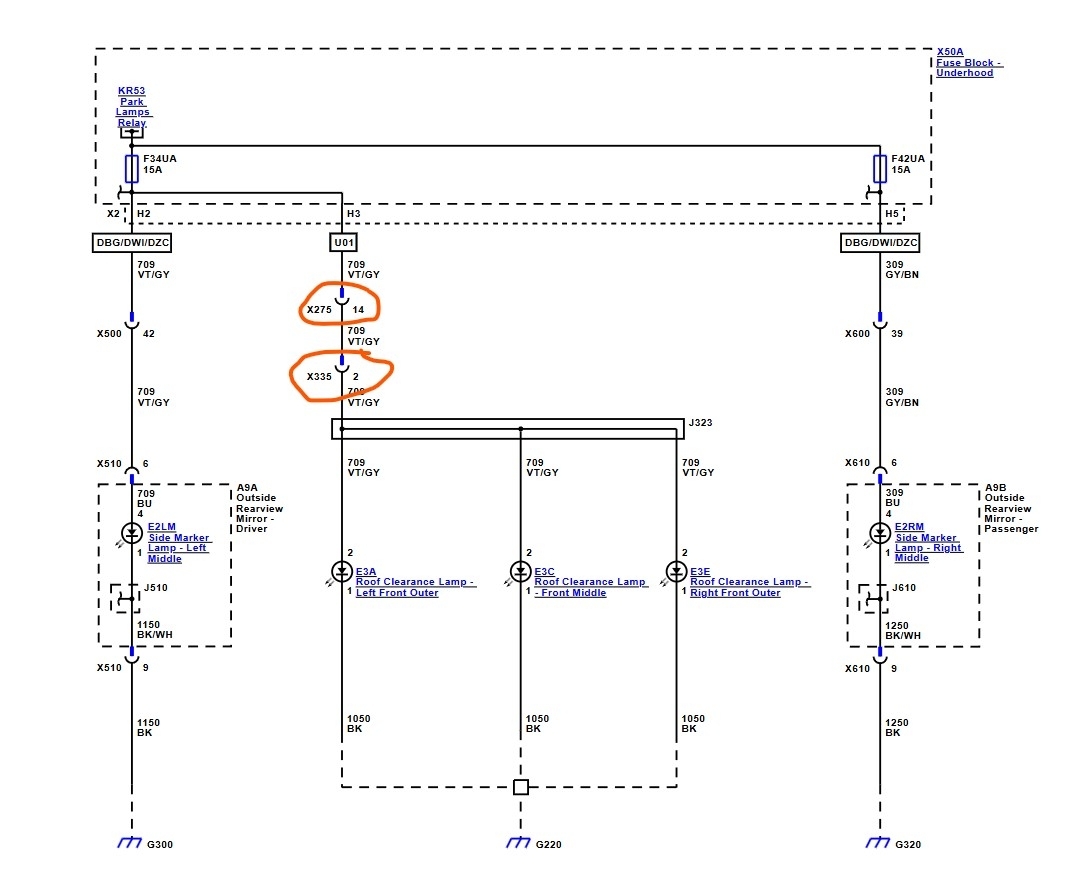

There are two connectors in the system after it leaves the front fuse carrier. One is buried in the dash the other is behind the trim on the left A pillar (drivers' side) doesn't say if it's at the top or bottom though. It is a 2-wire connector with a ground (black) and the power (violet/gray) wires in it. You could switch the ground side.
