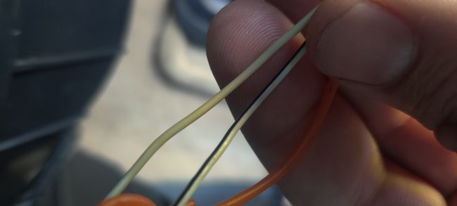

I'm reinstalling my dash after a replacement of the A/C evaporator and I cannot identify what or where this one wire belongs. Location is right side under dash. Wire colors are tan and white/black stripe. Any help is greatly appreciated since this is only thing stopping me from finishing!!

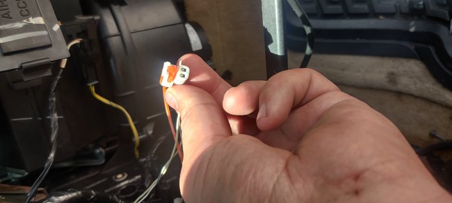

It is taped with a 7 way gray connector that plugs in below and behind the blower motor. Wires snake up to the dash harness.

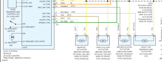

I found this for you on an air conditioning wiring diagram for you vehicle.If you look on location J and K on the HVAC control module it shows those colored wires.Hope this helps and thanks again for using 2CarPros.
