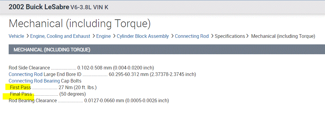

Rod and cap scored but did not 'eyeball' as oversize or warped? (cap is exact same as good caps and bearings seemed to fit the caps the same with the same crush factor etc. Hard to tell about rod with engine in)

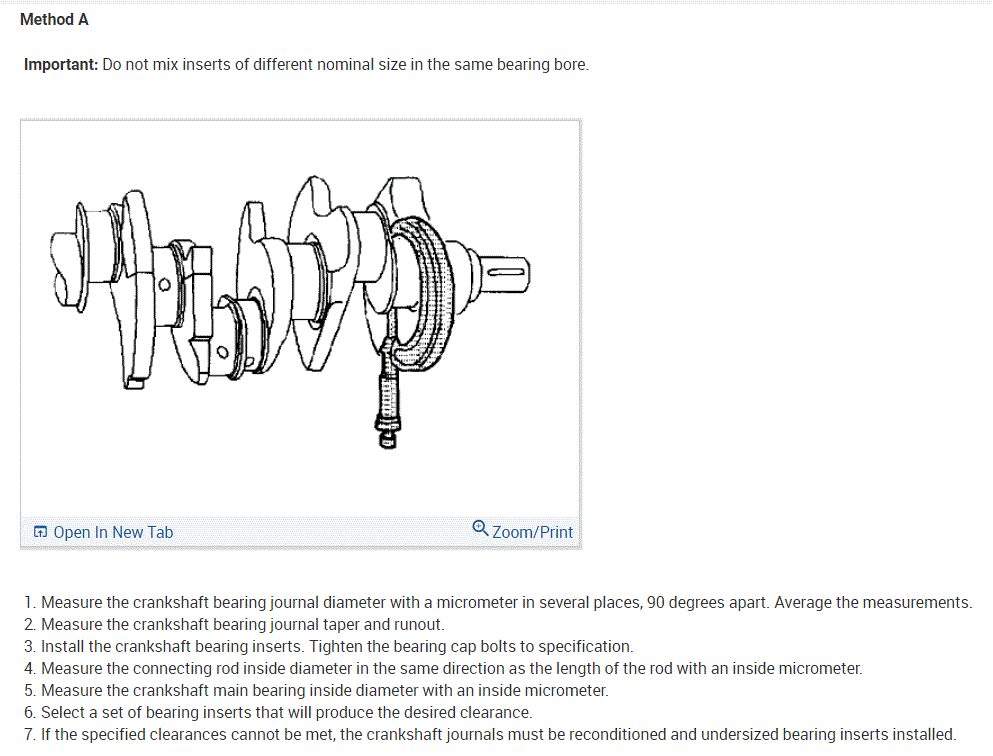

Crank rod journal was scored some but noticed that it miked exactly .030 less than the other crank rod journals?? It doesn't seem that the softer bearing condition was severe enough to eat that much into crank that quick to an exact .030 undersize??
I'm willing to risk somewhat before pulling engine and heads:
1. Assuming I can 'backyard' polish out mild crank scores, is it okay to have only one '.030' undersized rod bearing put in or is that too unbalanced etc?
2.And if okay to do, is this at all feasible or does experience tell you that the odds are too high the crank, rod and cap are warped etc.?
