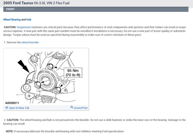

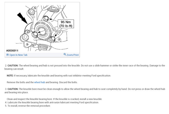

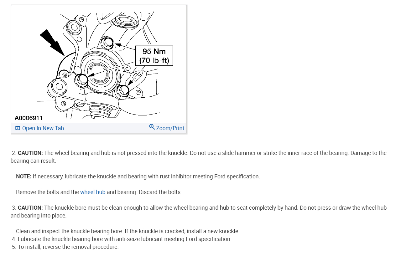

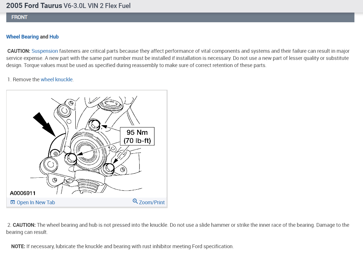

It does sound like a bearing hub is going out which is common, does it change pitch when you steering car right to left? If so, this is a clear indication the bearing hubs are bad. Here is how you can change them out in the images below. Also, I found a video for you.
https://youtu.be/x_qTpbkWXQA
Here is the part on Amazon both for $86.00:
https://amzn.to/3Bcn2eO
