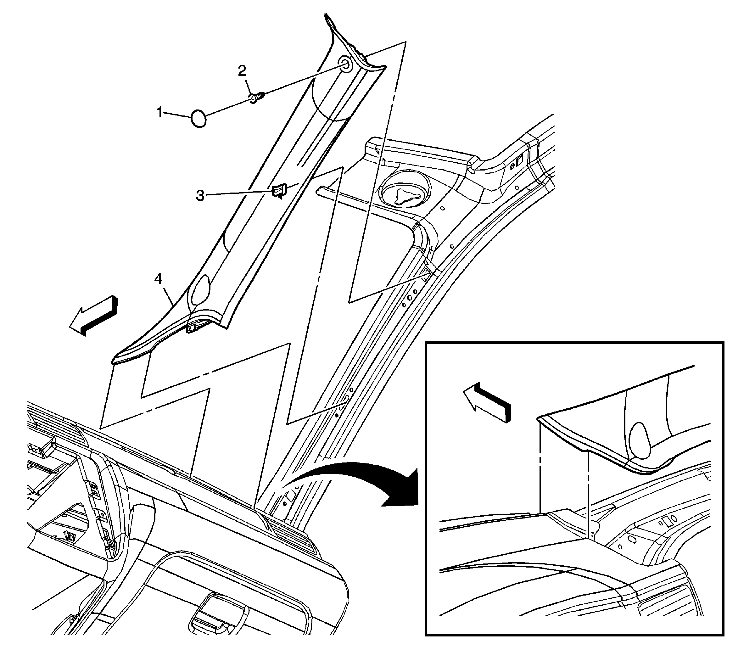

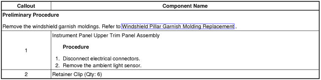

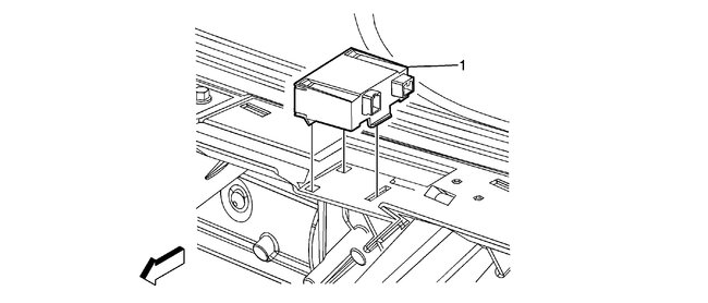

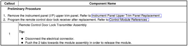

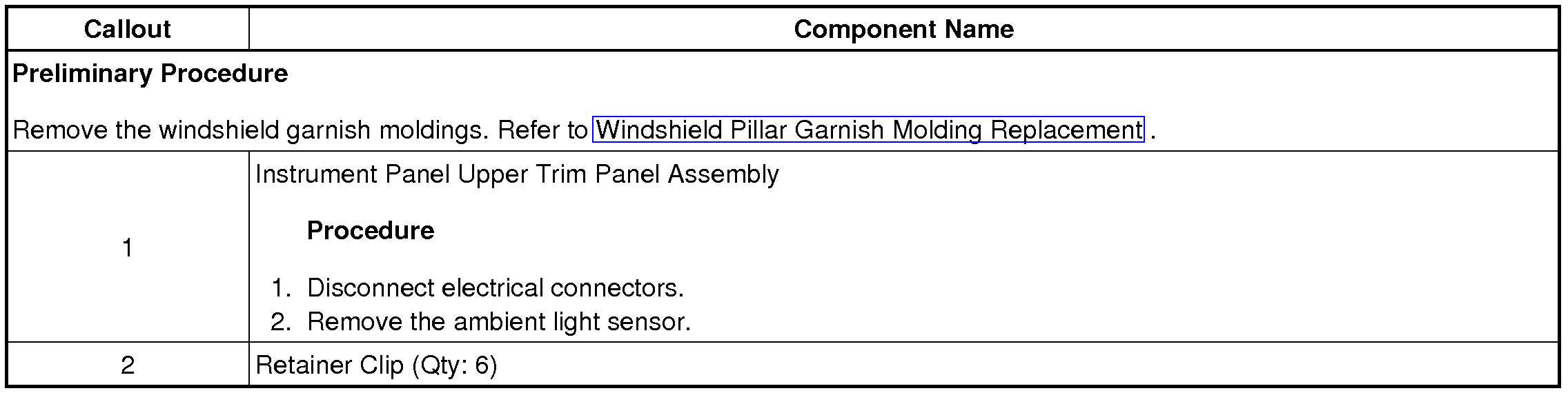

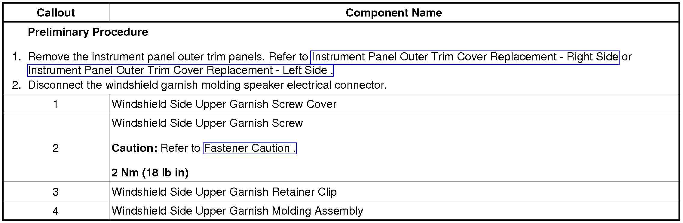

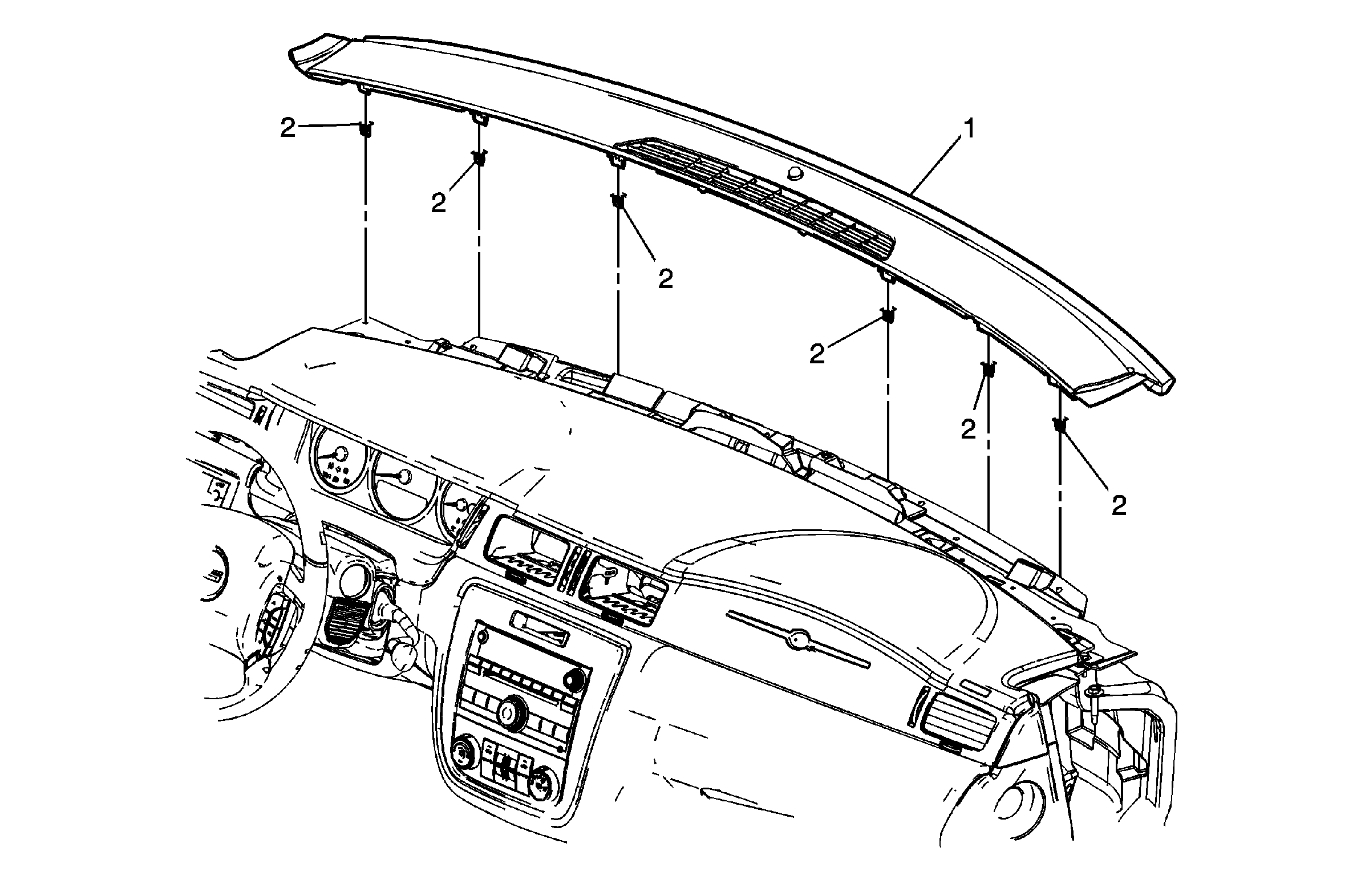

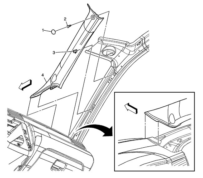

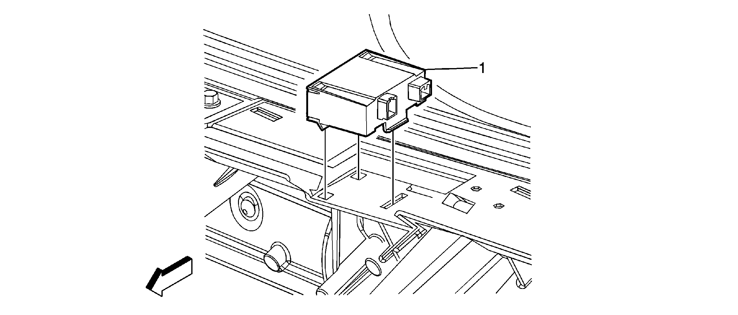

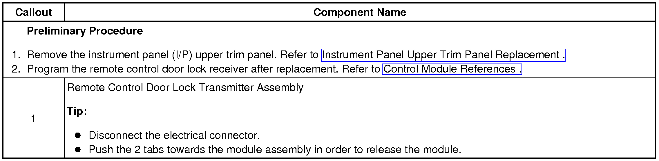

It is under the upper trim panel of the instrument panel. Here are the directions for panel removal. First you need to remove the pillar trim. See pictures 1 and 2. Next, you can remove the upper trim panel. See pics 3 and 4. Next you can access the module. See pics 5 and 6.
Let me know if this is what you needed.
