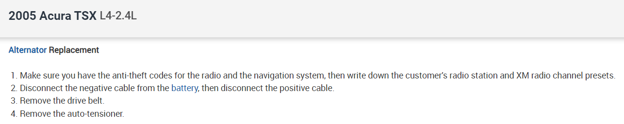

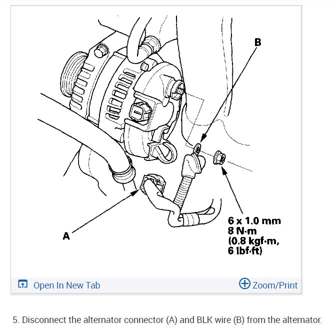

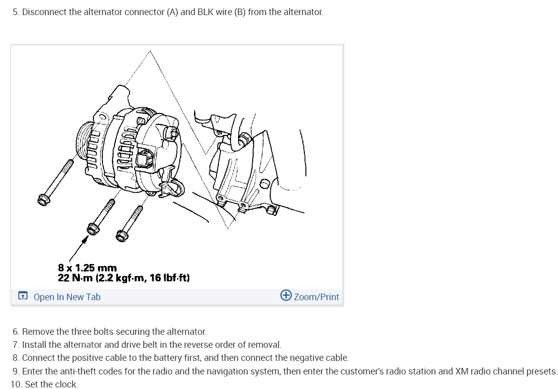

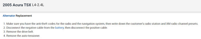

Here is a guide to help you:
and
Here is how to change the alternator in case you need it or what to see what needs to be done. Check out the images (below). Let us know how it goes.
