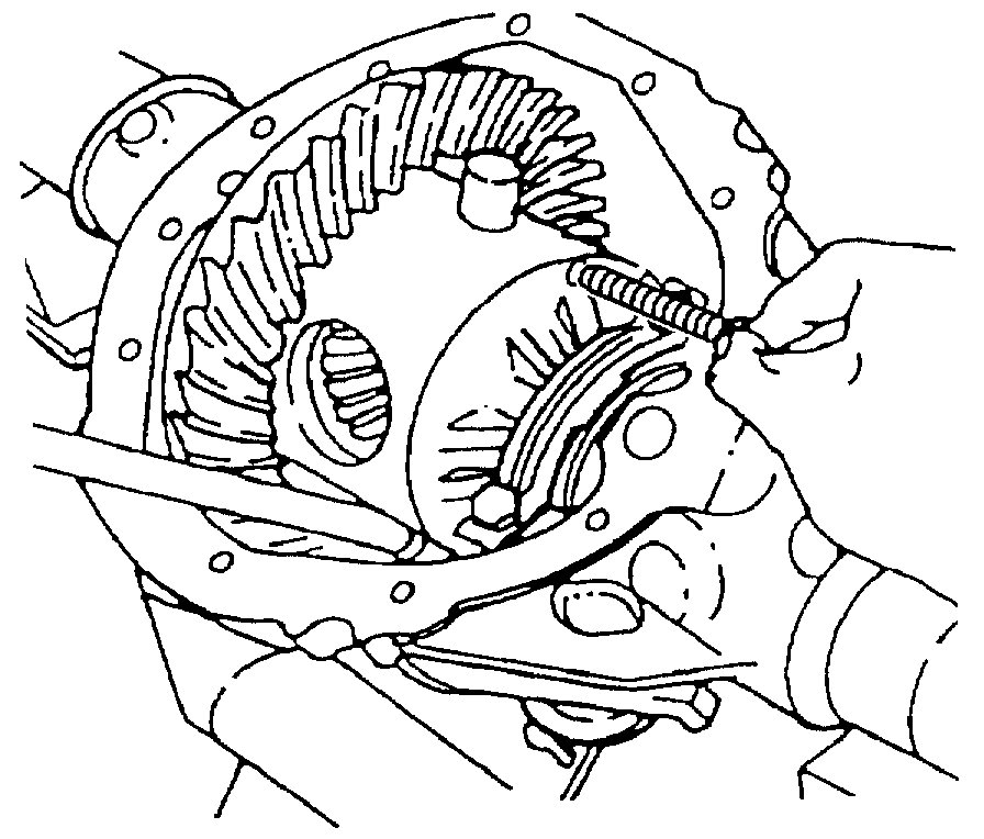

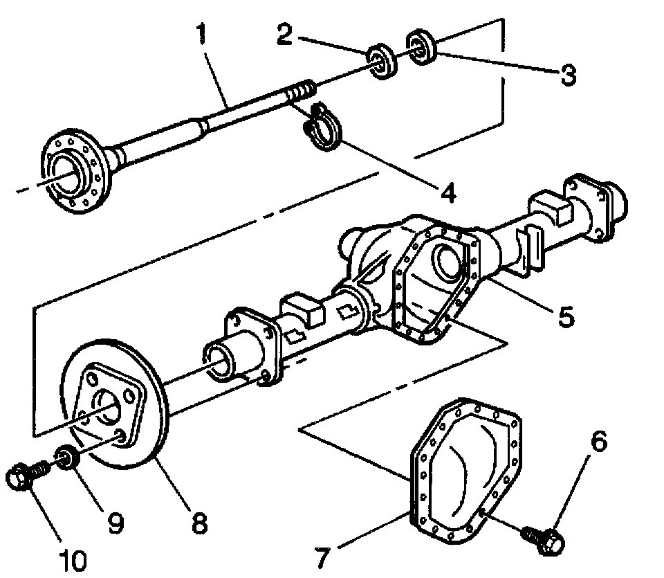

There are a few variables with this. First, if the differential is an 8.6" or 9.5", there is a locking device that keeps the pinion shaft from coming out on the ones with a locking differential. I have a feeling that is what is stopping you. Here are the directions related to the differentials I mentioned. Note: The directions discuss both the locking and non locking types. The attached pictures correlate with these directions.
REAR AXLE SHAFT
Removal Procedure
See Picture 1
1. Raise and support the vehicle on a hoist. Refer to Vehicle Lifting.
2. Remove the tire and wheel assembly. Refer to Tire and Wheel Removal and Installation in Wheels, Tires and Alignment.
3. Remove the brake caliper. Refer to Brake Caliper Replacement - Rear in Disc Brakes.
4. Remove the rear cover and the gasket. Refer to Rear Cover and Gasket Replacement

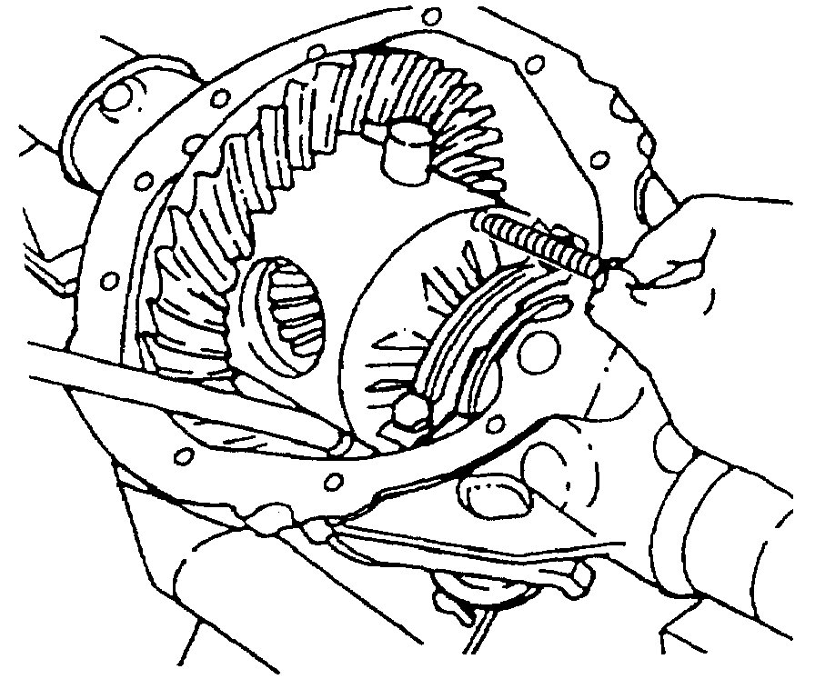

5. Remove the pinion shaft locking screw.

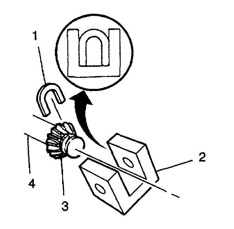

See Picture 2
6. On axles without a locking differential, remove the pinion shaft.

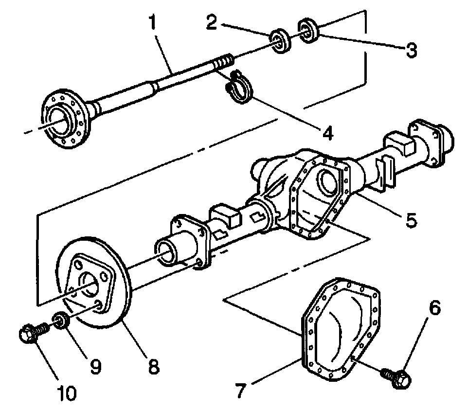

See Picture 3
7. On axles with a locking differential, remove the shaft part way. Rotate the case until the pinion shaft touches the housing.

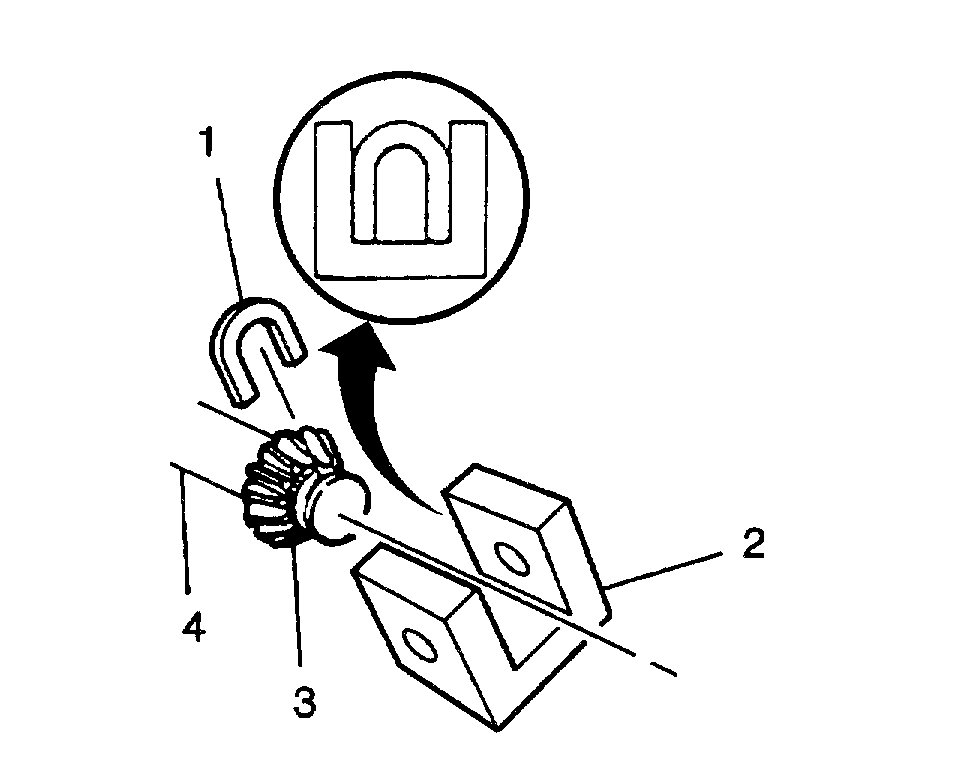

See Picture 4
8. On axles with a locking differential, use a screwdriver, or a similar tool, in order to enter the differential case and rotate the lock (1) until the lock aligns with the thrust block (2).

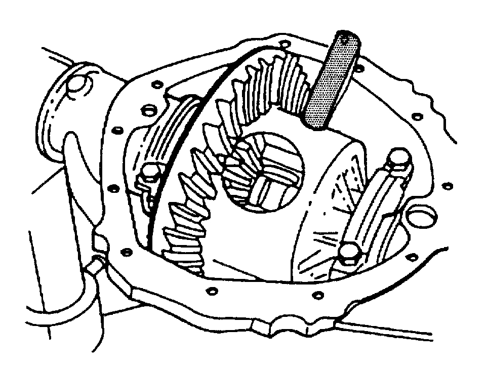

See Picture 5
9. Push the flange of the axle shaft (1) toward the differential.
10. Remove the lock (4) from the button end of the axle shaft (1).
Important: When removing the axle shaft, do not rotate the shaft. Rotating the shaft will misaligned the gears. Misaligning the gears will make the assembly difficult.
11. Remove the axle shaft (1) from the housing (5).
12. Inspect all the parts for damage. Replace the parts as necessary.

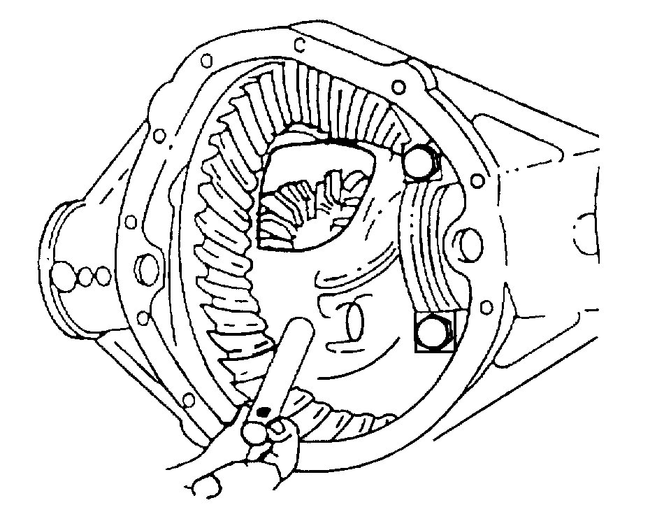

Installation Procedure
Important: Carefully insert the axle shaft in order to not damage the seal.
See Picture 6
1. Install the axle shaft (1) into the housing (5).
2. Slide the axle shaft (1) into place allowing the splines to engage the differential side gear.
3. On axles without a locking differential, place the lock (4) on the button end of the axle shaft (1).
4. On axles with a locking differential, keep the pinion shaft partially withdrawn.
